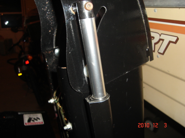

I put UHMW on the back of the chute/deflector yesterday too. Looking forward to seeing how that works. The linear actuator for the deflector made out well in its first event, tonight I also get to check out the real world effectiveness of the light bar on the front and 2 LED work lights on the back.

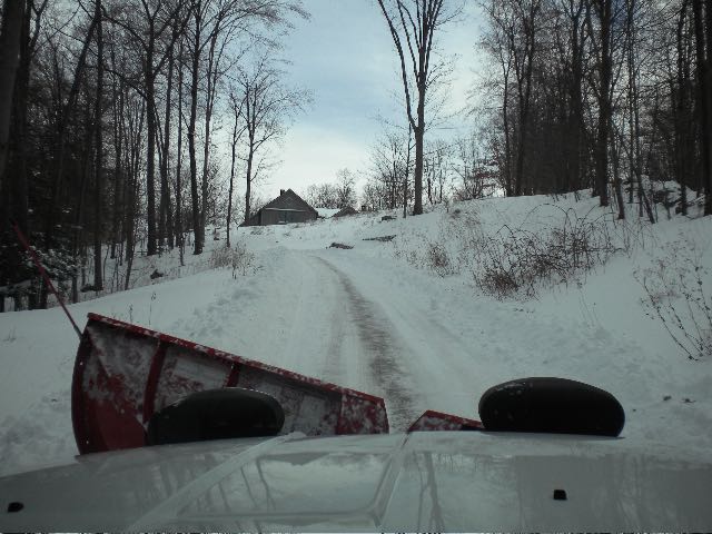

Well, here I go again, drooling over a cab... I have a great place to park my tractor, but it just doesn't allow for a top of any kind... Guess I'll just continue drooling!
Nice lights! Another justification for the cab, I'm thinking...:roll eyes: When blowing, they really do need to be up fairly high to be effective.
As far as the paint, I know it'll wear off eventually, but it sure works well for now!

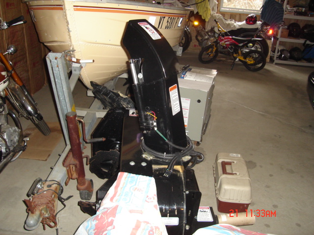

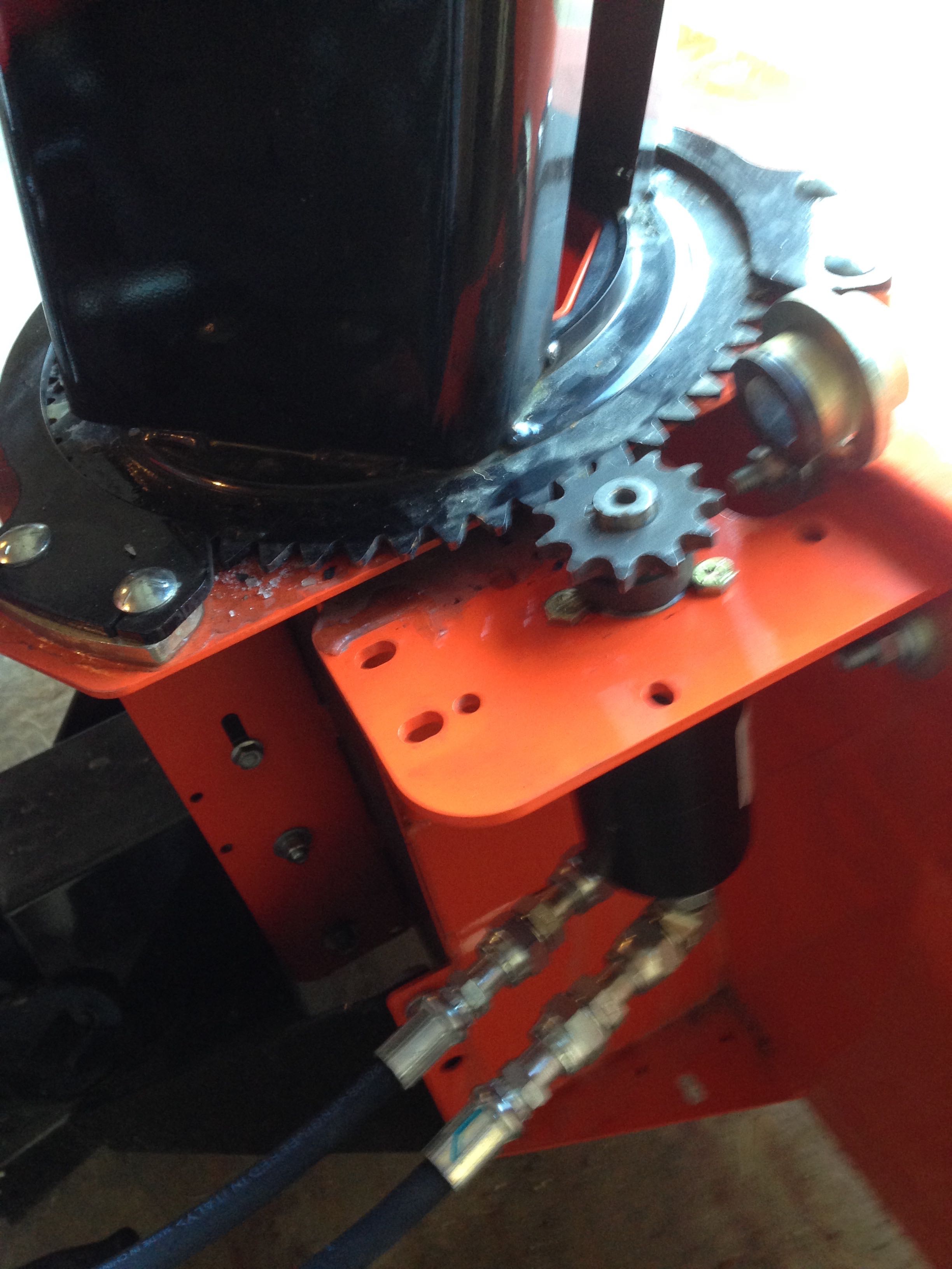

Loving my remote chute deflector too. This was before I oiled the hinge so it's a little jerky. Pretty smooth now.

When I bought my TLB (plus blower) back in 2007, the dealer only sold blowers with the factory electric chute controls mounted. Never regretted it! Not real fast, but definitely nice to have. OEM deflector is similar to your set-up but mounted on the side. (Bet yours works better and cost less!!)

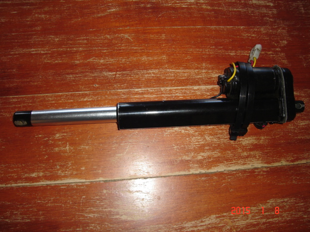

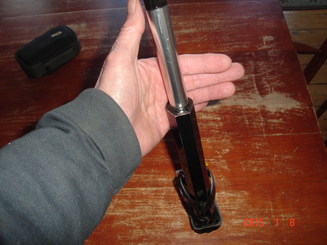

I thought about side mounting, but like the symmetrical aspect of being in the center.
I used a 2" travel actuator and ramped up the geometry to make it faster. If I had used a 4" one it would take twice as long. Speed is just about right.

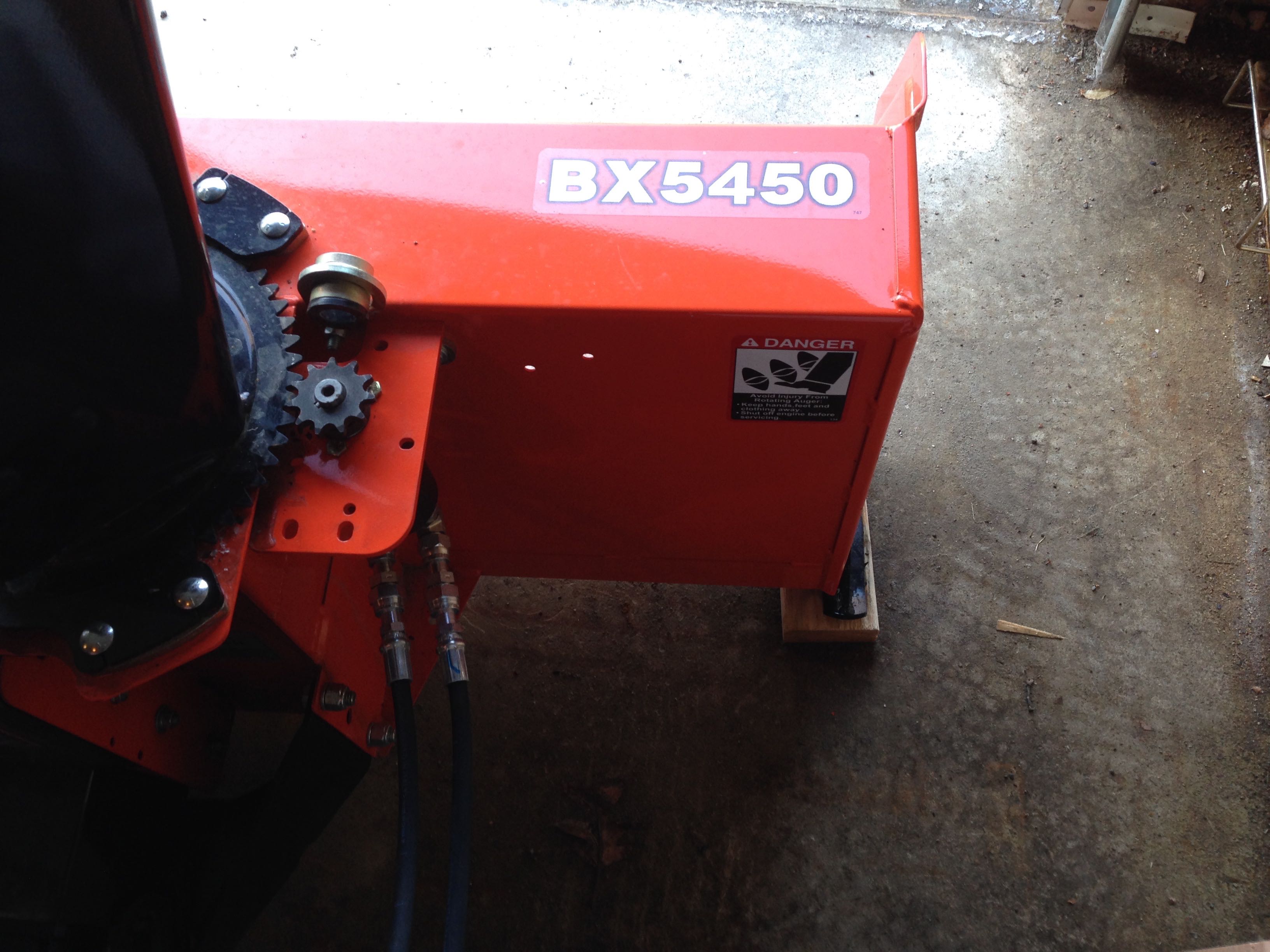

=timbrehse;3959435] While the subframes and mid PTO shafts may differ,
this is for anyone who has any remaining doubts about the interchangability of Red, Blue, Orange quick hitch
From the Orange online build a tractor pricing, Kubota has discontinued the two current models of snow blowers (BX2750=MF2360) and the newest offering, which is to become available November 1st is the BX5450. priced at $1999.
The NEW BX5450 blower comes with a standard manual crank chute rotator, upgraded outer shoes on the edges of the blower along with heavier steel material for building the snowblower housing as well as the overall body of the snowblower is a bit beefier.
they also are offering a wider 55 inch blower the BX5455HD. this comes with standard hydraulic chute rotator and heavier gauge construction like the BX5450.
Blue's 50CS is the updated vs. as well (skid shoes on the outside)
I guess this means Massey has decided to wait 'till next yr to update?

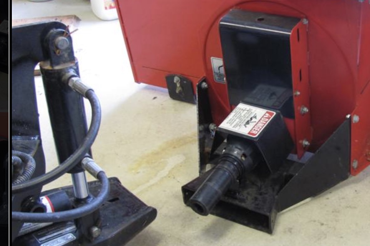

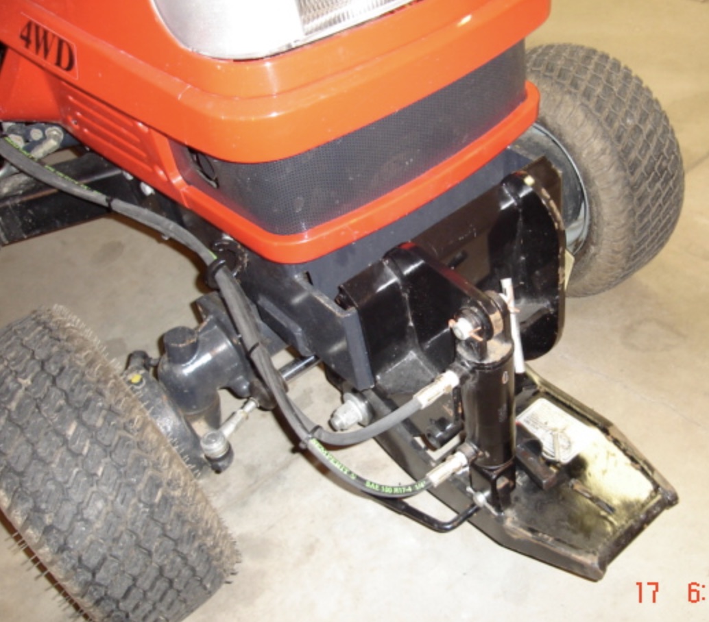

Sorry Langanbob - I haven't checked this forum in a while.
The mount is referred to as the Quick-Hitch subframe. It has a lift cylinder, hoses and a mid PTO shaft.
Looks like this:Q-Hitch.jpg
Front implements, Snow blower, Rotary Broom, Blade all have a female receiver:
I got the sub frame, minus the mid PTO Shaft, when I bought my MF 2330 Rotary Broom
The Mid PTO Shaft was a bit difficult to locate at the time. (I was able to order it from Jack's Small Engines)
The same Canadian company makes the Subframe, Snow Blowers, and Rotary Brooms for Red, Orange, and Blue tractors.
The Red Massey Blower is MF2360 (older design)
The Orange is BX5450 (new design)
and The Blue is 50CS (new design)
All are 50" snow blowers and are interchangeable tho I've been told there is a slight difference in Mid PTO rpm's and so the gearing of the chain driven augers are slightly different.
While that may very well be true, my Orange Blower mounted on my Red tractor does a fine job now in it's 3rd year.

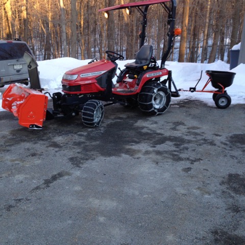

Here's a little Orange on Red action
/ Orange on Red #93
Hey, timbrehse, that's my tractor! (Nice pic, huh!) Thought I recognized those paint chips on the sub-frame....
BTW, I get a "This video is unavailable" message when I click on your videos above.
Ha! IJ, Those pics were very useful for illustration purposes ... so thanks!
BTW - I fixed the videos
Since you own a Massey vs. of the blower, I'd be interested in what you think of the throw of my Orange by comparison
I keep thinking of a post by Jaylegger a while back about having to change the BX5450's impeller gearing to
better match-up w/the Massey Mid PTO which cranks@ 2000rpm while the Kubota's is @2500rpm
Tho as is, it doesn't seem to be laboring even in deeper snow ... and I really don't need to send the snow into the next county.....
