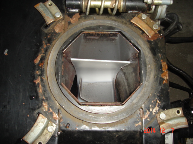

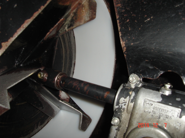

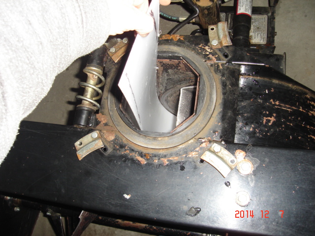

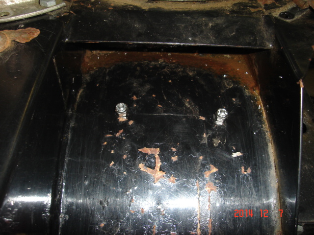

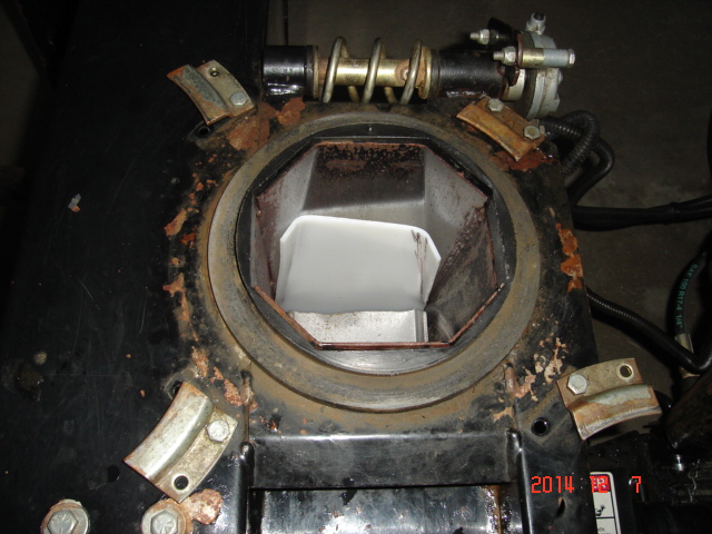

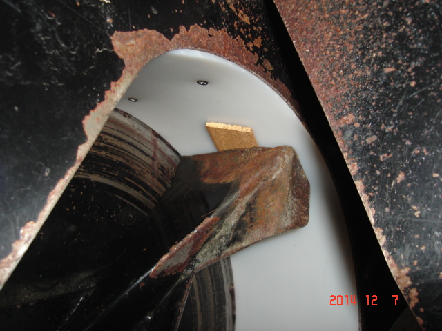

1. First thing I tried was the impeller housing. I was able to slide a piece of UHMW poly (48" x 5-1/2") down into the outlet hole with the chute removed, around the inner surface under the blades, and secured it with a couple countersunk 8-32 stainless screws into threaded holes in the housing's steel at the "top." I didn't trust the short length of the threads, however, so I added nylon stop nuts onto the outside. Then used wooden wedges to hold it tightly against the inner surface and added two more screws/nuts at the outlet, after heating & bending the poly to (sort of) match the outlet contour.

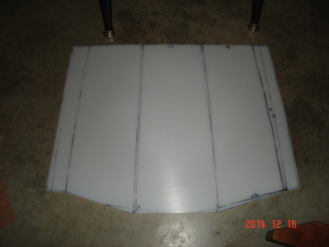

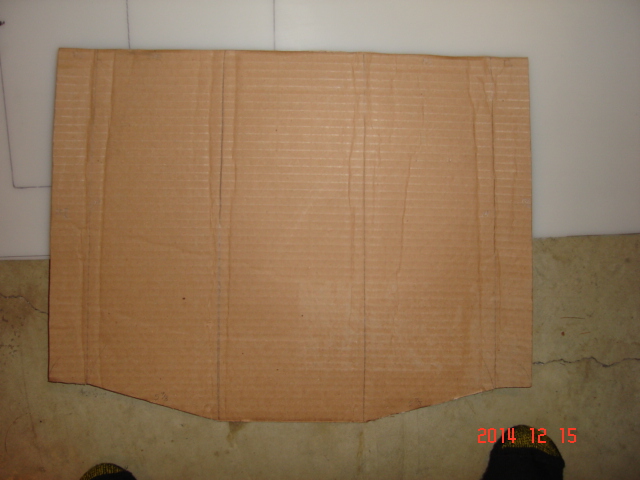

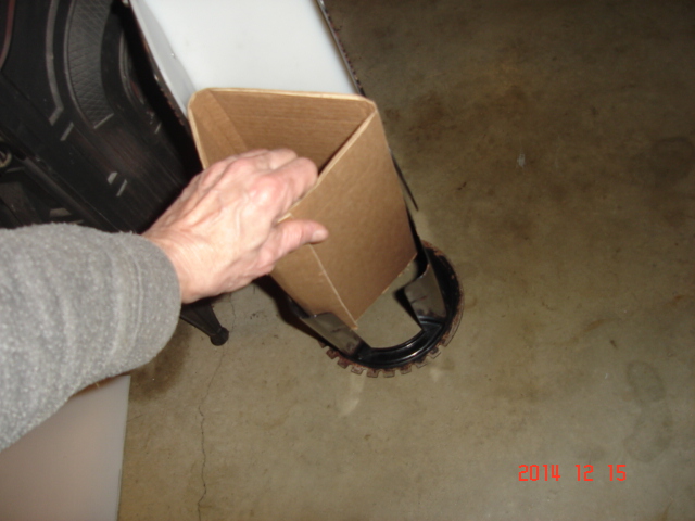

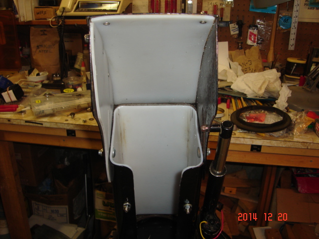

2. Next, I made some patterns and did the chute deflector, though the way mine's made I only had clearance to add the poly to the back surface and one side only. I also added more screws along the back (curved) edge of that side piece, as I found that grit & ice was getting jammed in there behind it, forcing it to bow outward. Not any more.

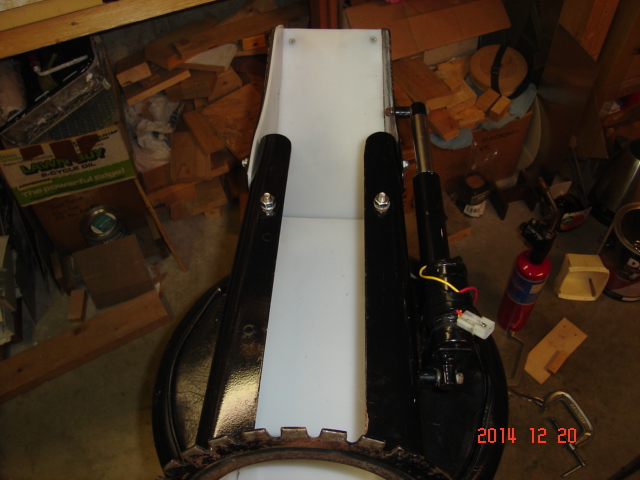

3. Now, I'm working on the one-piece bent section for the chute itself. Have a pattern made and the poly cut; just have to figure how to heat and bend it accurately.

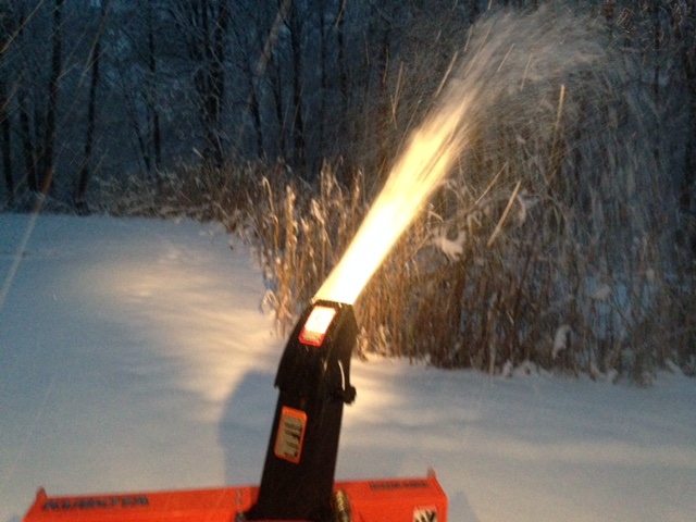

It works GREAT!! :cool2::cool2: I was able to throw wet, heavy snow as far as I could throw dry snow when the blower was new, even with only the impeller housing and deflector lined! I feel the impeller housing made the biggest difference, but lining the chute should also help.
So: not only have I reduced the gap between the impeller blades & the housing, but I've made the whole thing slipperier and protected the steel. Win-Win. :thumbsup: I would highly recommend lining that housing to anyone; it made a huge difference and was actually, in my case, very easy to do! Even with the rain, sleet and freezing rain we had on TOP of 10" of wet snow, I had only ONE clog, and that was pretty much my fault for trying to clean up slush with no snow in it.
Here's some pics of the impeller housing's lining: (Sorry, they're not in the right order)

I think I have that covered, Bumper; there is still around 1/8" of "free space" here & there, between the poly and the inner surface of the housing around the circumference. Should allow room for the poly to flex.
When it's at rest and cold, one blade just touches it in one spot, not enough to feel any drag on the impeller, just enough to hear a soft scrape.
If it gets longer as it heats up, it should only take up the slack and press itself more firmly to the inner surface -- at least, that's my theory and I'm sticking to it!:laughing:

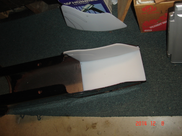

Here are some shots of the deflector and the pattern (so far) for the chute piece:

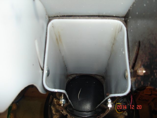

IT'S DONE!! :cool2: :D

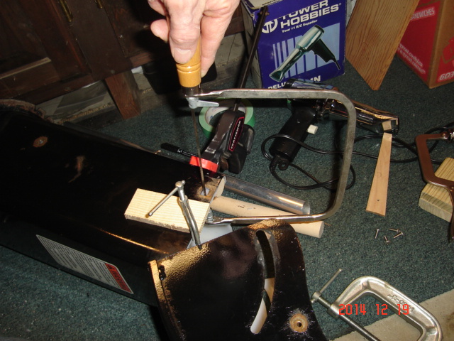

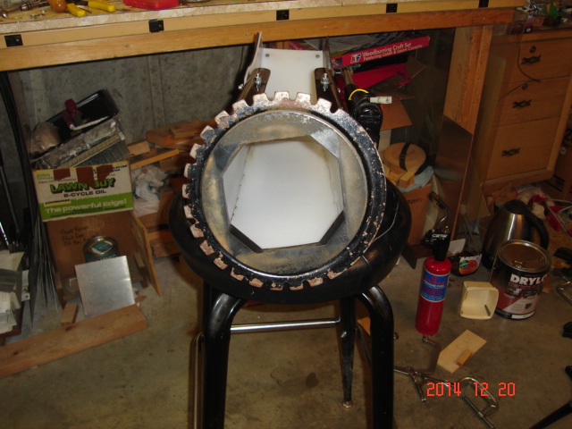

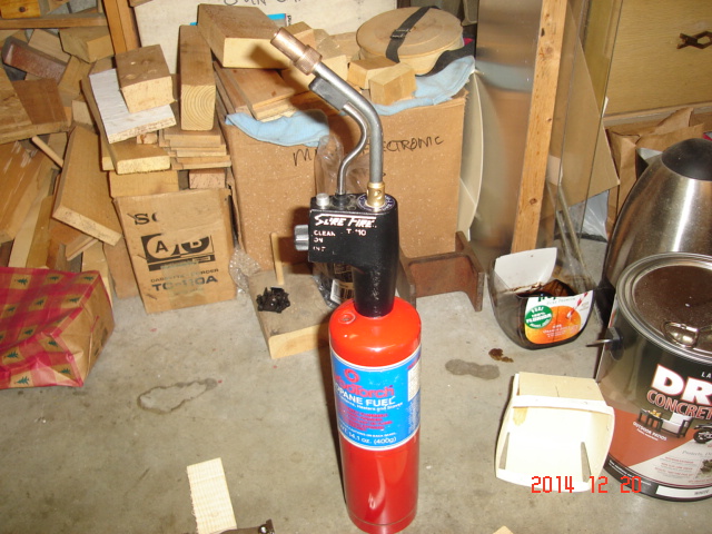

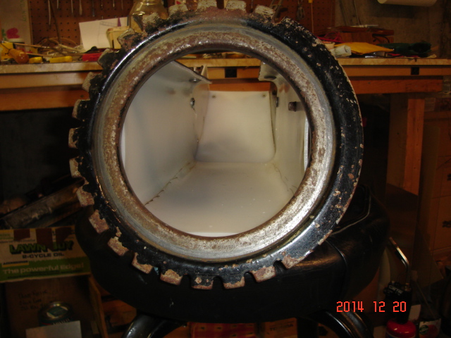

Finally finished the chute liner; it was, probably due to my own ineptness, a lot harder to get to fit well than I had thought -- but it did work. And Bumper was right on: after forming, it can be "folded" somewhat to fit it in from the top, the same way I did with the cardboard pattern above.
A few things I learned on the way:

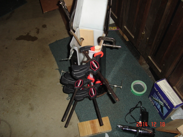

1) A Sure-Fire trigger-operated propane torch worked well to quickly heat up the poly, then could safely be put aside (only runs while trigger is pulled). MUCH faster than a heat gun; common sense was successfully used to avoid overheating. :thumbsup:
2) The best thing to make small cuts in this material is a coping saw-- much better/quicker/easier/cleaner than a jig saw for cutting the poly, assuming you can rotate the bow out of the way if necessary. Edges are easily smoothed out/trimmed with a razor afterward. I admit I did use a band saw for initial long cuts, however.
3) Have LOTS of clamps available!
4) As the inside corners (of my blower's chute, anyway) are 5/8" radius, a 1" x 12" wooden dowel formed (squished) the material into the corners beautifully after heating up the poly. I used some Sears quick-clamps for that purpose.
So now all I have to do is wait for some snow (not rain, etc.) to see how it works. I was a bit concerned about overhang of the poly at the bottom (entrance) of the chute (pic 3), but then realized that octagonal plastic swiveling ring (UHMWPE ?) in the base covers that up anyway (pic 8), so no worries.

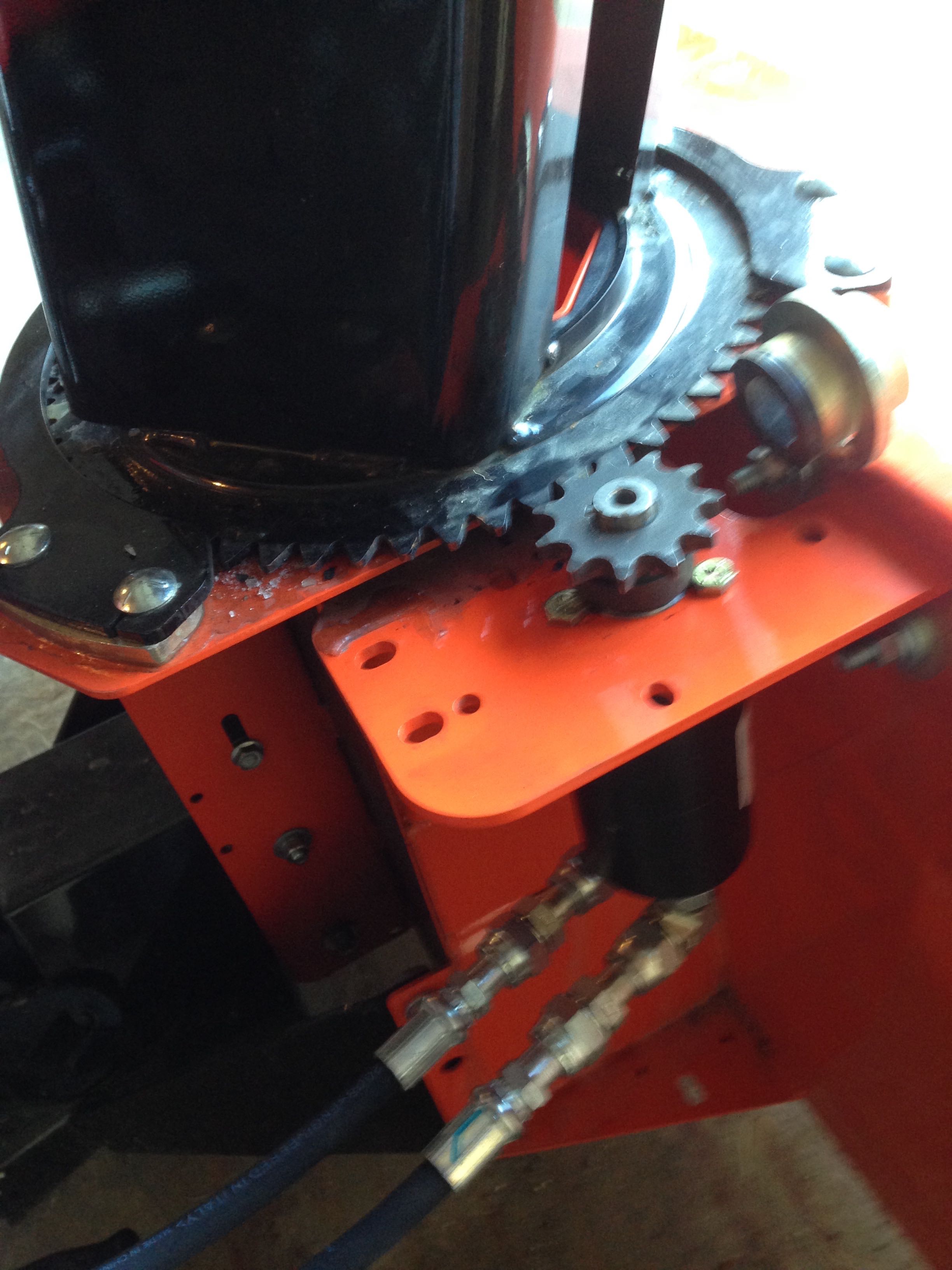

Just to follow up: a while back, I a bought hydraulic rotation kit for a Cub Cadet/Yanmar blower
I used only the motor, hoses (w/needle valve flow restricters ),and the motor gear.
All I had to change was the hose ends from Male to Female for my FEL control
The motor bolted perfectly to my Kubota BX5450 - works like a charm.

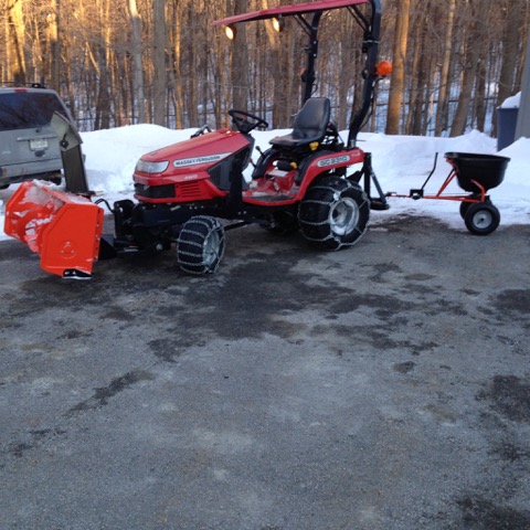

While it's not as warm as my former plow truck, it does a way better job..... and no more stacking.

OK, I'll bite… where'd you pick up that cute little sand spreader and who makes it? Lugging bags of sand a spreading by hand is getting to be a bit old. Though I don't have to do it quite so much with my recently paved driveway, it's been an icy beginning to the winter this year.
