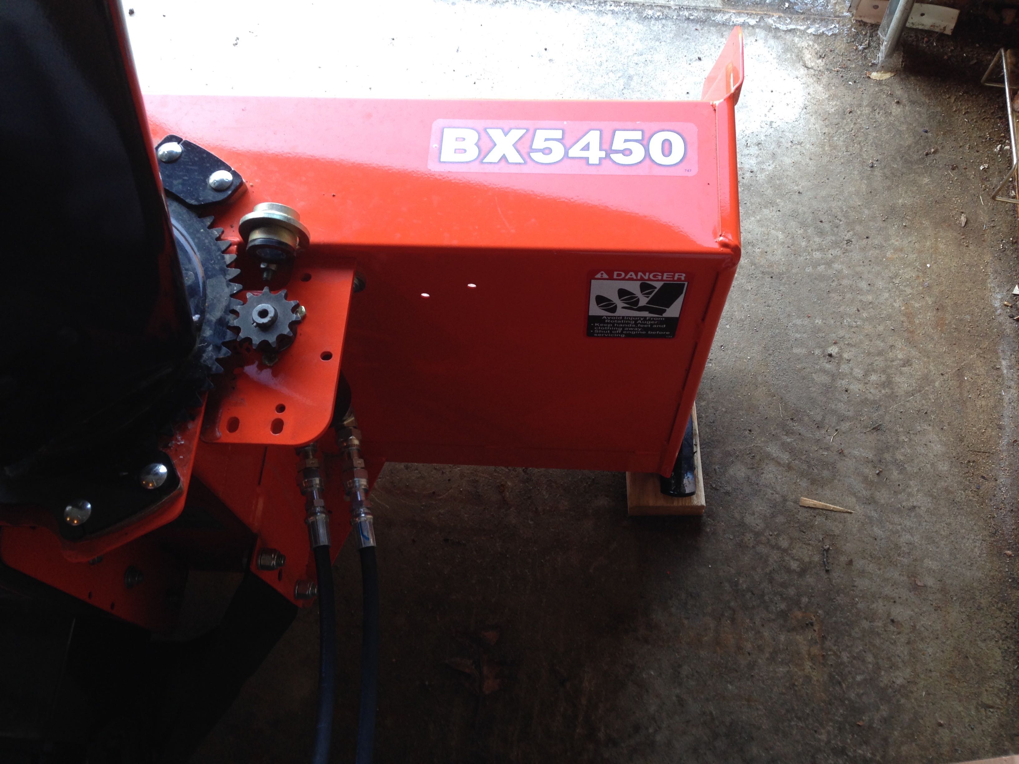

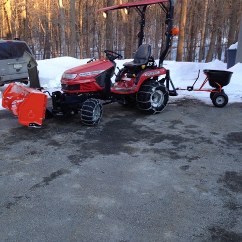

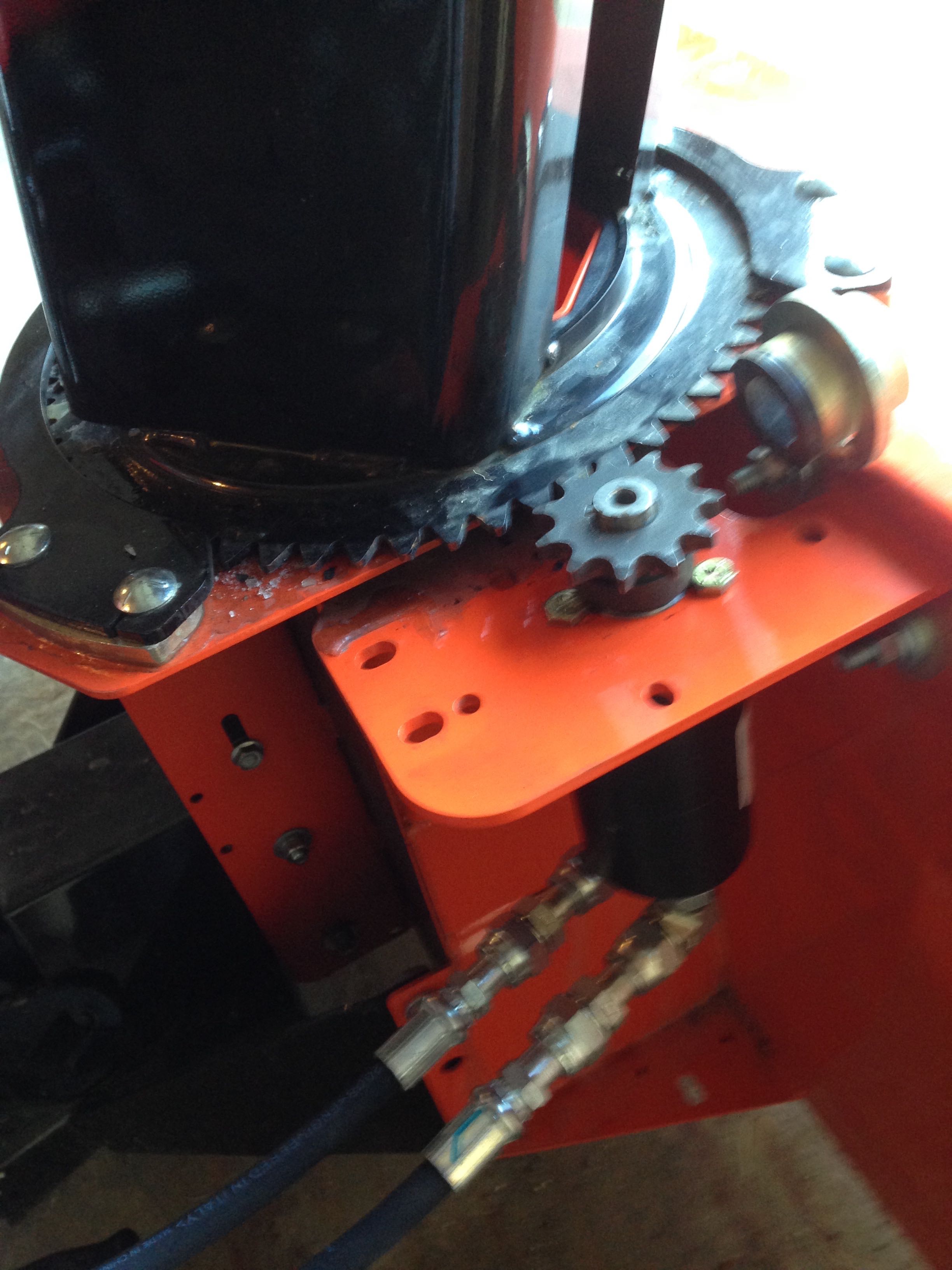

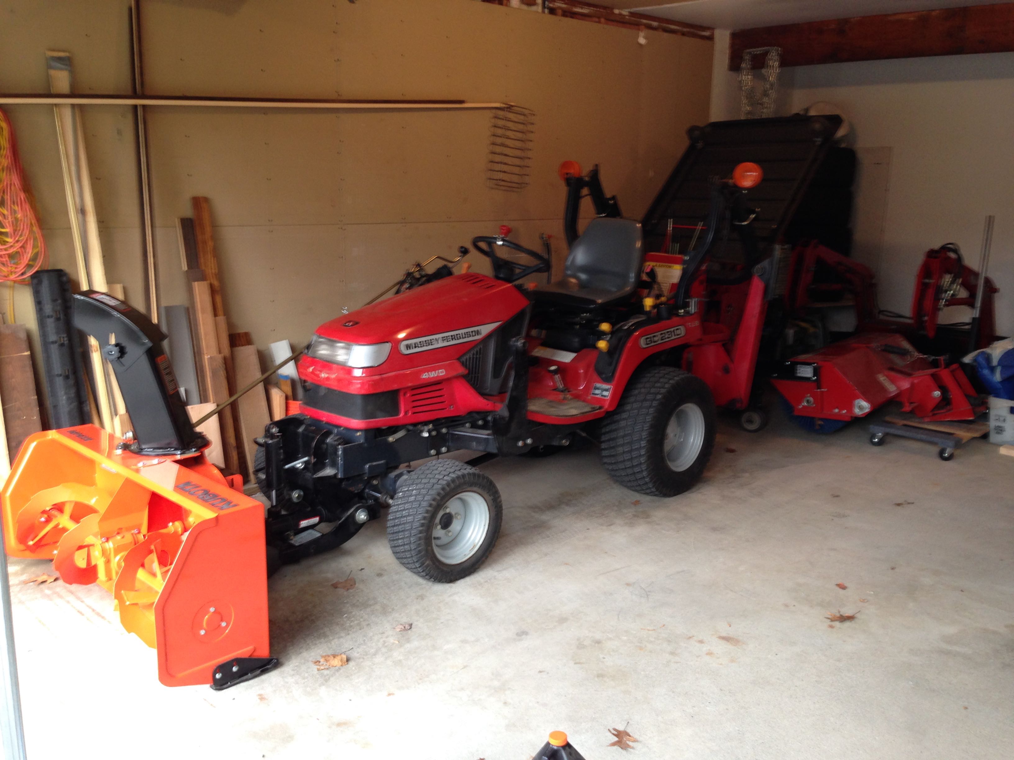

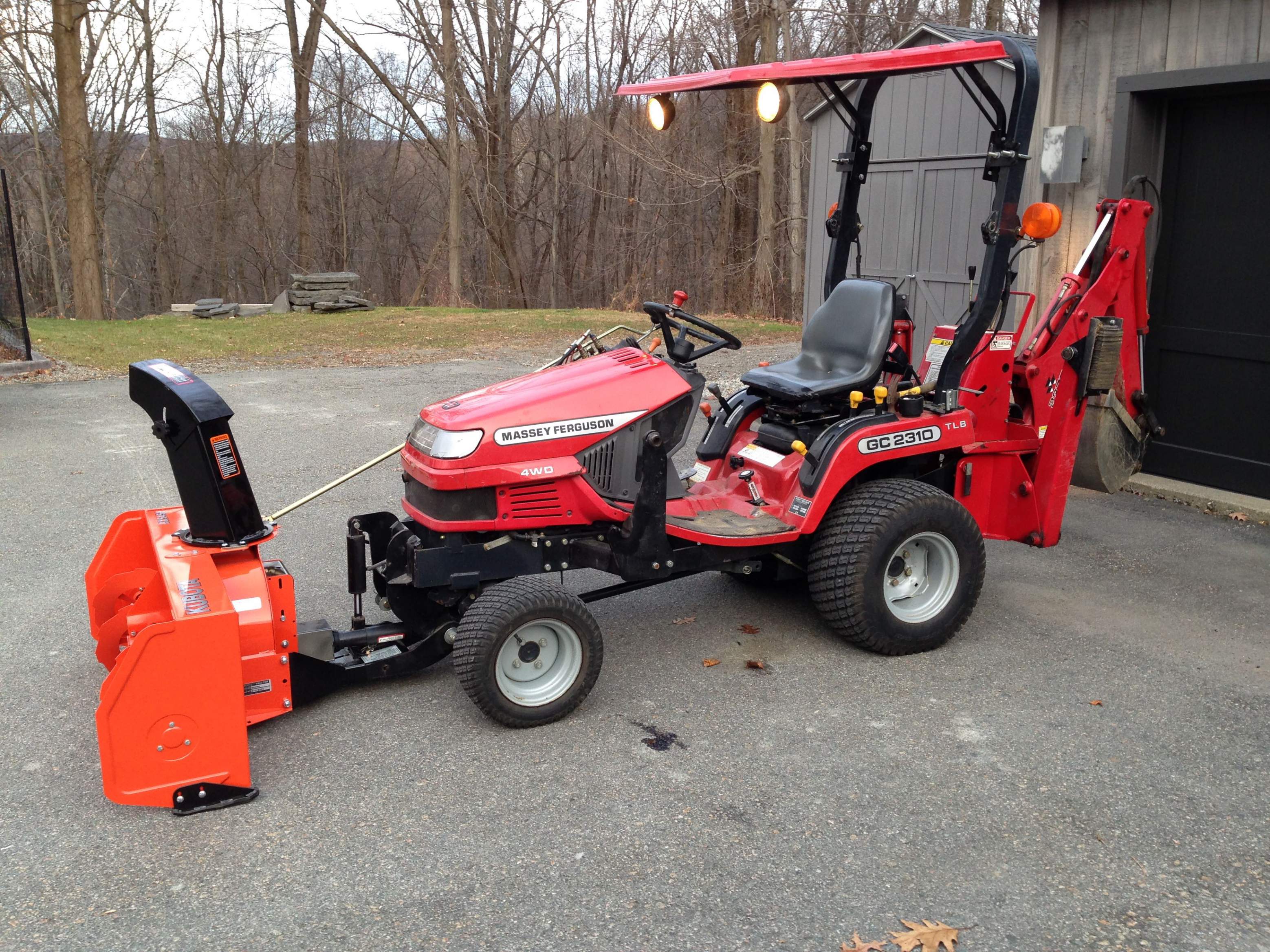

Just to follow up: a while back, I a bought hydraulic rotation kit for a Cub Cadet/Yanmar blower
I used only the motor, hoses (w/needle valve flow restricters ),and the motor gear.
All I had to change was the hose ends from Male to Female for my FEL control
The motor bolted perfectly to my Kubota BX5450 - works like a charm.
While it's not as warm as my former plow truck, it does a way better job..... and no more stacking.
View attachment 413953 View attachment 413955 View attachment 413954

OK, I'll bite where'd you pick up that cute little sand spreader and who makes it? Lugging bags of sand a spreading by hand is getting to be a bit old. Though I don't have to do it quite so much with my recently paved driveway, it's been an icy beginning to the winter this year.
Nice job on the hydraulic motor!
Thanks Irvingj,
The Hydraulic setup is great - total was near $200. all in but I have all the unused kit parts on eBay so maybe I'll get a few coins back.
The spreader is an Agi-fab
Agri-Fab SmartSpreader 130 LB Tow Behind Broadcast Spreader | Agri-Fab 45-0463 was the best price I could find.
Works well but I have yet to fabricate a handle extension that I can reach from the seat so I do end up w/ a small pile or 2 when I stop. I have a 3pt receiver hitch & took the ball off one of my mounts - spreader has a typical lawn tractor pin.
I have a steep, paved drive - not using sand. I throw a 40lb bag of whatever snow melt Home Depot has on any given day.
Some is blue, some purple, sometimes the have only brownish salt. If it doesn't feed well I can shake the 3pt up & dwn & get it going.
The blower works so well - scrapes down so nicely - my driveway is bone dry after an hr or 2.
I see people on my (dirt ) road having to park at the bottom of their plowed driveways cause they're ice rinks.
I'm obviously quite pleased w/ my rig - and oh
While I have gear to stay nice & warm & dry this is a better, lighter 'foul weather cab' - 'cause when that wind shifts....

Also Tim, the small brass round item mounted near the new chute bracket, what is that?
Hey Pixguy- The brass piece you refer to is the forward mount for the manual rotation worm gear.
I'd left it on incase I ever had a problem w/ the hydraulic setup. Make for a quick switch back (Lord forbid!!) to the manual crank handle.
I also wasn't sure how well the motor gear/chute sprocket would hold up. My alt. plan then was to reattach the worm gear, fab a horizontal motor mount & connect the worm gear shaft & the motor shaft via a lovejoy coupler. Can't take credit for the design, I'd seen someone, I believe on this site, post their pics. Thankfully my present setup seems to be holding up well so far. We've had 5 or 6 snowfalls and there doesn't seem to be any discernible wear.

Nice job! How fast does the chute spin? I built one for my Loftness blower and I have it dialed in for 9 second 180 deg turn. I find it a bit slow when turning the full 180 but when blowing it is the perfect speed to put the snow exactly where I want it. Sure beats cranking by hand!
I ended up using a low speed hydraulic motor into a 10:1 gear reducer. Worked out well, it's a bit over kill but prevents any force from creating excess pressure inside the motor. Plus it gave me a way to mount everything with a few pieces of angle iron. Everything cost me $150 less then the kit from Loftness that didn't even include the hoses, that includes a new spool to operate everything.
Wow OldeEnglish - Nice - that's a pretty HD unit. I think mine does spin a bit faster but not ridiculously so. Tho it was a MacGyver job, the kit was made to rotate a tractor snowblower chute - so even tho the motor is tiny (Smaller size = higher rpm) both hose couplers at the motor end came w/ needle valve flow restrictors to slow it on both sides. Have to consider too I'm @ 23HP and throttled all the way up.
Any real issue I have is operator clumsiness. I'm getting better tho w/ practice. My FEL control likes to bounce out of float so I kinda ride it and of course, if I turn my head, I invariably end up rotating the chute's direction. Needless to say - good thing the chute sprocket is only toothed half way around else I'm sure to have gotten a face full more than once by now.
Speaking of half way around - while I know many here love their 3pt blowers - I couldn't imagine having to snow blow my steep 1/8 mi driveway backing up down hill! My neck hurts thinking about it!

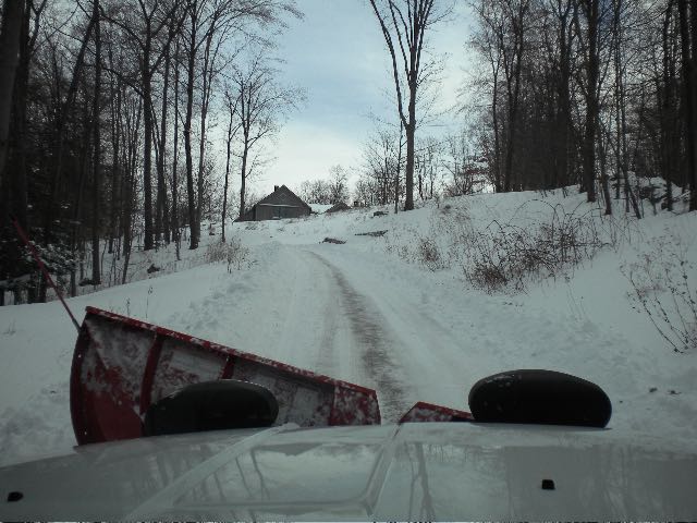

Here's a pic from the cab of my former snow rig. You can see why I wouldn't want to have to come down that hill backwards!

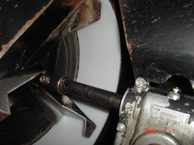

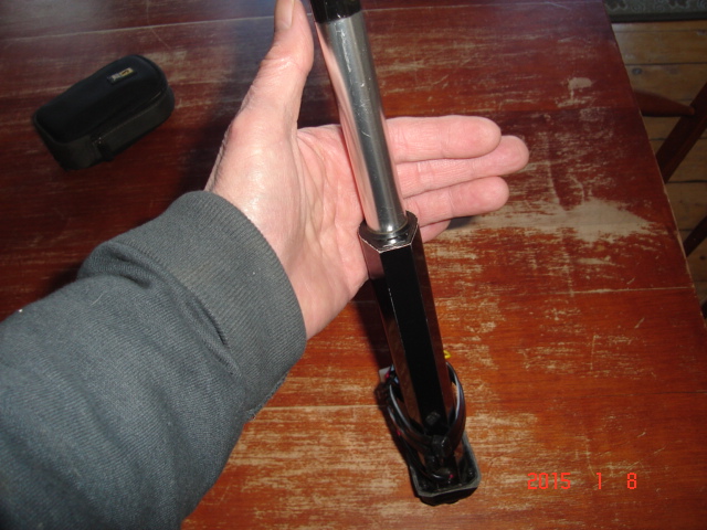

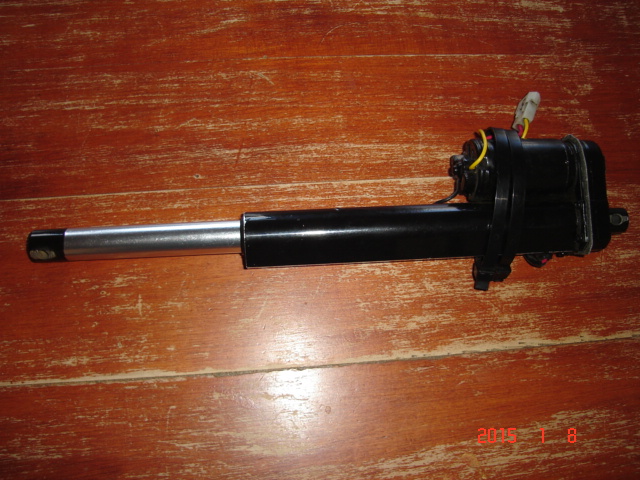

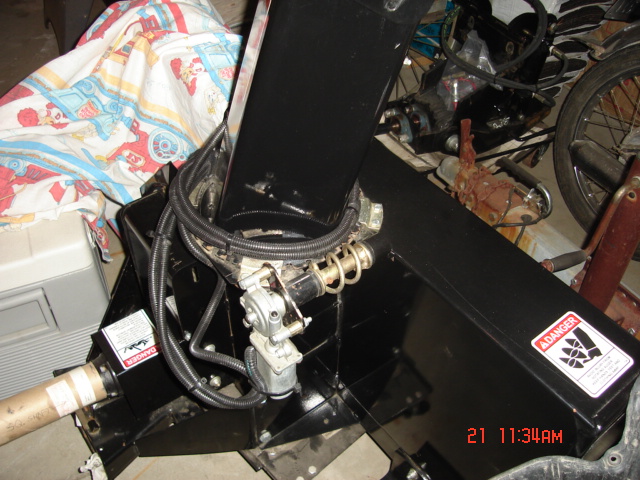

So maybe these pics will give folks some ideas; mine has the factory-mounted electric chute controls. A bit slow, but adequate.
So far, quite dependable, though I do have to disassemble the linear actuator about every two years to clean out accumulated water (ice) and fill the gearbox up with grease-- LIGHT grease. This year I made a new gasket for the motor's lower cover; I was told by the mfr that replacement parts for that "obsolete" actuator are no longer available.
blower worm drive-3.JPGblower worm drive.JPGDSC05591.JPGDSC05590.JPGblower linear actuator-3.JPGblower linear actuator.JPG

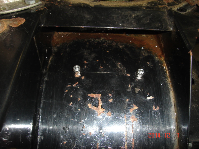

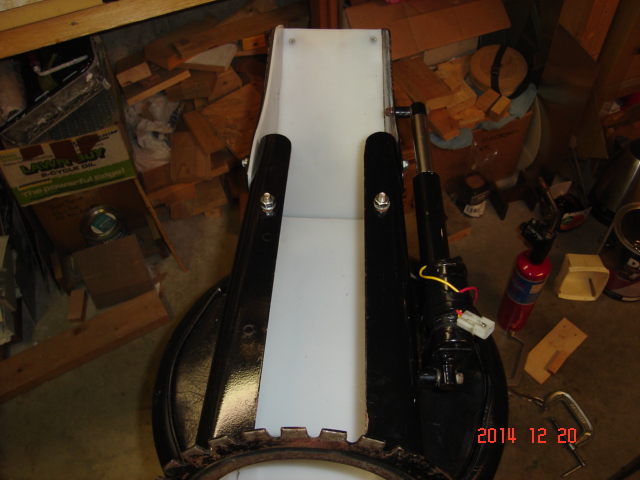

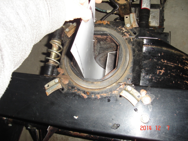

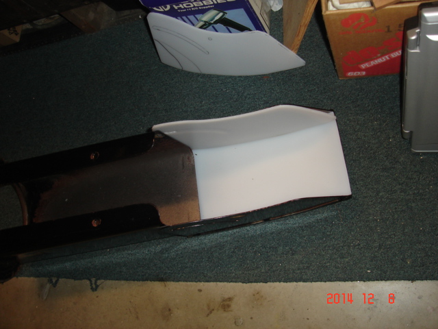

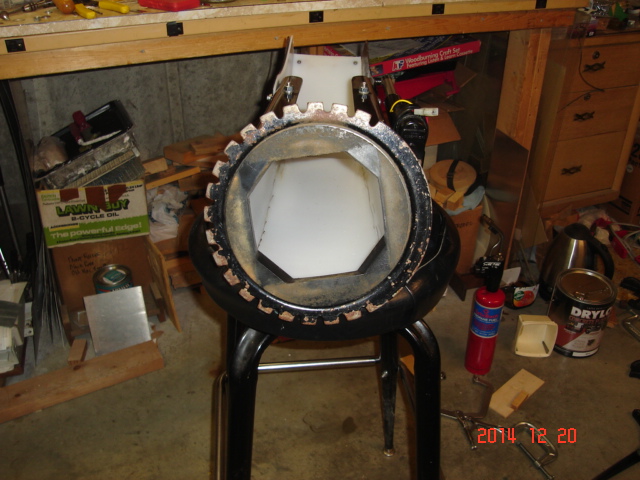

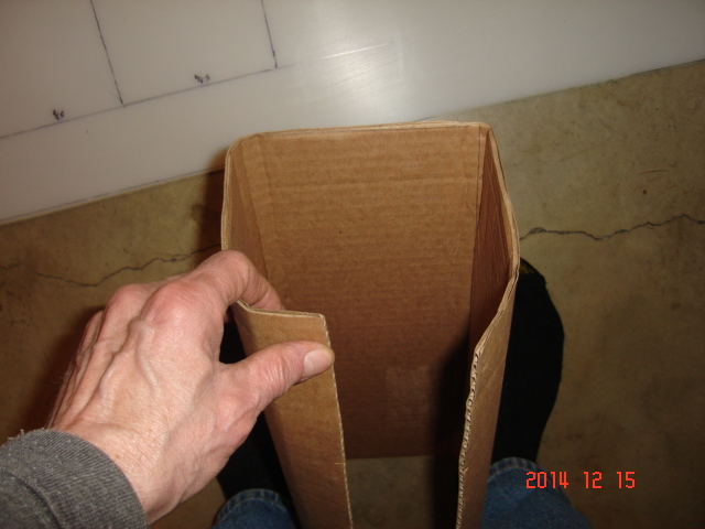

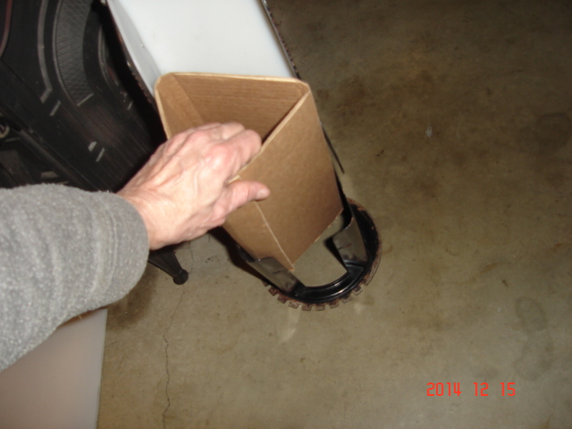

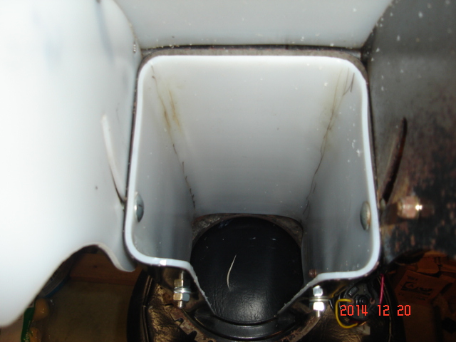

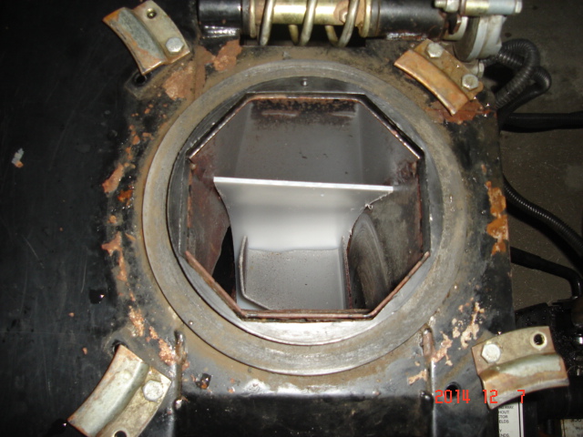

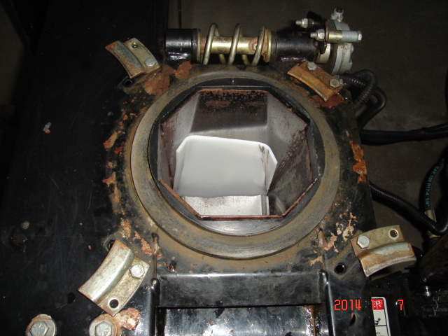

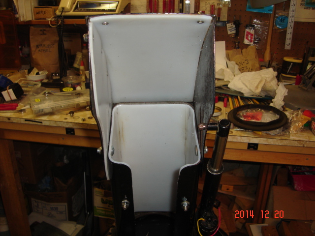

Stache, are you referring to the UHMWPE lining, or the other blower mods? I had some smallish issues with my lining, in that a relatively flat rock got caught in the outlet and jammed the plastic some, flexing it and making a hump. I've since cut the PE back bit so that shouldn't happen again, hopefully.
/ Orange on Red #57
Irving,
The lining thing is the MAIN thing that has me all excited, especially for the chute area. It seems like UHMWPE would make that SO much slicker that it would reduce clogs, or at least make clearing a jam so much easier.
I don't know if the impellers are worn enough on my 4' Pronovost that I would need to line the drum, or have room to do so, but I know my brother's 7' whateveritis has plenty of wear that he would have room to try it.
[ And THEN I need the bigger/better shoes, so adding or replacing with some thick UHMWPE shoes/sliders there seems like the next step. ]
-and then the whole rest of the post. turn the spout with a button instead of the crank/cable I have now. Yep. This is my "project" post for the next bit of forever.

Yes, that's what mine uses, a couple of waterproofed toggle switches (though the rubber's cracking on one of them).
They're mounted on either end of the "dashboard"/instrument panel. Took a bit of getting used to (and I re-wired one of them to reverse it), but it works well, and I got used to it quickly. Like I said, the electric actuators are a tad slow, but nothing that can't be tolerated.

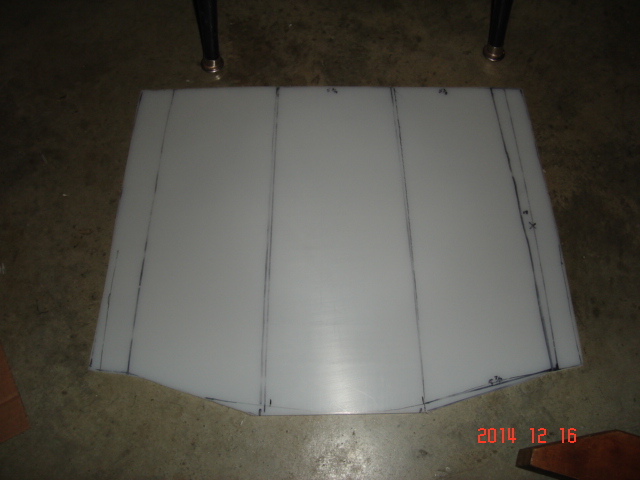

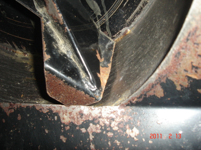

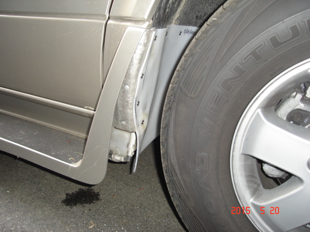

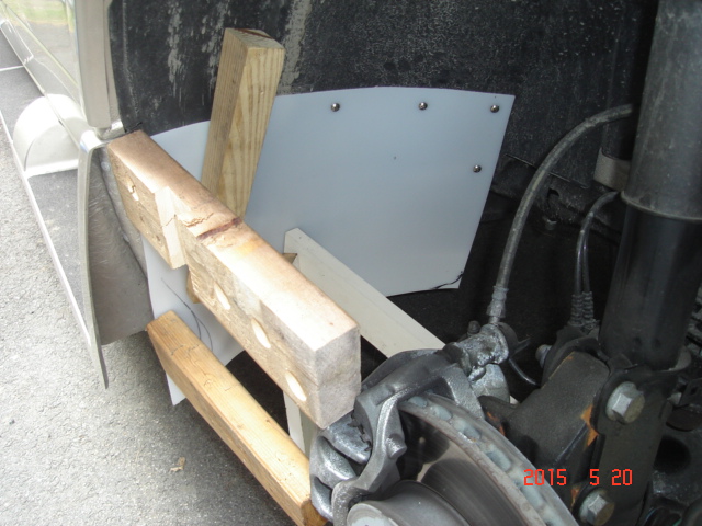

As far as the lining goes, the distance it threw snow last winter was better than it was when it was new. Wet clogs are pretty much history, unless you try to throw a REALLY wet slush.
BTW, I took the leftover piece of UHMWPE and fashioned a fresh water tank shield on the new RV we bought, using the very same torch technique. Worked great. (Just didn't like that everything thrown off the front right wheel would hit the tank & drain fittings.)
/ Orange on Red #60
Irv,
Good application. As you know, UHMW is "bullet proof" - litterally. Depending on thickness of course, a one inch thick piece will stop a .45 slug - though I'll pass on the opportunity to be standing behind it.
I did end up buying a 48" X 96" - 1/8" sheet to get a long enough piece to line the impeller housing on my blower. Guy contacted me back and said shipping was going to be more than the cost of the sheet (sheet was just over $100) . . . they were planning to ship it flat!! I told them to roll it up tight. They did, and charged me $46 shipping.
Have a lot of other projects now, and winter is still way off, so I doubt I'll be getting it done soon.
