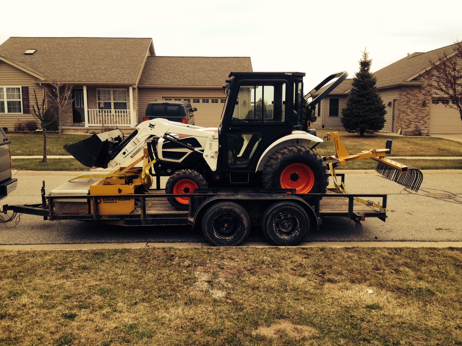

I have the older version. a bobcat CT 225. I purchased a factory steel cab and installed it myself for my tractor. It has heat but no AC. I believe the cab was made by a company called Cozy cab for bobcat and came with a bobcat logo on it. I am very happy with it. all of the glass panels are lined with steel and have prevented many glass breaks because of that. Only negative is that it is a bit loud compared to a factory cab. But it is a very thought out design with doors that are easily removed and have hold opens for more ventilation in summer

That's a nice looking setup you have there.

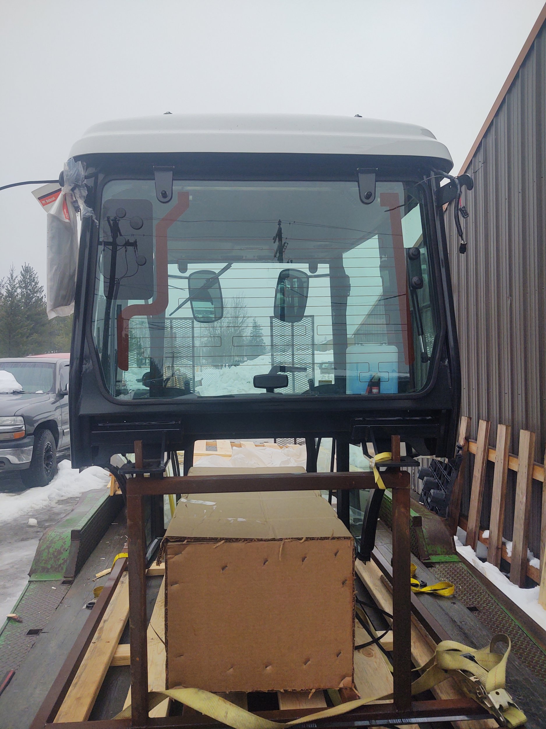

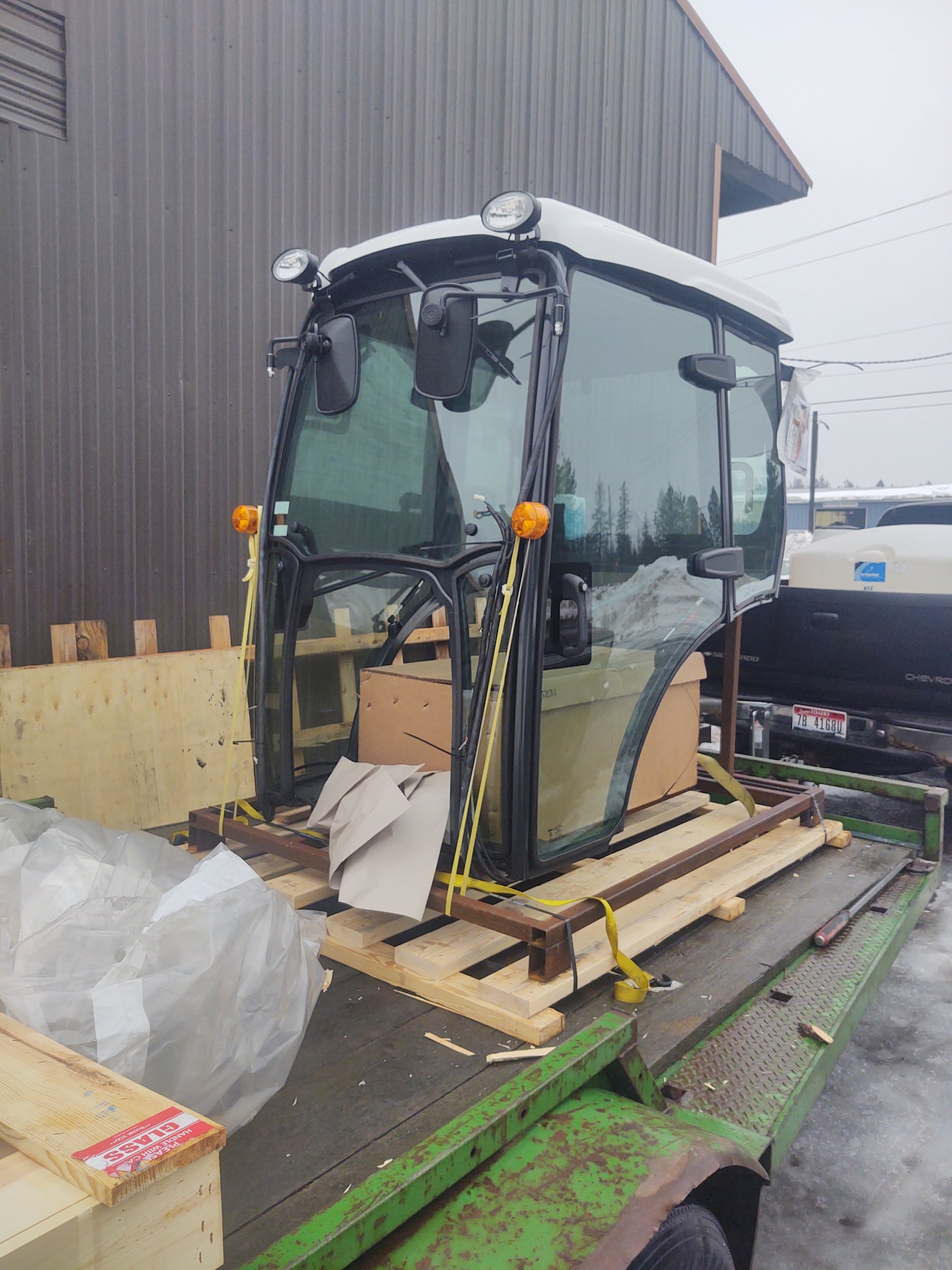

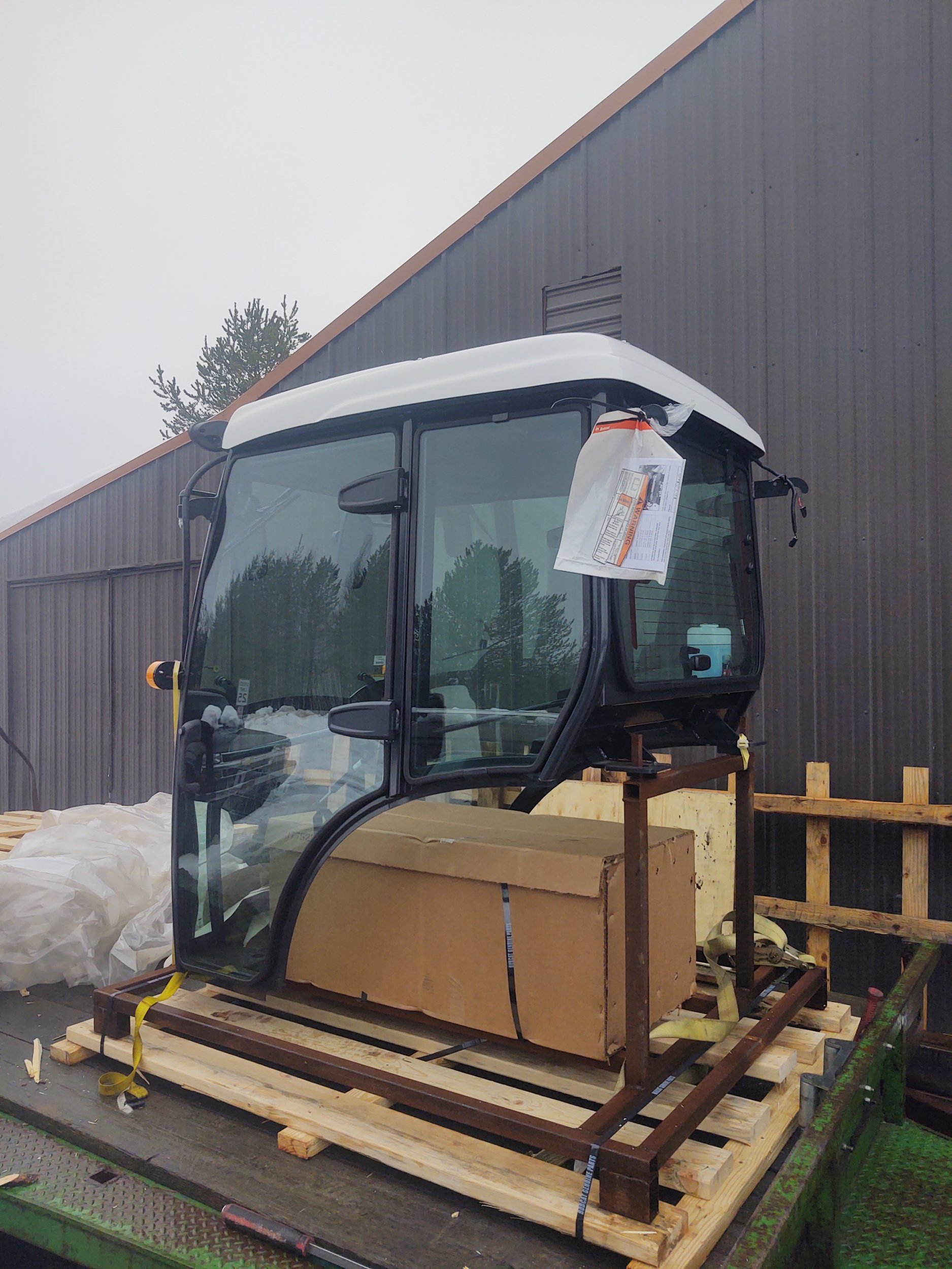

New here and bought my ct 2035 open station in October. Have now decided I want a cab and heat. No cab tractors available, couldn't find much on bobcat tractors with the "field cab" except this post. Adding pictures here for others to see and ask questions if they want. It is going on the tractor hopefully this week. Pending projects currently in the shop. I considered building one, but with the cost of materials and time I have, it made sense to buy a cab from the manufacturer.

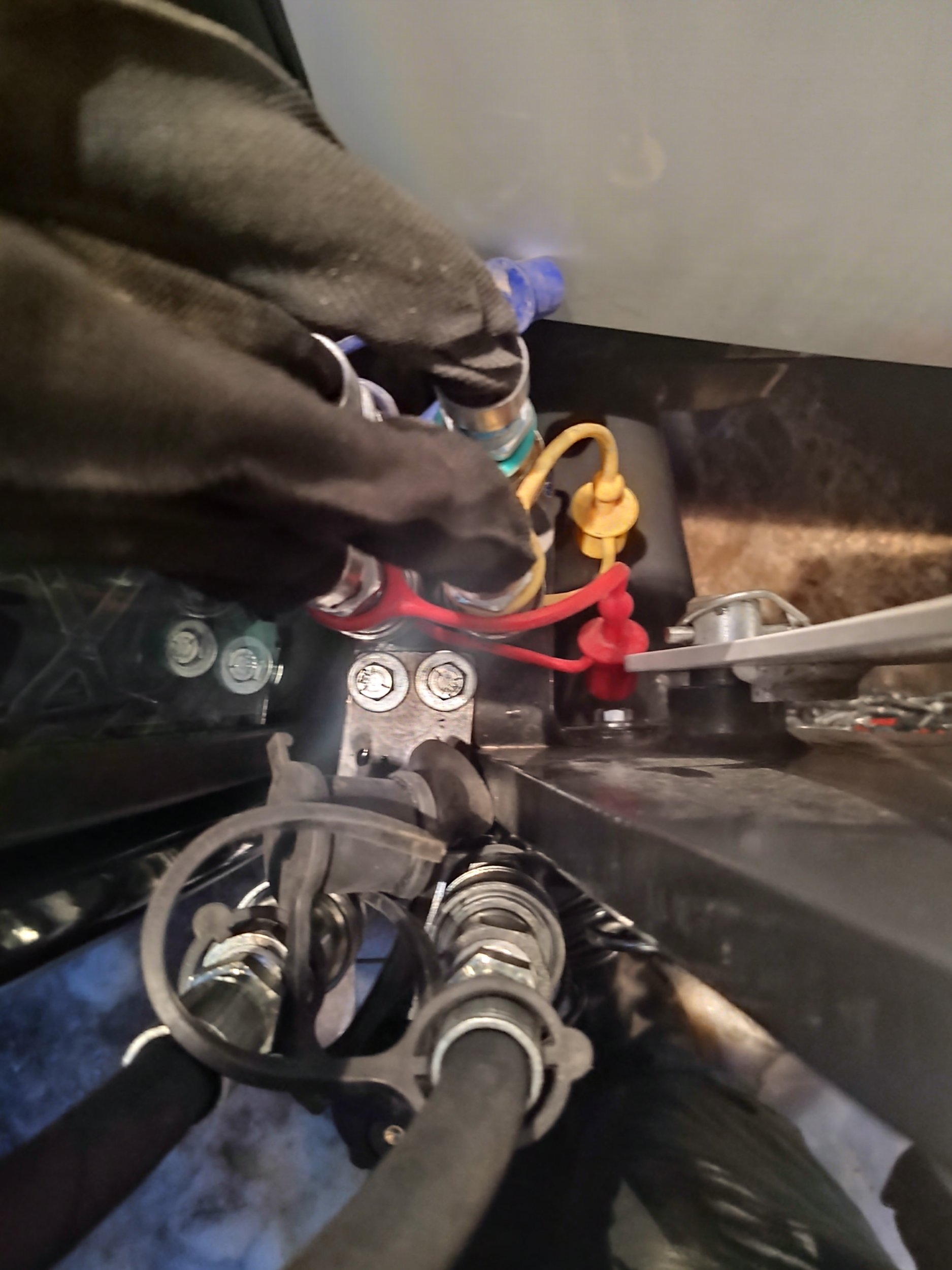

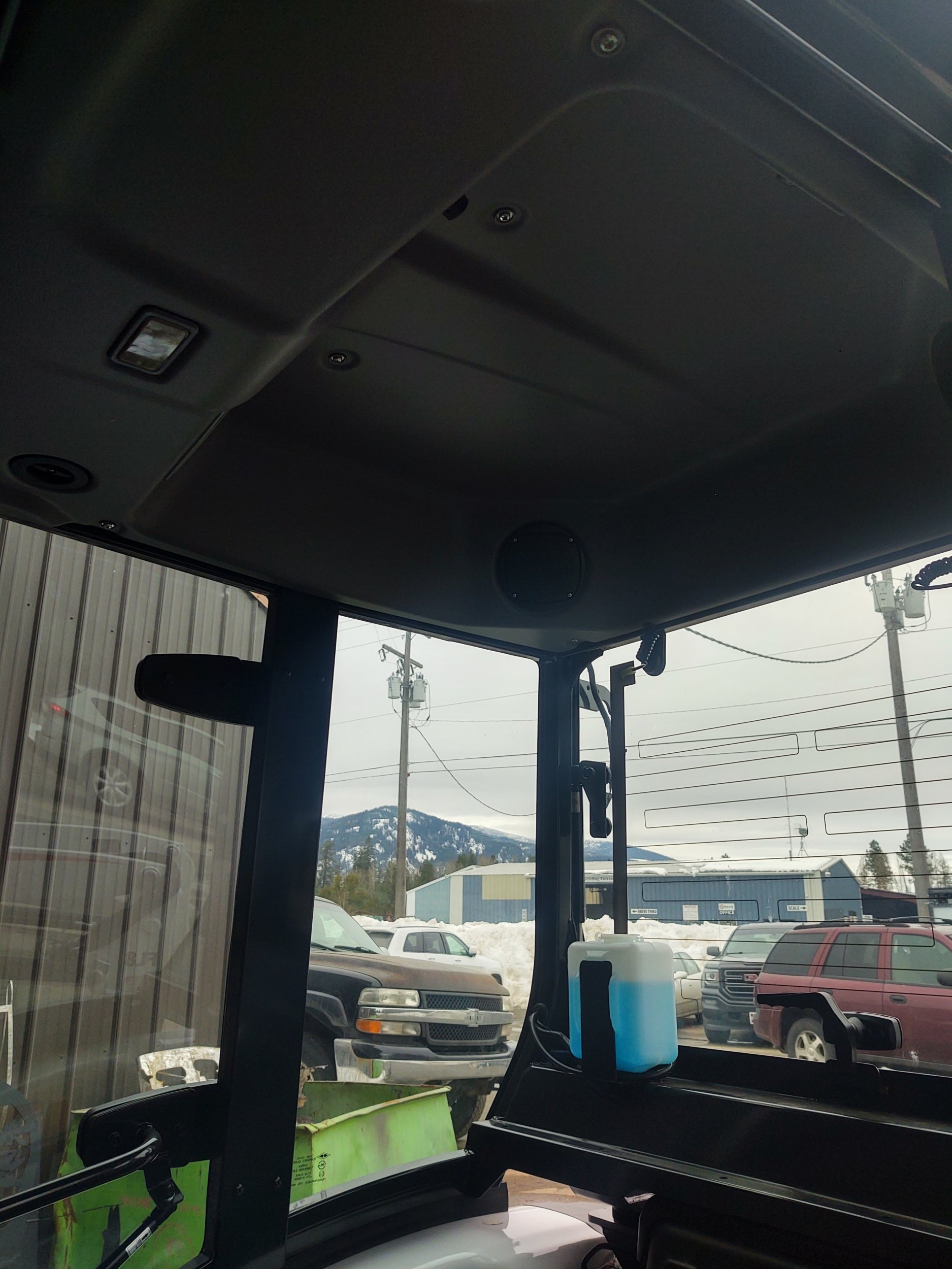

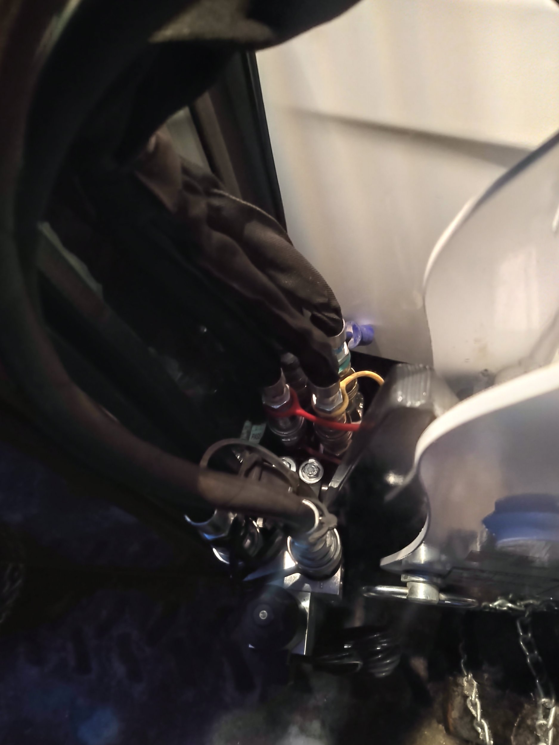

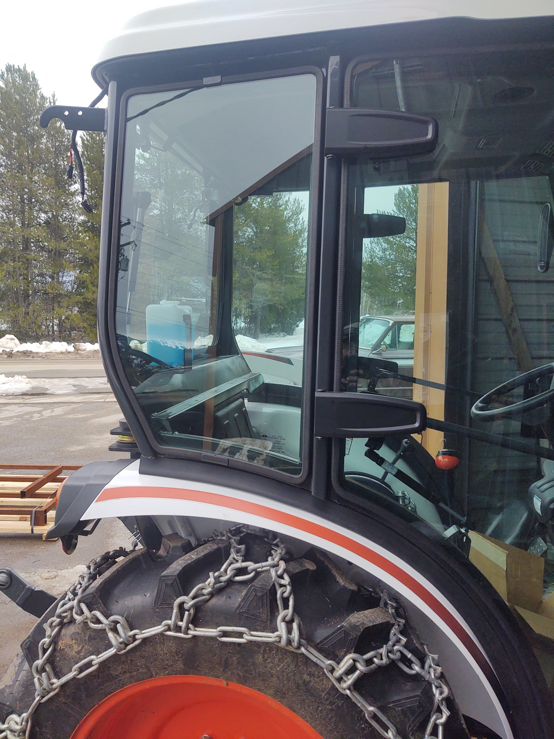

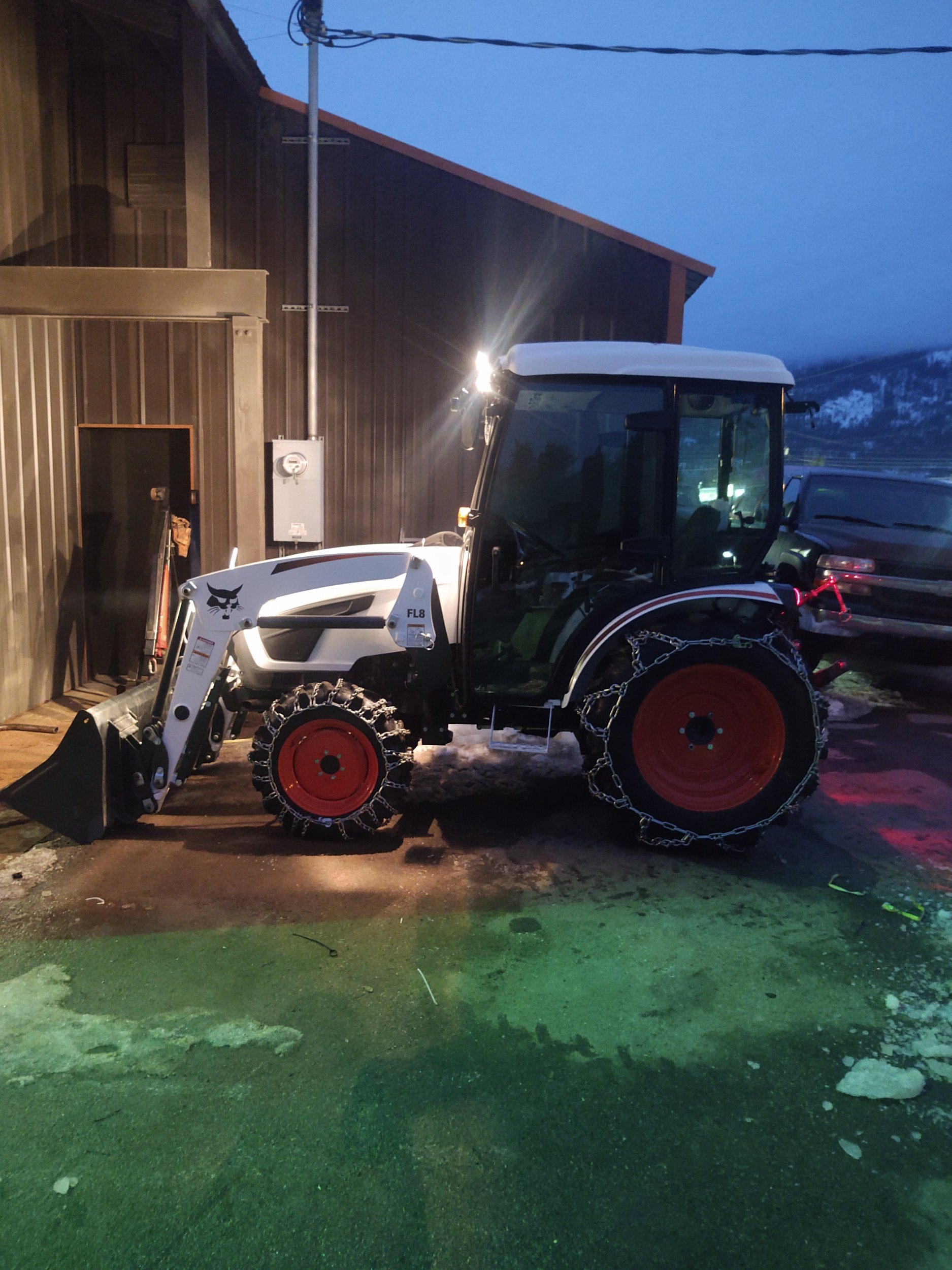

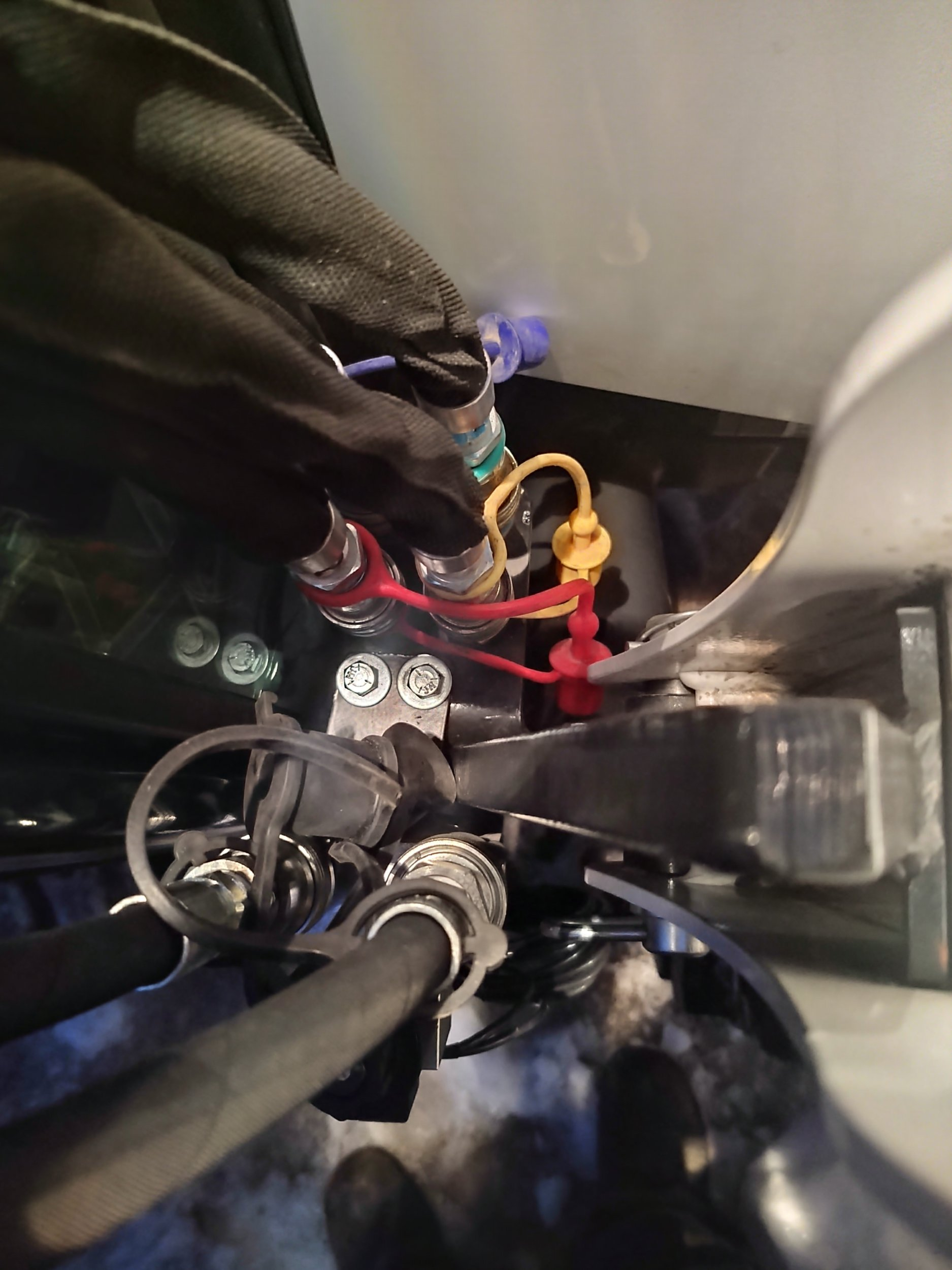

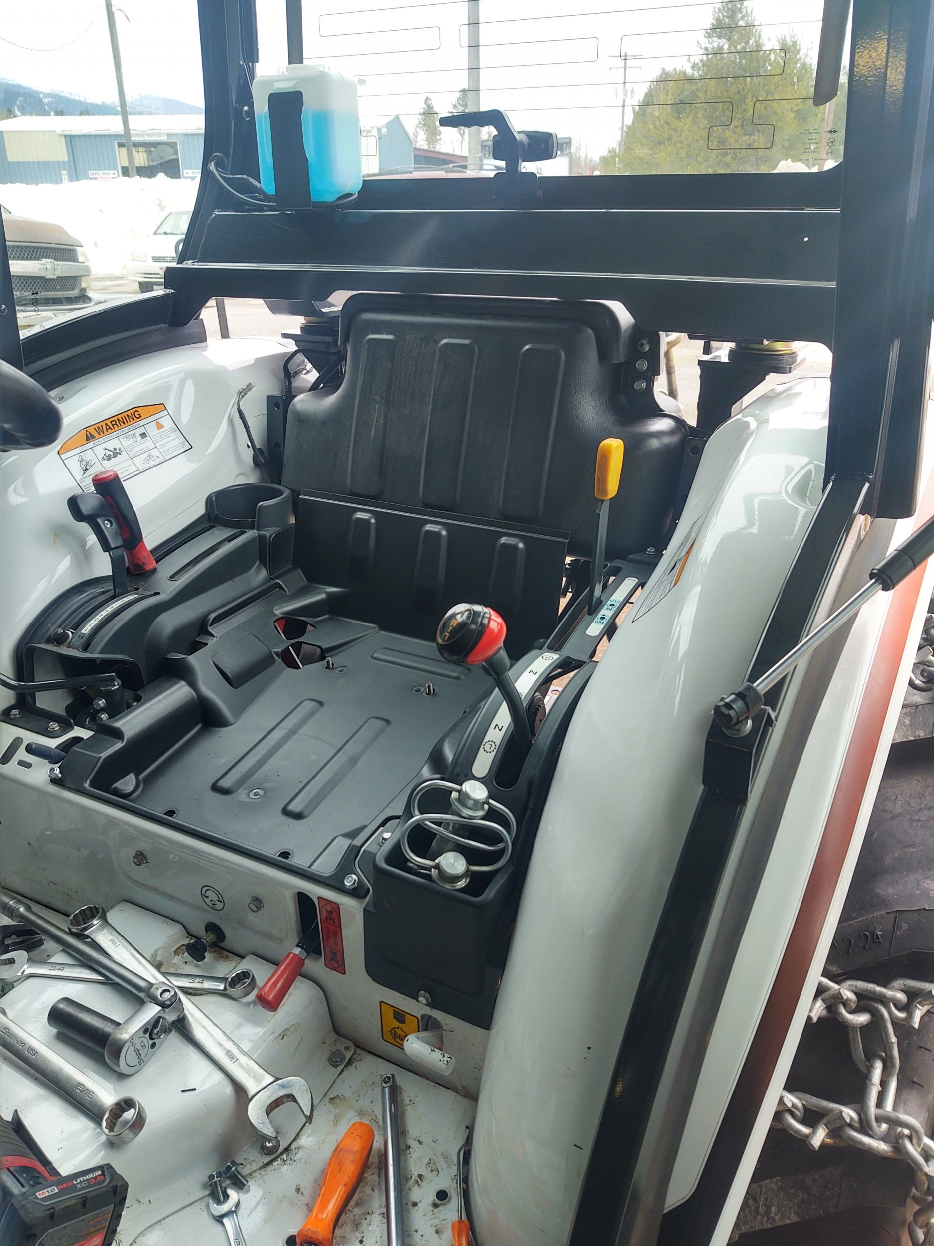

We got the cab mounted on Wednesday, fit and finish is great. I installed the hydraulic side of my 3rs function valve while the seat was off. Still was able to get it all on and hooked up in a day. Things to keep in mind is the heater core lines need to be primed with coolant before hooking up for good. Otherwise it's a HUGE air pocket in the heater core. So far I love the cab. I opted to not purchase the insulation package because it was an additional 1k. Figured with the cab and heat it will be a huge step in comfort while using the tractor in the weather. It is louder inside the cab while running the tractor, ear plugs or something for the long days of plowing and working inside. With the windows open it's better though. The front glass tips out a good 6-8" at the bottom and the rear glass is defrost type and opens as well. I added some work lights to the rear upper corners and waiting for a switch for this. I included the pictures inside and also the hydraulic connections to see how tight everything fits. I'll add more later.

That’s awesome. Hard to go without a cab once you have one. I too was very surprised at how much noisier it was with the cab on. I spent quite a bit of time trying to reduce the decibel level inside the cab with some success. I cut some pieces of carpet to put on the floor for the winter with some padding that helped. also I bought some 1 inch wide by approximately 3/8 thick foam weatherstripping and ran it along the steel supports all inside the tractor. I also used sound deadening under coating under my fenders and rubberized flashing tape where I could under the seat underneath the tractor to absorb sound. Was able to reduce the decibels inside the cab quite a bit.
