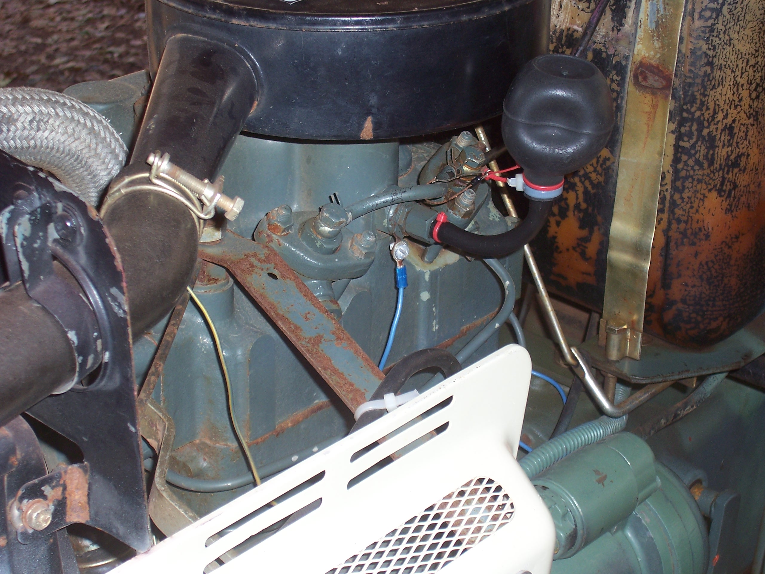

I must not have TS then, all that is where the bulb should be is a stud.
So is there any way to warm the glow plugs before attempting to start? The only diesel experience is humvees and generators from my Army days.
That tractor prolly did not come with Thermostart, it supposedly was an option. There are no glowpugs or starting aids other than the compression release if you dont have the TS thing mounted in the intake which is a heater element, similar to a glow plug. I have started mine in the low 30's with no assistance other than spinning over and the 2 failed attemts it took.
You don't have glow plugs.
