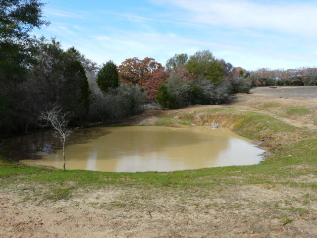

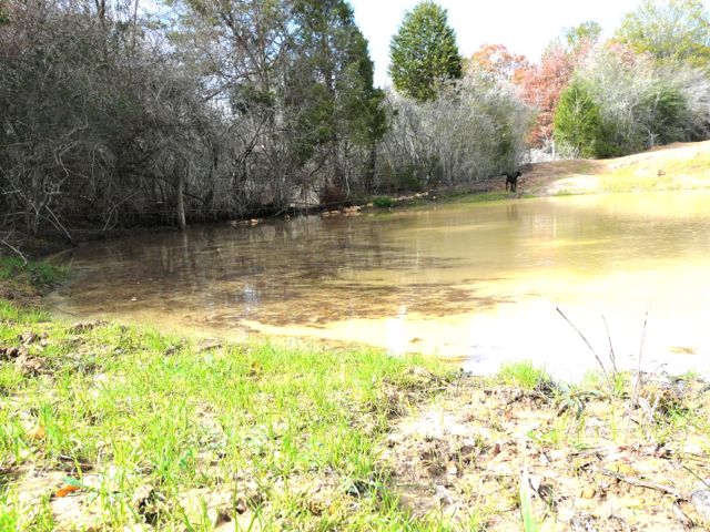

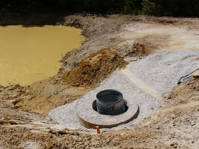

Pictures of the installed culvert. The spring water is coming in now around the culvert where the gravel was placed. When that gets clogged up it will come out the culvert which is 1" below the water level (well, that's the plan anyway). The part you see sticking out is the connecting piece with a screen on top to keep animals from falling in the 6' by 30" culvert.

Are you going to smooth the banks and seed them with grass to control erosion? I had some steep banks that took years to cover on their own with weeds and got quite a bit of dirt washing back into the pond.
   / Opening up a spring with a track-hoe
#133
I did!!!!
But the rains came before the grass grew.
I guess you're suggesting a repeat.
More seat time, not a problem......:D

Well, it looks like your crushed rock actually aided grass seed to sprout. Perhaps the mud silted in the gravel and held long enough for the seeds to germinate. If you have more gravel to spread a thin layer, you might slow the erosion and get germination the next time you re-seed. Just a thought. . . . BTW: The water level looks perfect. When it clears, you'll have an even prettier little pond.
