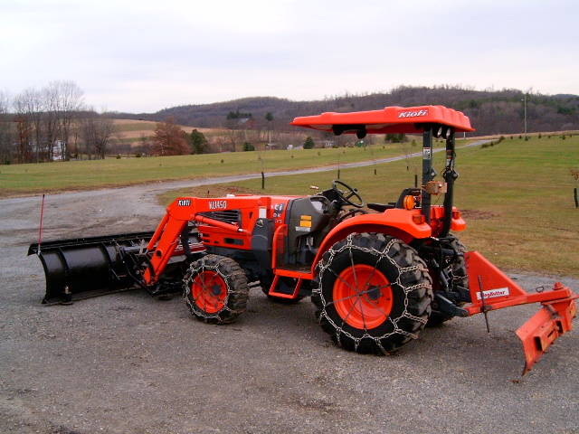

seacap04
Here is an older photo of my setup.
R-4 tires, Loaded rears, 4 link ladder chains front and rear.
And A 7' rear blade.
This year so far we've had around a foot of light/dry snow. On average I would say we get 70% dry snow 30% wet.
I never use float on my FEL. Puts to much weight on the blade and can't steer. I set the loader down with just a small amount of weight on the blade and go.
The blade follows the terrain just fine this way.
I do not use float and put chains on the front to help with steering.
Even with chains the front can still push with the blade angled on accasion in heavy/wet snow. But its not a problem as long as I don't let the snow get too deep before plowing.
