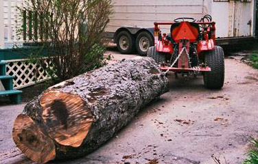

With three acres to look after a "Kubota SCUT type tractor" would suit you just fine. Attachments are quite easy to put on or take off and you may find yourself going for long periods with just the MMM being used.
Chances are that jobs requiring a larger machine will best be done with a one time rental machine with or without an operator. On three acres these type of jobs are usually a one time thing and then it's back to maintenance.
With a new or newish SCUT the maintenance should mostly be lubrication and cleaning the radiator externals as your hours will be fairly low. [in most cases]:D
The SCUTS can also do some serious homeowner type work if you have patience as it will take longer.:D
In Alberta we lived on three acres with a Kubota B7100, 60in. MMM, FEL, back blade and 42 inch roto tiller. Met all our needs.:D
When we moved to Nova Scotia this same tractor followed us and was used extensively out at the 68 acre Lake lot or Play Farm or Wood lot, designated as to what I was doing at the time. Here it got into some serious work moving dirt and rocks, removing the odd tree and stump, building up the access road and cultivating about five acres Play Farm area.
Some pictures attached depicting what can be done.Dug out stump, moved log,digging out rocks and a little area that was tilled with rocks moved around it.:D
