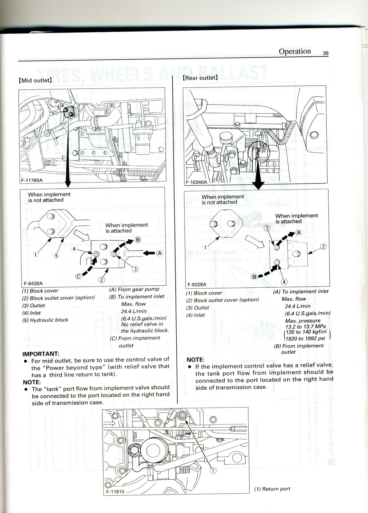

Kub B 2910 has a mid and rear outlet.
The diagram shows "A" to implement inlet max. flow 6.4 U.S. gal/min
"B" from implement outlet
I understand implement to mean the control valve, then the other 4 hoses would connect to the two double acting cylinders and the each valve would activate the individual cylinders one for each valve.
Am I getting close?

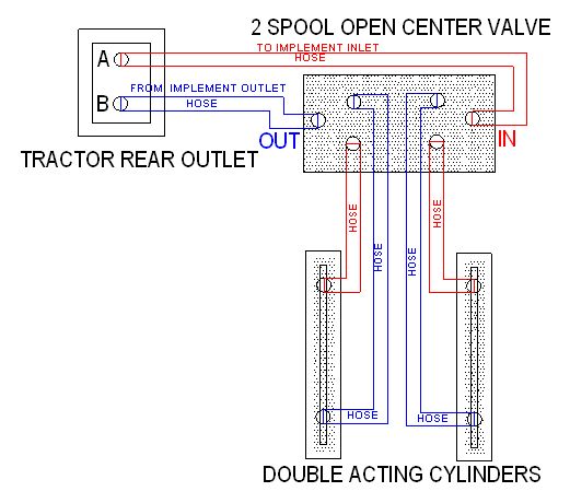

Since everyone on this site is so pleasant and helpfull let me keep this going with a scan of my Kub manual and a drawing of what I thought would work for me.
After checking the two pics please tell me if I'm on the right track or all wet.

Good Job on the scan and drawing. You are on the right track. Bird is right in that you do need an open center valve. it should be at or greater than your max gpm.
Think of those hyd blocks for aux hyd as detours. With the cover on the oil goes straight on its path (maybe a slight jog through the cover, but not much), but with the cover off and lines hooked up to the block the oil makes a detour to a valve, through the valve (power beyond port) and back to the other side of the block on its way to power the next thing in the line. You connect the line in and the PB circuits of your new valves to the blocks.
However, in your drawing, you are missing one very important line, the return to the tank. It is mentioned at the bottom of the picture from your manual. On your valve there must be a PB port (flows pressurized oil in the series) a return to tank (oil returning from the cylinders ) and a pressure line. Plus there will be 2 lines for every spool that you have in your valve assembly.
The above is what is necessary for the mid mount. It seems that the rear aux hyd is after the 3pt and therefore does not need the PB port as it just returns to the tank. Therefore your diagram will work, unless the valve has a relief then you need to attach the line to the tank return as stated in your manual.

Keep um coming. I have read and re-read but I'm still confused.
If I could build this setup with 2x4s and a hammer I would not be such a bother.:D I would have had it working months ago.
RonMar, please look at the attached pic and "rub my nose in it" :)
to see if I can understand.
Since the valve states the PBeyond is optional are you saying I should be able to make things work with 6 hoses?
And not have to run back to the trany??? As Mike mentioned.

/ one more hydraulic question #19
RonMar said:
Not necessarilly. It depends on how the valve is configured. If it is a valve setup for power beyond, it will have 1 high pressure inlet, 1 high pressure outlet and 1 low pressure outlet/return line.
A non PB valve will have one high pressure inlet and only one outlet line which is the combined High Pressure gallery and the return gallery. Since it is after the spool valves, this port will never see high pressure unless you restrict the outlet line in some fashion.
RonMar, in theory you are correct. I was merely emphasizing exactly what the manual says; "if the implement control valve has a relief valve, the tank port flow from the implement should be connected to the port located on the right hand side of transmission case." It does not specify if it is a PB or non-PB just the aspect of relief valve and it is specifically applicable to the rear aux port (as it is repeated for the mid port). That is why I stated that all the valves that were listed needed a return that "should be connected to the port on the tranny."
Gotrocks, the valve that you pictured has a PB port and a relief valve. Therefore, according to your manual, you should connect the inlet of the valve to the "A" port on the block, The PB to the "B" port of the aux block and the outlet to the tranny on the right side. You are right that the 4 green ports are the work ports.

Yes, if that is the last valve in the system, that valve will work with 6 hoses and NO PB sleeve/plug as your colored spots/arrows indicate. The drawing shows the power beyond plug/sleeve in place. If you had a side view of the valve, you would see a threaded port in that power beyond plug. The outlet port on the top of the valve(your blue arrow) comes from the return galleries from the work ports and the pressure relief gallery from the safety valve. It also connects to the main inlet gallery below it where that PB sleeve is shown. With a PB sleeve installed as pictured, the walls of the sleeve cover this last passage between high pressure port and outlet port and forces the HP line to exit thru the PB sleeve. The valve without a PB sleeve will have a low profile pipe plug(maybe 1/2" tall hex head) where the drawing shows the PB sleeve now.
