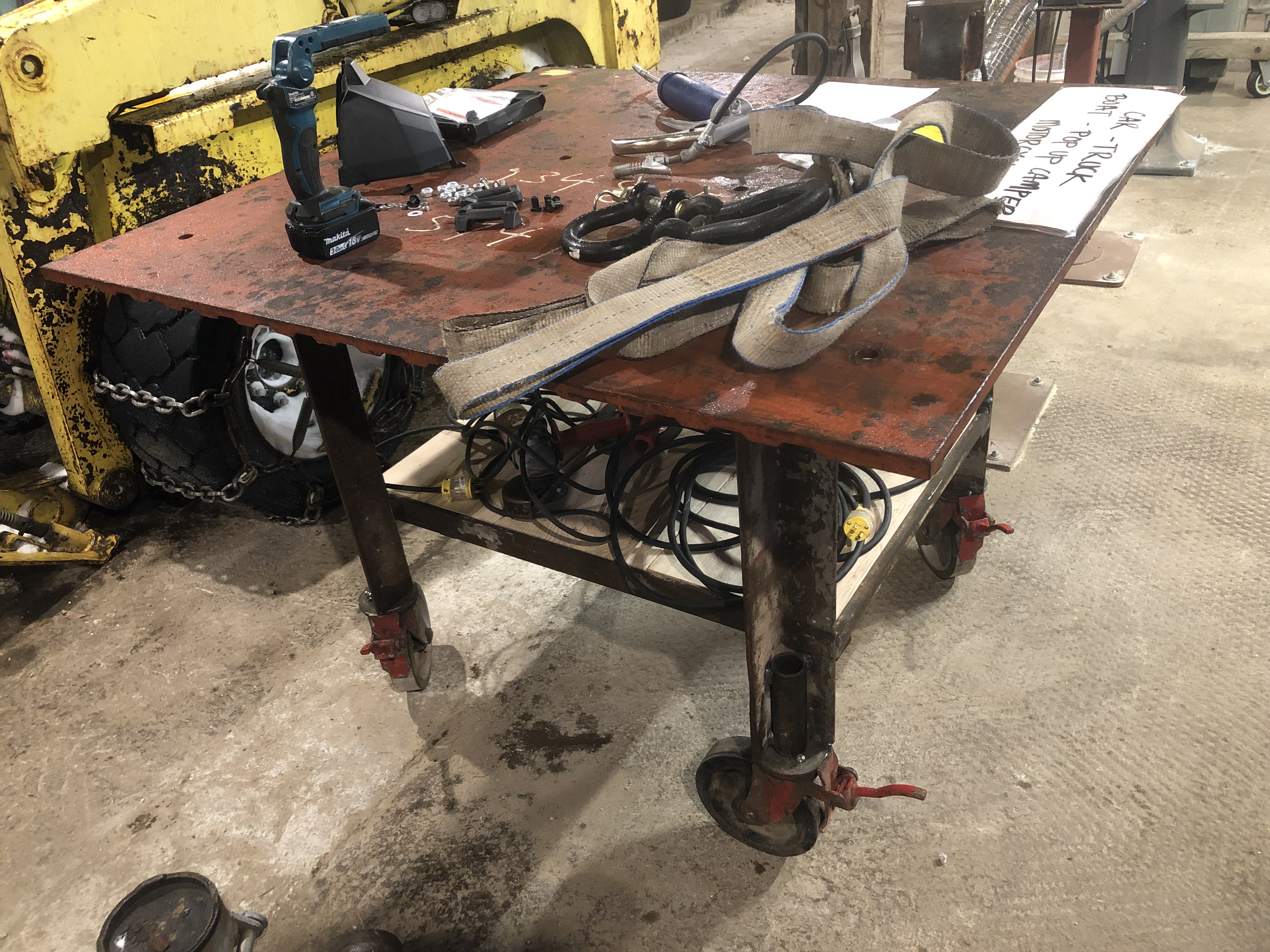

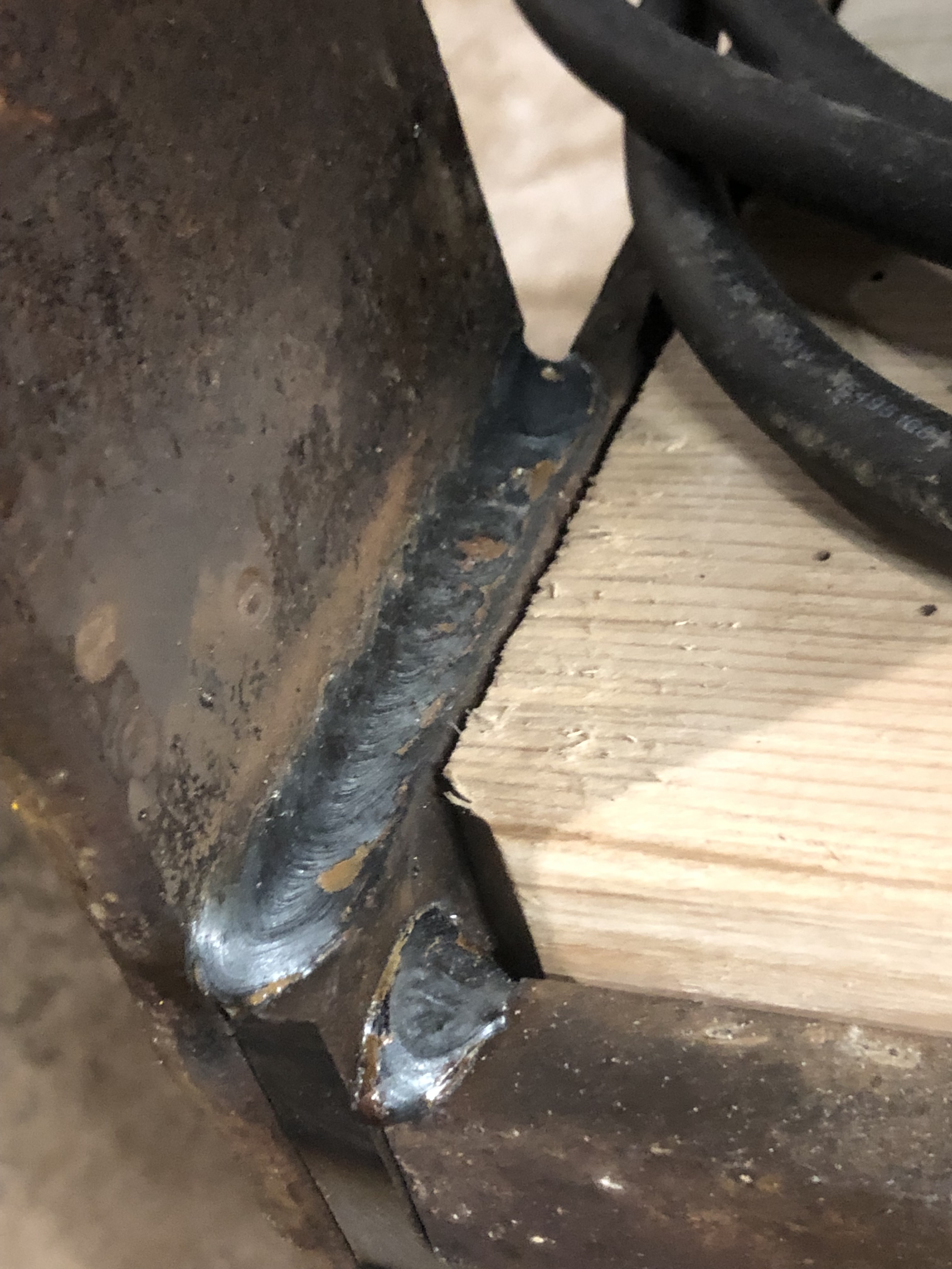

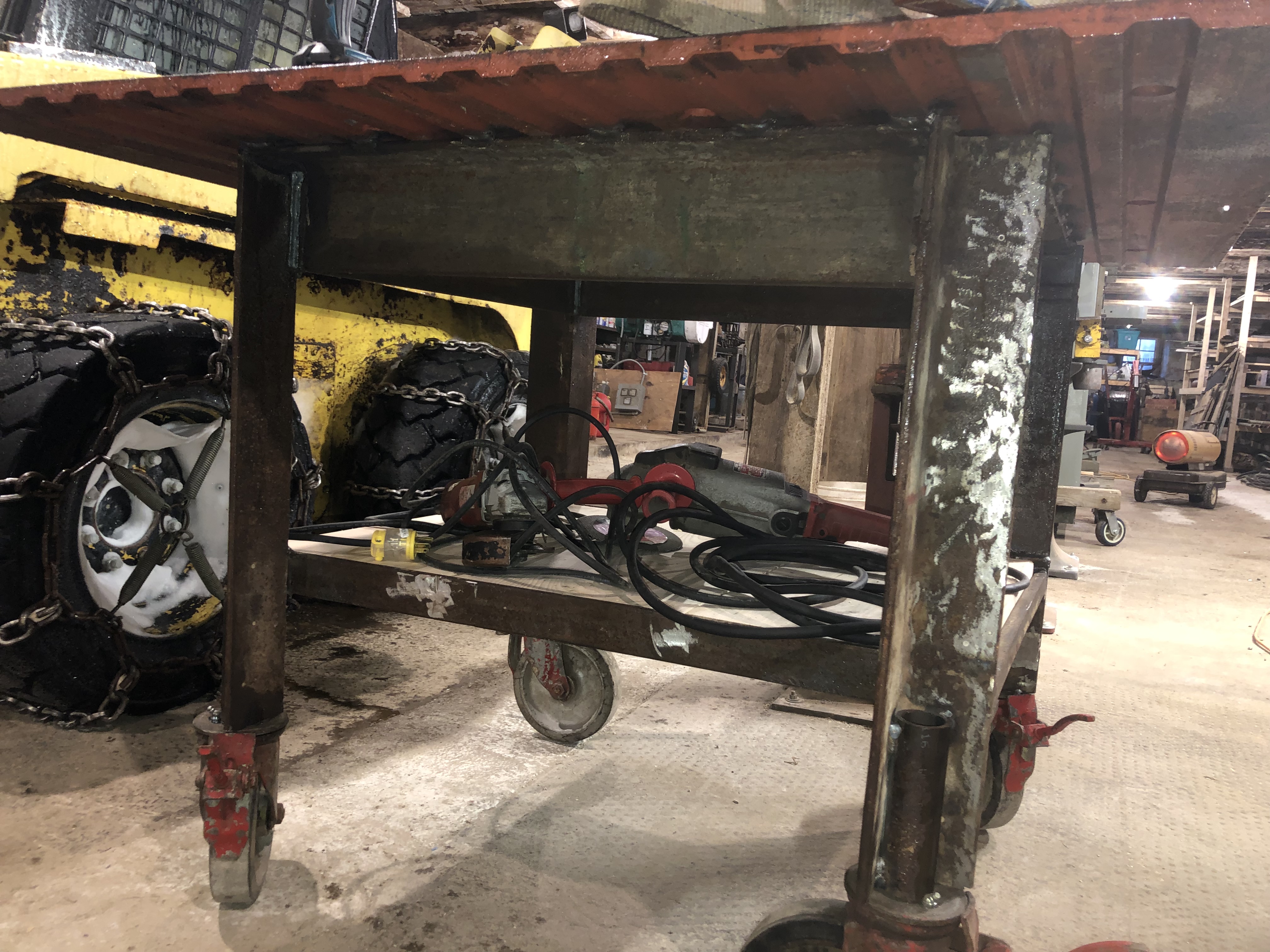

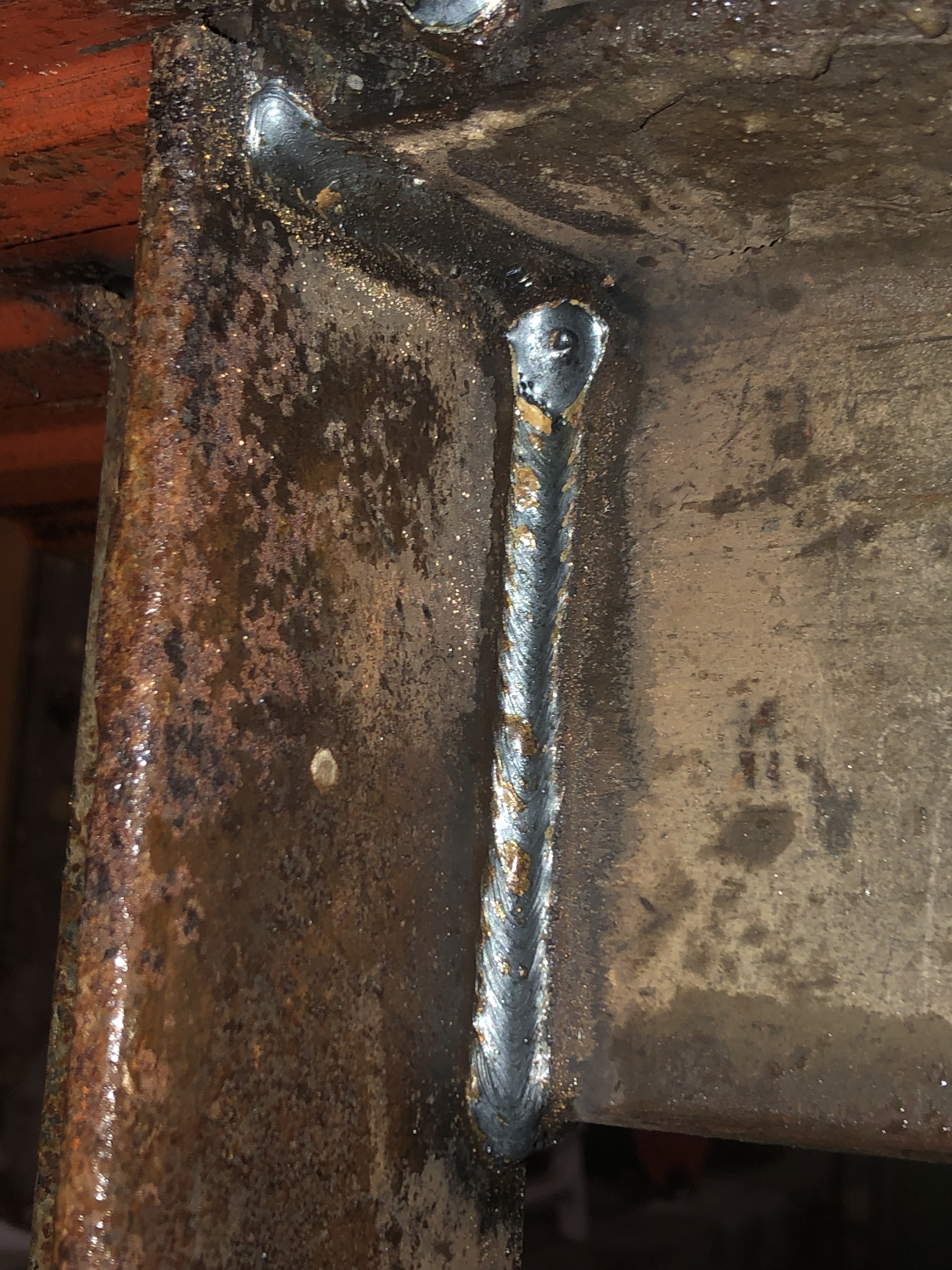

I bought the steel for this table almost 10 years ago and never got around to building it. Now that I'm getting my shop set back up, I thought it was a good time to burn it together. Top measures 40x48" and is 1" plate. I've never seen plate with one side corrugated like this. Casters are 8" scaffold style so they lock for rolling and spinning.

That ought to do it! Not only do you have a good sturdy table but one more check mark on the list is done. Congrats!
/ One day project : Welding table #4
Very heavy duty...will take a pounding ! Seems though you still have that touch for making some great beads !!
/ One day project : Welding table #5
That. Is a Cool piece of Table Top..
/ One day project : Welding table #6
Awesome tabletop and someone knows how to weld too!
Thanks guys. I don’t know why, but I’ve been really struggling with not being able to see the bead for a few years now. For some reason it clicked on this project and I could see what was doing again. Not sure if it’s the wider beads or the increased amps, but it was like I was 15 years younger and boy the beads were laying nice!
Gosh it would drive me nuts when I could not see the edge of the puddle. Get some crummy welds that way. I finally got glasses (just in time my birthday!) and they’re bifocals, so I’m thinking about trying a cheater lens to see if it helps.

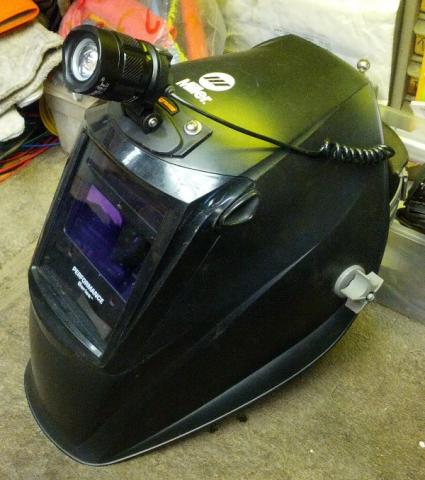

I found with my old eye (cataract surgery both eyes), cheater lenses work really well and flooding area with a lot more ambient light helps me see where I am running the bead.... Experimenting with headlamp on welding helmet like image below.... Seems to help...

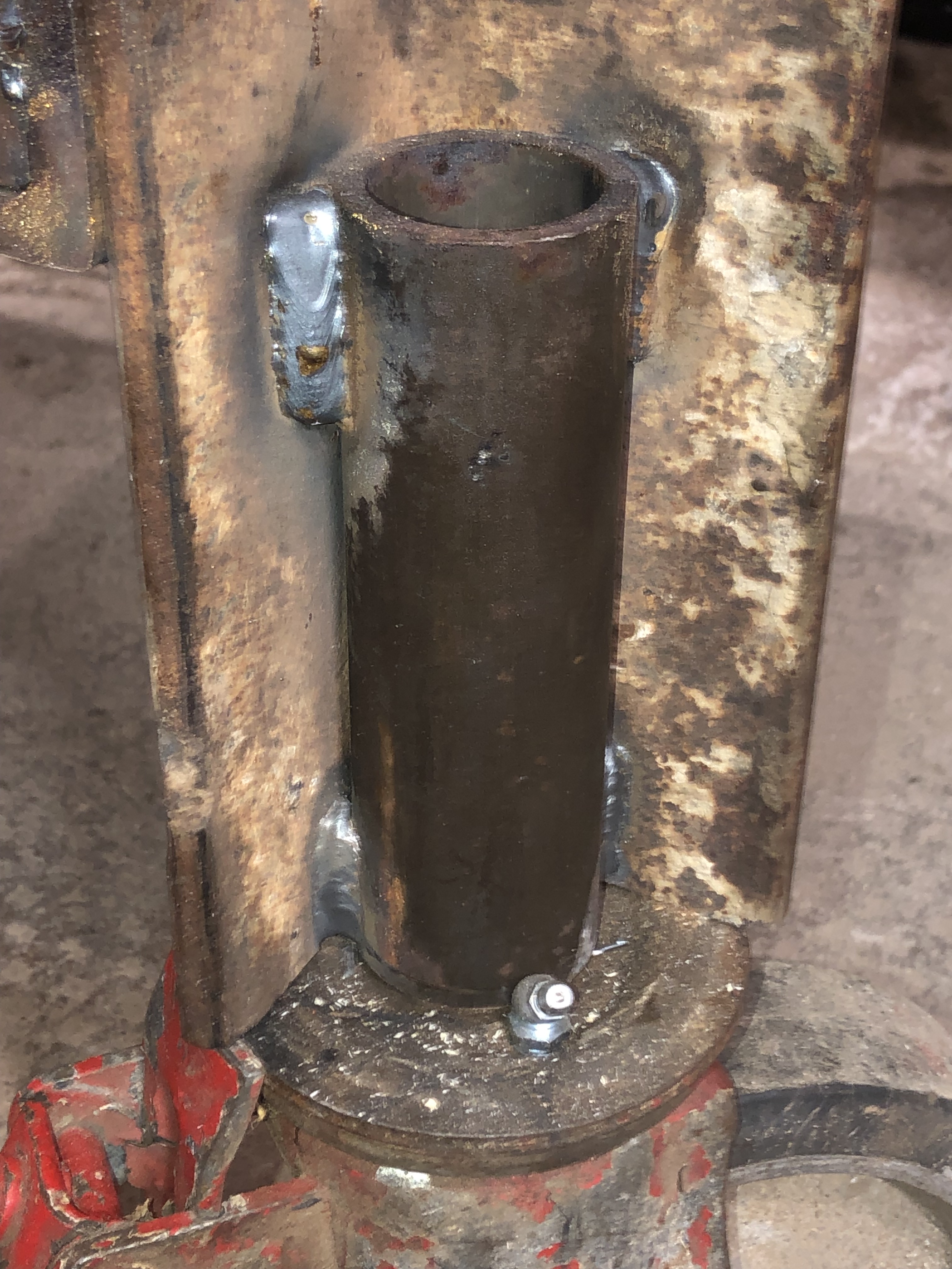

The project is not done,,, you forgot to grease the grease fittings!! :eek:
Great looking welding table!! :cool2:
Dale
Where did you get the light?

Greased 'em before fitting the wheel spindle into the sleeves. Then realized I'd never get the gun on the zerks because they were straight. Took the wheels off and then replaced the fittings with some 45's. That's why they look new and clean.

Right now I am experimenting with just small LED flashlight duct taped to helmet....
Sort of looking for miners or cave explorers clip on light, only objection is they have a remote battery pack and a cord which may be awkward.....
Actually using one of these right now because its light and compact....
Dorcy 9 Volt Flashlight - YouTube
But search for "ideal" continues...
