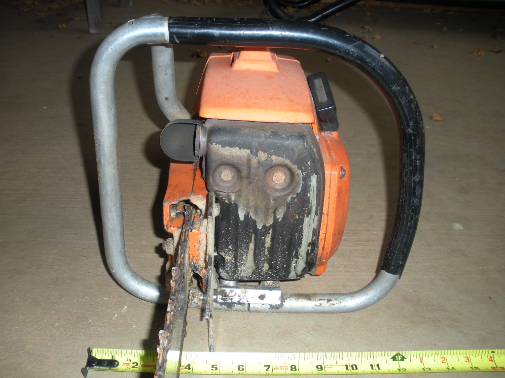

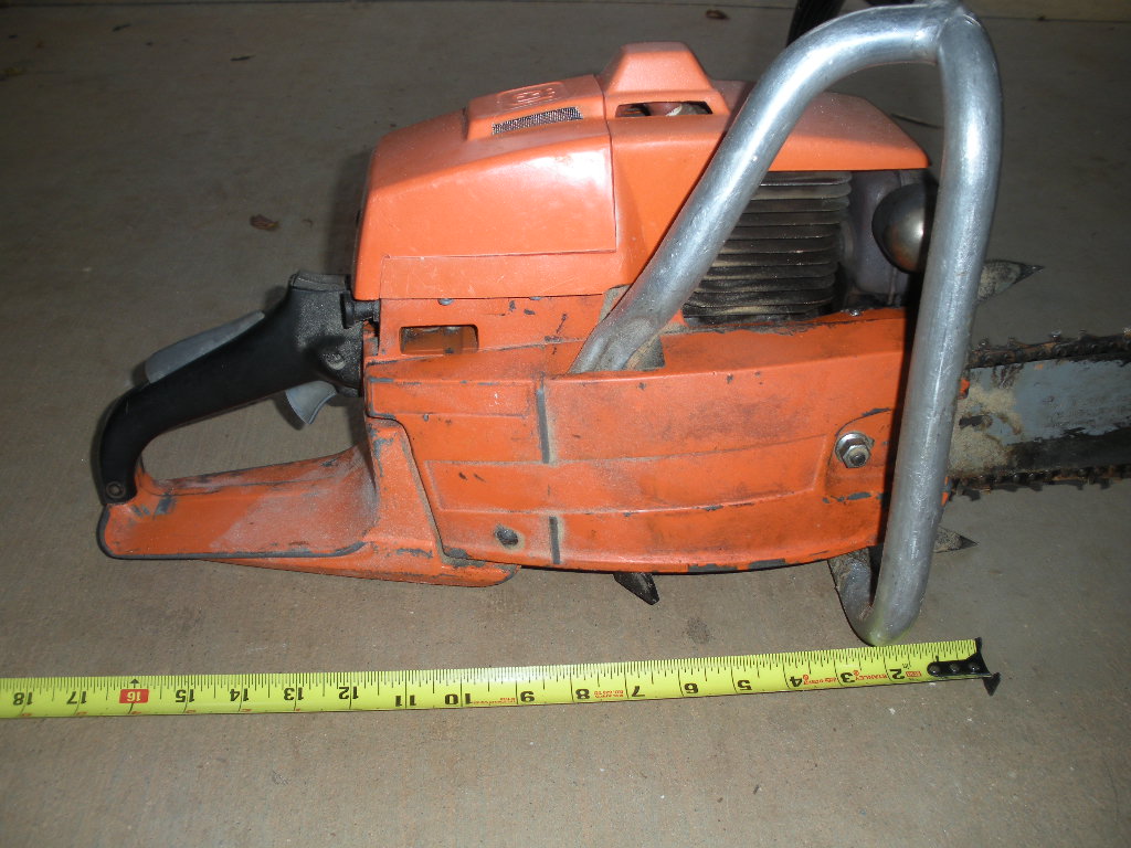

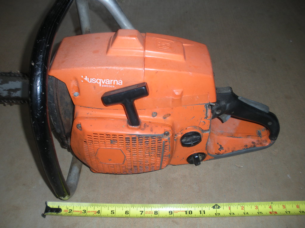

I think... my Husky is a 1100CD or 2100CD from the early 70's. It does not have a chainbrake, so maybe earlier 99cc 1100CD. It runs and cuts great.
View attachment 294187View attachment 294191View attachment 294192
the 2100 was a bit later in the 70's. I believe the 2100 had a one piece handle while the 1100 had kind of a bolt on. The 2100 had a torque grunt of the like I have never felt to date in any modern chainsaw. the 2100 also did not have a chain break.

model info was worn off long before I got it. Local Husky shop was unsure. Those were the pictures I posted at AS site a couple years ago. Consensus on that site at the time, was 2100CD.
It runs and works well.
/ one and only one #46
That was the consensus on AS when I posted those pictures a couple years ago. It has a 24" bar on it right now. Acres site says 99cc; wonder how big a bar it would pull...
RobertN that looks like my 2100 that has had the muffler mods. It is a beast for cutting. I run a 36" or 28" bar with no problems
