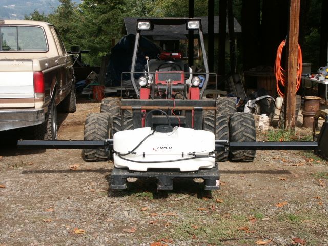

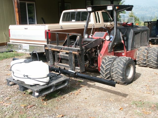

I have a similar setup (I have spray arms as well as the wand). A few notes.
I have the stronger motor version (I think it is a 3.5gpm) It sprays a tight stream from the wand maybe 20 feet max. I added hose when I bought it (I have 2 wands working now).
Fimco is OK. If I did this for a living I would not purchase the unit, but it does well for residential. As you are not looking for the spray bar version I won't do more than say it is moderate in quality and ability.
We have 20 fruit trees or so. We do not spray but we aren't too buggy here. Spraying is a decision you have to make for yourself. We felt that we are not selling the fruit, so if we have a 60% loss we still have a TON of apples and cherries for 2 people.
Spray only in the early AM or late at night when the winds are down. Evening is better for us do to dew in the AM.
The 12 volt motor does pull some amps. If you have a weak electrical system think twice.
I hope this helps a bit
