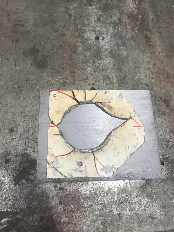

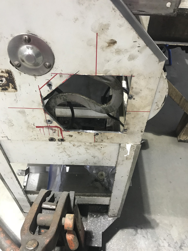

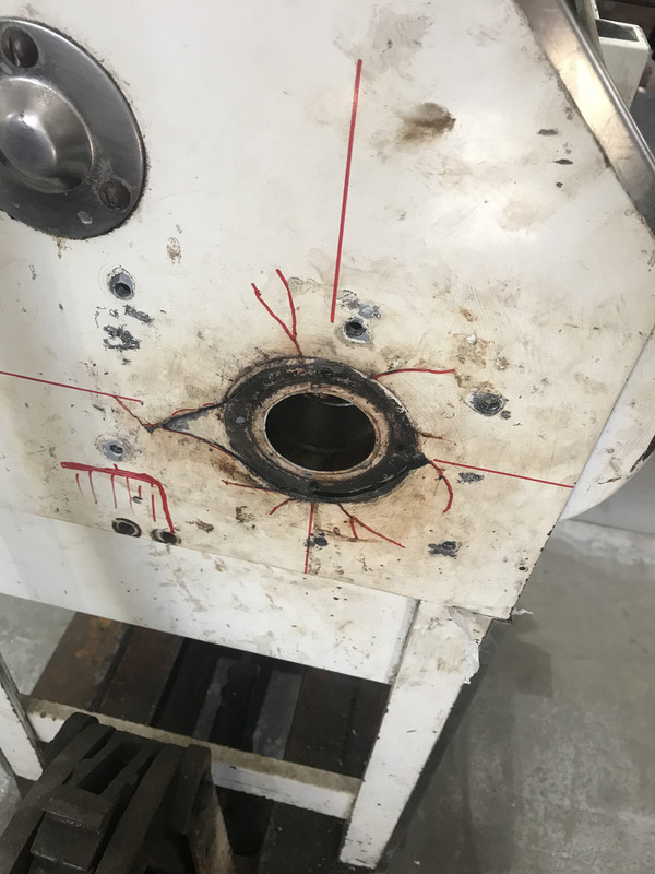

Oliver bread slicer rehab for a friend
It shook it self to pieces. First identifying all the cracks and then cutting out the damaged area:
Removing rear housing and bearings where offset shaft runs

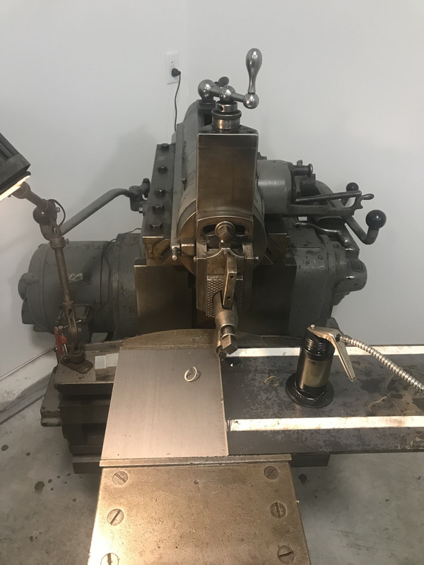

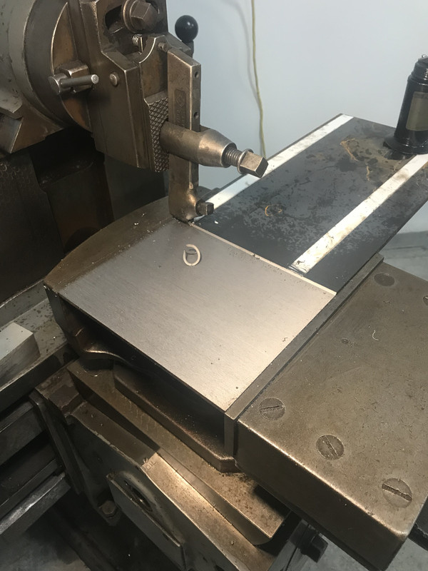

I’ve been scrounging for some 3/16 inch plate but haven’t found any therefore decided to finally just cut down some quarter inch plate using the shaper
Roughing cutter, single pass after flattening it out. Even with roughing cutter it leaves a good finish
Getting ready for layout
Video of shaper cutting
Hendy 12? universal shaper - YouTube

Haven’t seen a shaper used in decades. My dad had a Smith & Mills bull wheel shaper, and a Cinci hydraulic one later. He had a couple of Hendy lathes.
/ Oliver of a different type
I like them for this task (big flat facing.) Let it cut and I go do something else.
/ Oliver of a different type #5
We used to use them to cut profiles, moving the clapper box up or down, chasing the line. Lots of squaring up stock, sometimes slots. Lot of memories there. Never seen a Hendy shaper, only lathes. That machine looks to be in great shape, did you have to restore it?
Nope, came like that, I got lucky
It is the Cadillac of their (and all) 12 shapers
Auto feed on table and clapper, universal table so vise tilts, spins and rotates
I have some internal squares to cut, I don稚 have the shaper tool that accepts the bar to do this so I have to make that first

Cut to fit now to cut hole and weld in eccentric bearing stock

I will cut the hole and weld in the eccentric bearing holder this weekend after a trial cut on the cnc

Yep, 2500$ to replace with a used one. I don’t know much about them but I guess this is a good one
Trial cut on wood then cut the hole for bearing holder on bread slicer
#12
Fit eccentric holder then weld, pressed in crank and bearings, clamp in frame and weld.
A bit more finish work and some reinforcement and it should be set to slice for another 30 yrs.
