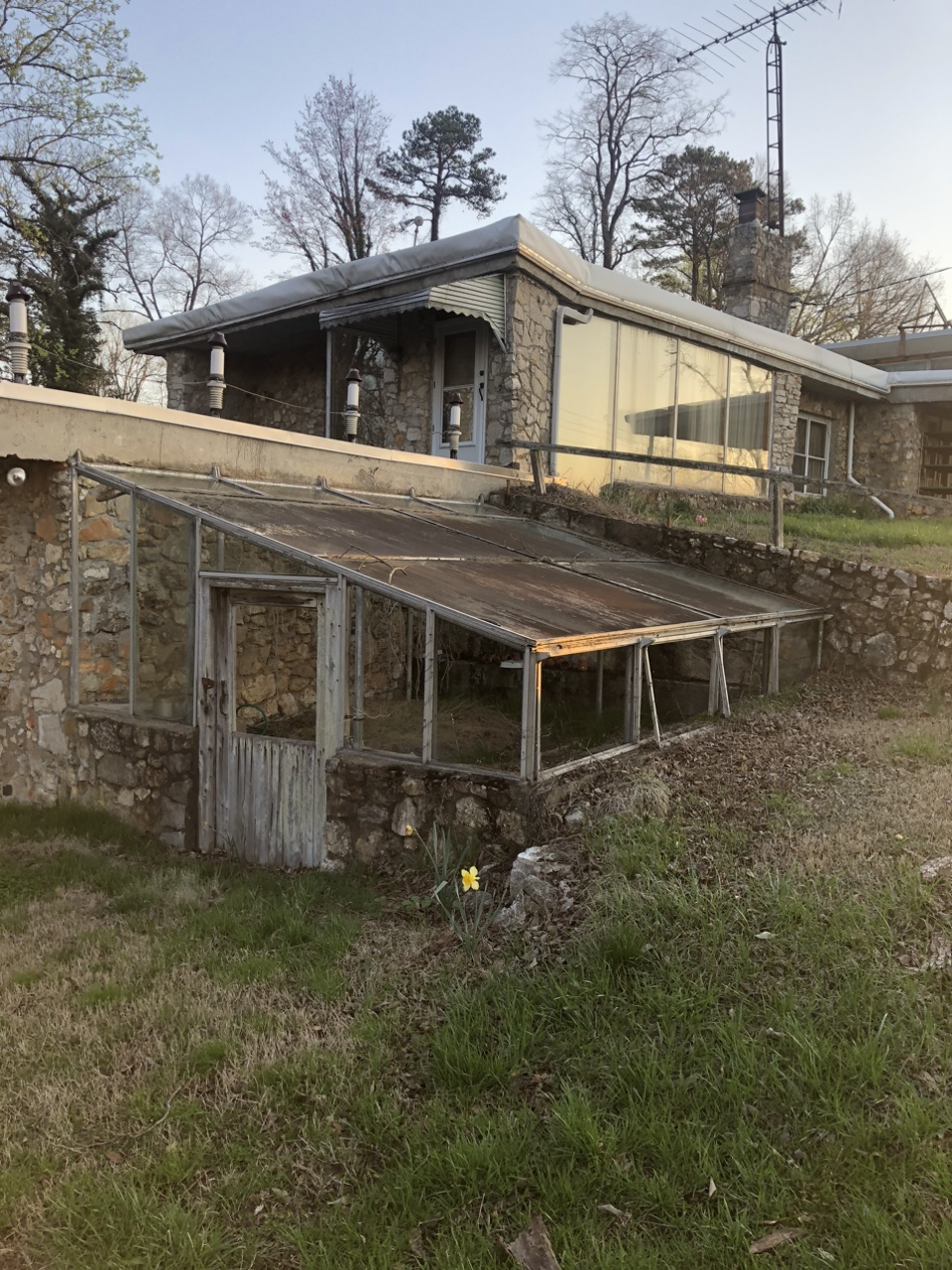

Most of greenhouse roof and window walls made from 3/8” tempered glass. They were from a company that used glass for forms to make optical grade plexiglass. Greenhouse framing 2” pipe with welded flat bar.

Looks like you get some heating help from your ground depth and the stone. Great ideas.

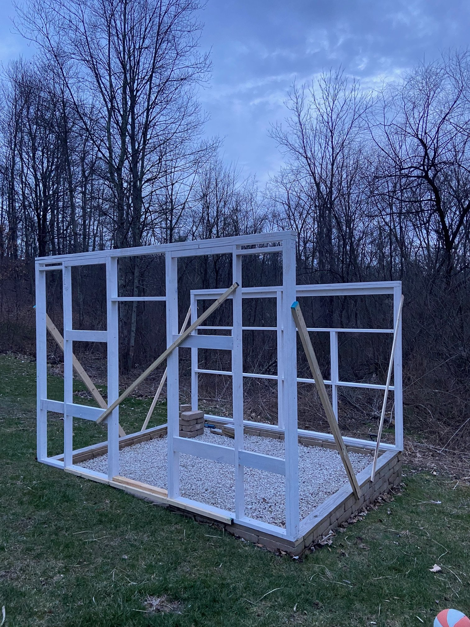

Finished the front and back walls. I am priming everything before I put it up. I plan on getting my 2x6s for the rafters this afternoon if the rain stops and spending the day tomorrow cutting and painting them.

Did this the first time I lucked up and found a house getting new windows and they were all the same size. I used treated wood. The smaller on was all sorts of windows framing it sorta sucked

I went with old windows for 2 reasons... 1. Its what my wife wanted and 2. Its what my wife wanted lol.
Realisticly, it just comes down to how cheap you can get windows. I have more of it complete but haven't posted a picture. I will get one up ASAP.

Looks like you have a good start. I strongly suggest that you put some galvanized 1/4 inch screen around the perimeter of the building.
Bury about 3 inches of it in the ground, all the way around. Bring it up high enough so you can staple it to the foundation 2x4's.
Other wise, you will be making a nice place for mice to live.

Actually the foundation is block and filled and back filled with 57 gravel. Even now there are no mice. Did have a carolina wren living in it this summer with the windows open but I liked having here there.
