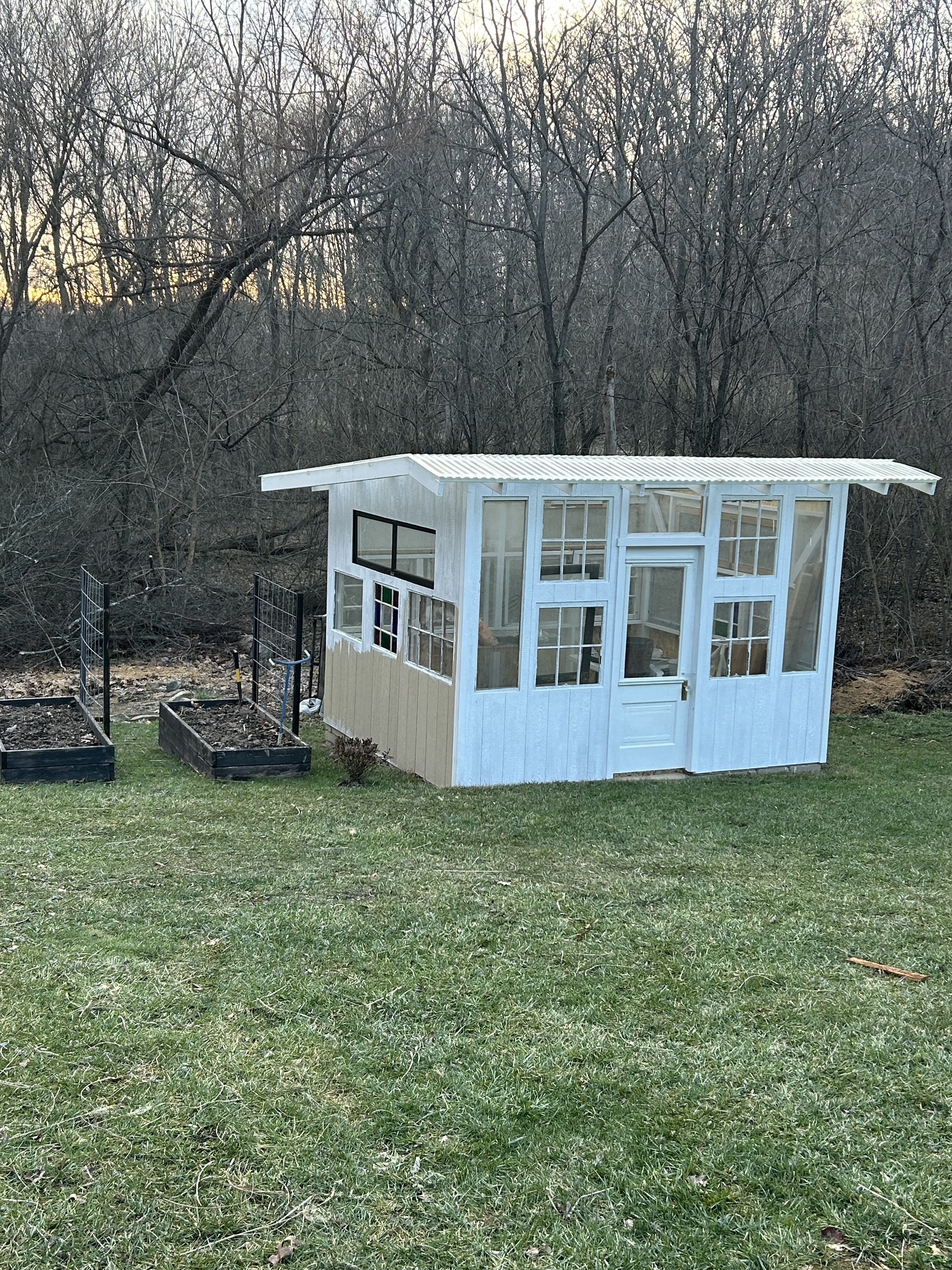

The free part is a big deal. So far, all the window are free and I bought most of the corrugated clear roofing on sale already. Lumber prices are not as bad as they were either.
It will be 10x12 and I do plan on making the overhangs for the roof more than a foot. Probably go 24" on center for the rafters but use 2x6. Have not decided yet how many windows I want to put on hinges for ventilation. I have even considered putting the roof on hinges since it will just be shed style. Maybe 8' tall on front and 6'6" on the back side.
She did want the windows all spaced out randomly but I think I have her talked out of that. Just a pain to frame that in an then finish it our nice.

Finished the front and back walls. I am priming everything before I put it up. I plan on getting my 2x6s for the rafters this afternoon if the rain stops and spending the day tomorrow cutting and painting them.

I went with old windows for 2 reasons... 1. Its what my wife wanted and 2. Its what my wife wanted lol.
Realisticly, it just comes down to how cheap you can get windows. I have more of it complete but haven't posted a picture. I will get one up ASAP.
/ Old Window Greenhouse #49
Looks like you have a good start. I strongly suggest that you put some galvanized 1/4 inch screen around the perimeter of the building.
Bury about 3 inches of it in the ground, all the way around. Bring it up high enough so you can staple it to the foundation 2x4's.
Other wise, you will be making a nice place for mice to live.

Actually the foundation is block and filled and back filled with 57 gravel. Even now there are no mice. Did have a carolina wren living in it this summer with the windows open but I liked having here there.
#51
Ran out of paint last fall and never got back to the job. The interior still needs done (paint, floor and tables) but my wife grew some starts in it last spring. Hopefully it will be in full production this spring.
