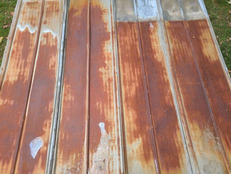

Any suggestions where I can buy that old style tin roofing that you see on old barns? Like in the picture, but new.
Thank you!

Good quality paint would stick nicely to that rust. I would not replace it for cosmetic reasons alone. I ripped off a pile to replace it with Cedar shakes and that was nice but twenty years later a big expensive mistake.

What are you looking to do? Replace because of rust? Replace damaged pieces? Add new pieces to match?
If it's just for appearance, they make aluminum colored roof coatings that will seal almost better than new.
Avoid the big box stores if you need to buy. They're at least double in price over metal roofing suppliers. You should be able to find a few near you.

So what do I need to paint my metal roof? I've read I need a primer...
I don't have any old paint and the rust is just surface rust, not flaking...

I had good luck with a brand called Henry. But I forget the type of paint I used. A few years ago, I painted another building with a different brand, it was "fibered". Turned out to be a huge mistake. Did not last a year. The Henry building is still looking good, must be five or six years now.
Most of those metal paints, the "silver" roofing type, are expensive, and you have to read how-long they last.
None of my buildings got primer, all are tin roofs, just the pressure washer.

I would use a high quality INDUSTRIAL enamel and an airless sprayer. I don't believe in PRIMER. I have been painting stuff a long time and never had an experience where I wished I had used PRIMER.
