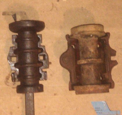

I believe I have this exact same disc, in nearly the same condition as yours. I was the victim of my own ignorance when I bought it. I'll never to my ending days understand seemingly honest and knowledgeable people who knowingly sell junk machinery to a novice person. Anyway the disc was made by the Love-Lift Inc. company in Michigan, and I'd like to know if you ever found a reasonable solution to your worn wooden bushings.
I feel like I've googled myself to death looking for some type of modern high wearing plastic (UHMW hollow rod) that would be a suitable alternative. I've found a few nearly the correct size, which I believe is 1 7/8" ID by 2 3/4 OD, but nothing just right. It's also very expensive in those large sizes (30-50 dollars per foot!) and you need 7" per housing.
As others have mentioned, there are bushings available through a company called WoodEx, but those aren't without issues as well. They are not the full 7" needed, but instead come as two 3.5" pieces. If you go this route you need to add two new press-in zerks to your housings and drill a hole through each new bushing. The zerk is then pressed through the housing and into the bushing, thereby preventing the bushing from turning and offering a way to grease the inner spool bearing-to-wood area. You then should seal the original hole to prevent dirt from entering. These are sold at 15 dollars per set of two 3.5" bushings. So, 120 bucks, plus shipping, and 16 new zerks and some significant time to refurbish the disc.
The other route I explored was new bearing spools (ribbed) and the housings from AgriSupply. Unfortunately they a quite expensive in the 7/8" axle format that this disc has. So I ruled that option out quite quickly.
I have not done it and am leaning towards just buying a new King Kutter from the farm and home store to get my food plots done. Please update this post if you found an inexpensive, ingenious solution!

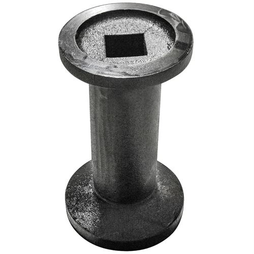

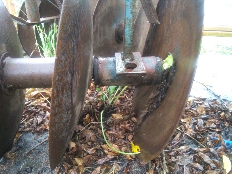

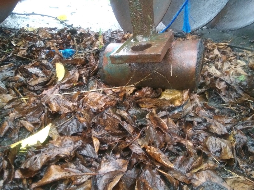

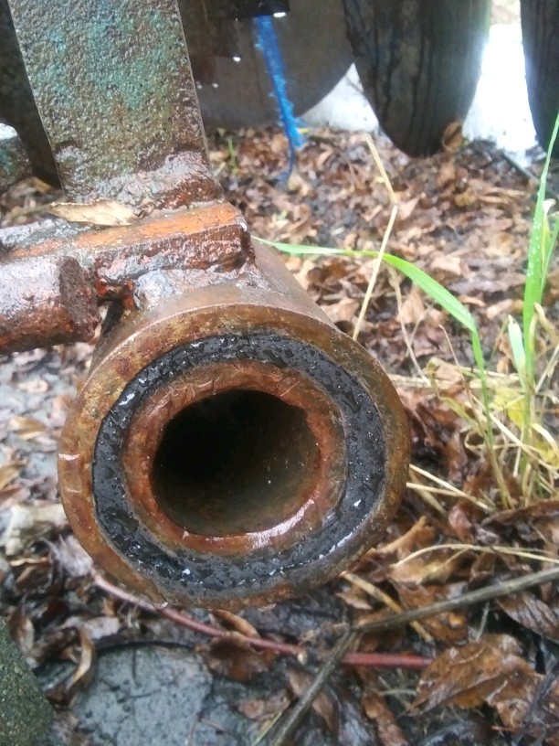

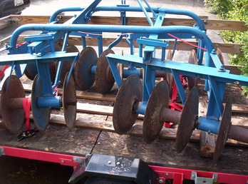

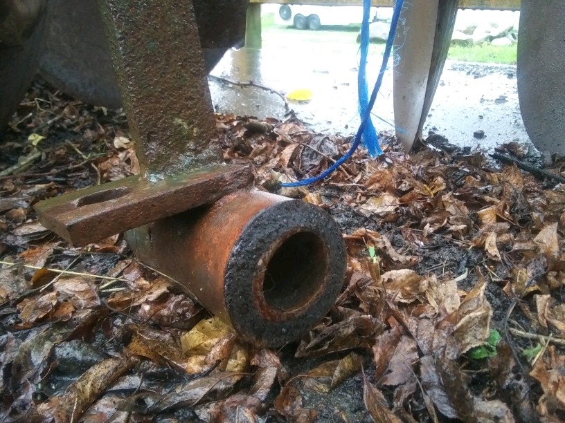

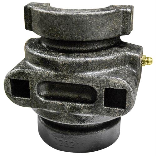

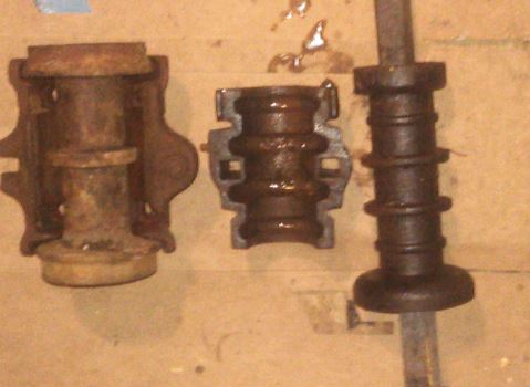

I am finally getting around to trying to repair the old "Love" disc that I got a few years ago. One thought I had was to replace the bearings and housings with spool type bearings. The square shaft is 1 1/8". I looked on the Agri-supply website and they have spools that are 1 1/8 inch, but don't seem to carry the half-bearing part in the 1 1/8" size. I haven't found anyone else who carries that size either. I am also wondering if it would be possible to repair the disc by finding bearing that would fit in the original bearing housings, though am not sure how they would be held in the housing. It has wood bearings at the moment.
I was wondering if anyone might have some ideas on how to get the disc operational again. I was also wondering if someone could tell me what a half-bearing spacer is and how it is used.
I am attaching photos of the disc again, and also photos from the Agi-Supply website of a half-bearing spacer (1 1/8"), bearing spool (1 1/8"), and half-bearing (1").
Thanks in advance.

The shaft is square (other than where is has been rounded by the discs after it seized up). It runs through a round pipe that is on the inside of the bearing. I am not sure if this is how the disc was made or not, though I have not seen wood bearings that are square on the inside. So far, I have not been able to remove the one bearing I have tried to remove. I have tried to pound out the pipe in the middle, but cannot get anything to move. Might have to resort to a cutting torch.

Agi-Supply does not seem to have the outer part of the bearing that goes around the spool for a 1 1/8" shaft, and that is the size I am trying to find. I also am not sure if there may be another sort of bearing that would work. Just looking for some information and ideas from someone more experienced than I am, as this is the only disc I have tried to replace bearings on.
