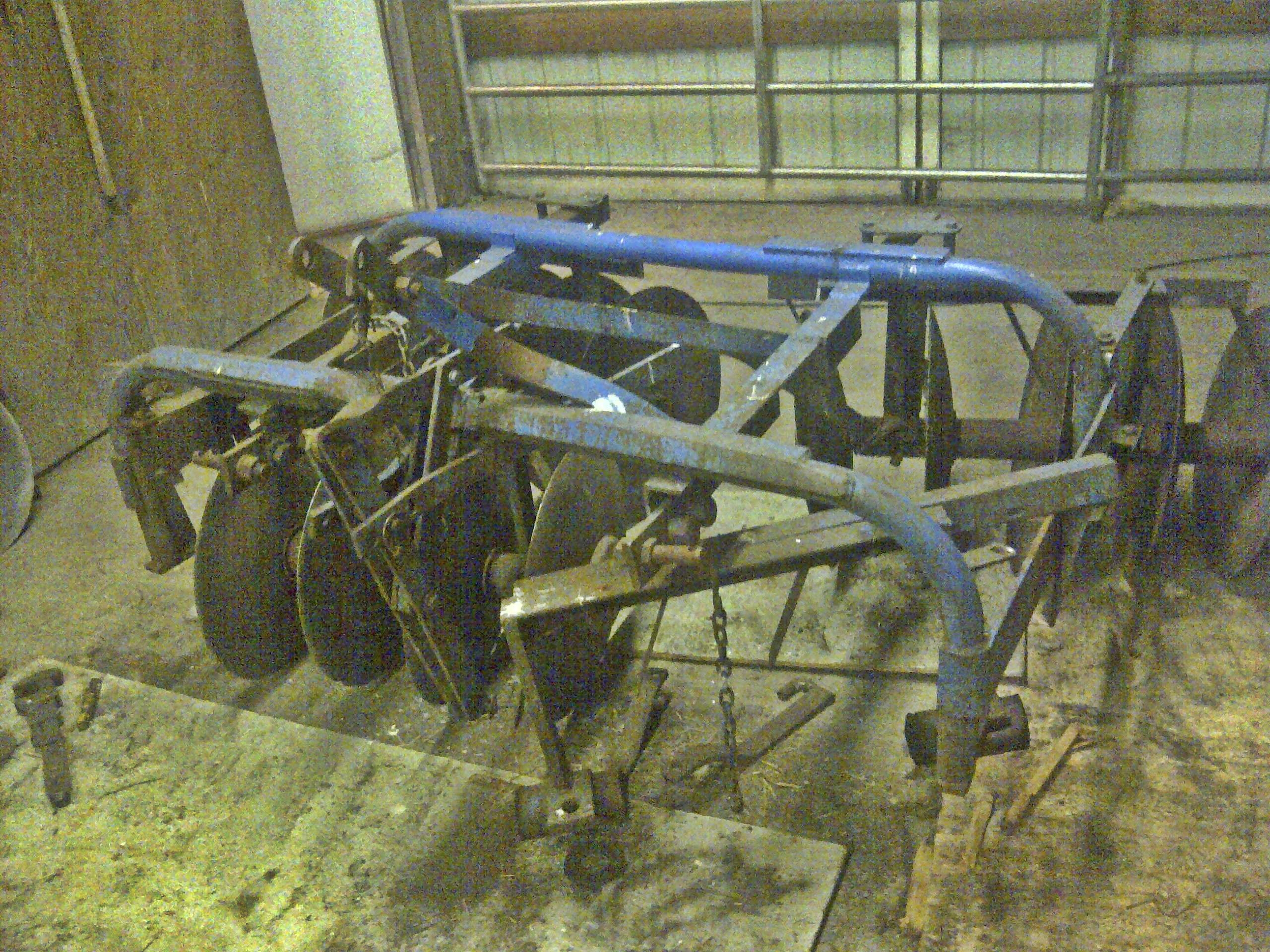

Hi. I am trying to repair an old disc I acquired. The disc axles go through two housings that seem as though they should have a bearing, though there is no bearing, just some sort of liner of unknown material. The housing and the liner are round, though the axle is square. Any information on how this works would be much appreciated. I am attaching some photos.
Square gangs with round hole bearings is not terribly unusual. Deere has done it for decades on tandem discs. Yours kind of looks farmerized. If really wanting to repair I would go with 1 1/8 sq gang (this will give you a huge selection of disc blades, and there are also lots of companies that will put whatever hole size you want in a disc), from there the round hole bearing simply rides on a piece of pipe that matches the appropriate disc spacing in relationship to bearing location (the act of tightening the gang is what keeps the pipe from wearing on the gang). Steel bearing flanges can simply be bolted to your original standards (looks like you have enough material). I have also spoken to many an individual over the years with a really hard chunk of plastic/rubber insisting it is some form of a bearing or seal, when in reality it was just twine (or something similar) that got wrapped up in there and over the years of getting hot, then cold, then hot, etc, eventually this wad of twine (that we all know can snake its way into anything) now really really resembles a manufactured part when it is really just molded plastic from its environment. And as another mentioned chemically soaked wood was used many moons ago for bearings. If you wanted to see some parts images of sq gang w/ rd brgs look at Deere tandems like say a 230-235 disc. Then again it may be more work and cost than the old girl is worth and might just look for another unit. Good luck

Thanks for the information and advice. The rubber looking material is in all of the housings that the disc axles run through, so it must be there on purpose. I have not had the time to get into trying to get it out of the housing yet. It was missing a disc, and that is what started the process of taking it apart. For $350.00, I guess I should not have expected much. I bought it sight unseen, and the frame broke within the first 10 feet I pulled it. The ad had said it was ready to work. I did actually use it with the one missing disc. It was certainly better than no disc at all. Still hoping to try to fix it.

The rubber looking material could be greased soaked wood. There is a metal tube inside of the material, that runs through the housing. This is what the axle was riding inside of.
/ old disc repair #24
looks like a homemade bearing. with a liner and huge amount of grease . If it were mine I would make new hangers and put a real bearing in it . the issue will be finding the right spacers for each side of the bearing. Square shafts are the standard on these type of disc.

The metal pipe could be in there to maintain the spacing when you tighten down on the gang bolts (they have to be really tight). Without the pipe you would just be compressing the wood insert and you would never be able to keep it tight, the disks would start to wobble and/or rub on the frame.
If it is s Dearborn disk there are usually part numbers on the back side of the housings near the grease fittings.
Take a good clear picture of an individual bearing assembly front and back, showing how it attaches to the hanger that connects to the frame. Also measure the spacing between adjacent disks. Check them all, at least the ones where the gang bolts are tight; are they all the same, like maybe 6.5 or 7 inches. Let us know what you find.
It's a shame, the blades look in good shape, it looks like it has scrapers, nothing bent up. Maybe you'll luck out and can just slap it back together with a lot of grease. If the bearings are in fact wood and they are just cylindrical with no grooves it seems it would be easy to make up new ones from a hardwood. Good luck.

Several people have mentioned AgriSupply; they are probably the quickest, least expensive way to go. You can buy the entire bearing housing and spool for $18.00 plus shipping; it may take a little fabricating you will be ready to go. I have an old Dearborne harrow which I have fixed this way. At the time I could have bought the correct parts, but they were quite pricey.

Here are some pictures of parts for my harrow. This onebearing3.JPG shows both my old and new bearings, the corresponding spools; along with the shaft which goes through them. There also is another half of each housing. ThisBearing2.JPG shows the new bearing and spool separately. The third picture Bearing1.JPG shows each bearing and spool together. The one on the right is the original, which had a wooden bushing between the two pieces of metal. (I tried to find the old wooden bushing, but must have gotten tired of looking at it and tossed it.)
That is exactly why the metal pipe is there to allow tightening of the gang and to allow the assembly to spin as an assembly. In tough conditions if the gang is loose it will break the centers out of the discs. As a side note there isn't a single disc retailer that will warranty a disc blade that has a broken center, they will blame it on a loose gang every time.

Thanks for the information. Would it be accurate to say that the entire wood and metal pipe assembly supposed to spin in the housing then? At the moment it does not move.

If you can buy all 3 pieces for $18 (is that a current price?) it is certainly worth looking into. Just be sure the width of the spools is the same as the current spacers that are on the disk. Also be sure that the square center hole is the same size as your axle and the disk blade centers. Then you can fabricate a bracket that will bolt to the top bearing half and weld/bolt it to the harrow frame.
