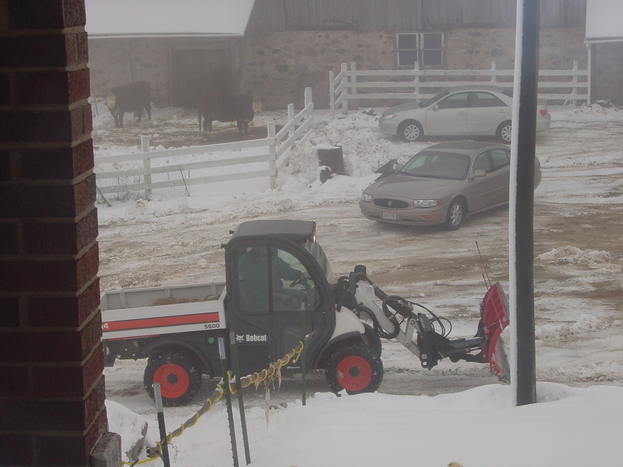

This is what I use out at the Farm.
Sometimes I need the neighbor's 200+ hp tractor to pull me out when I get stuck.
This only happens when I go to where I should not be in the first place.
I am learning...

Someday it would be nice if you would tell us about that stone barn in your pic. How old is it?, built with slip forms?, etc?

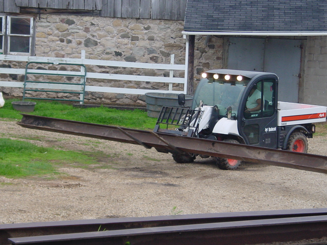

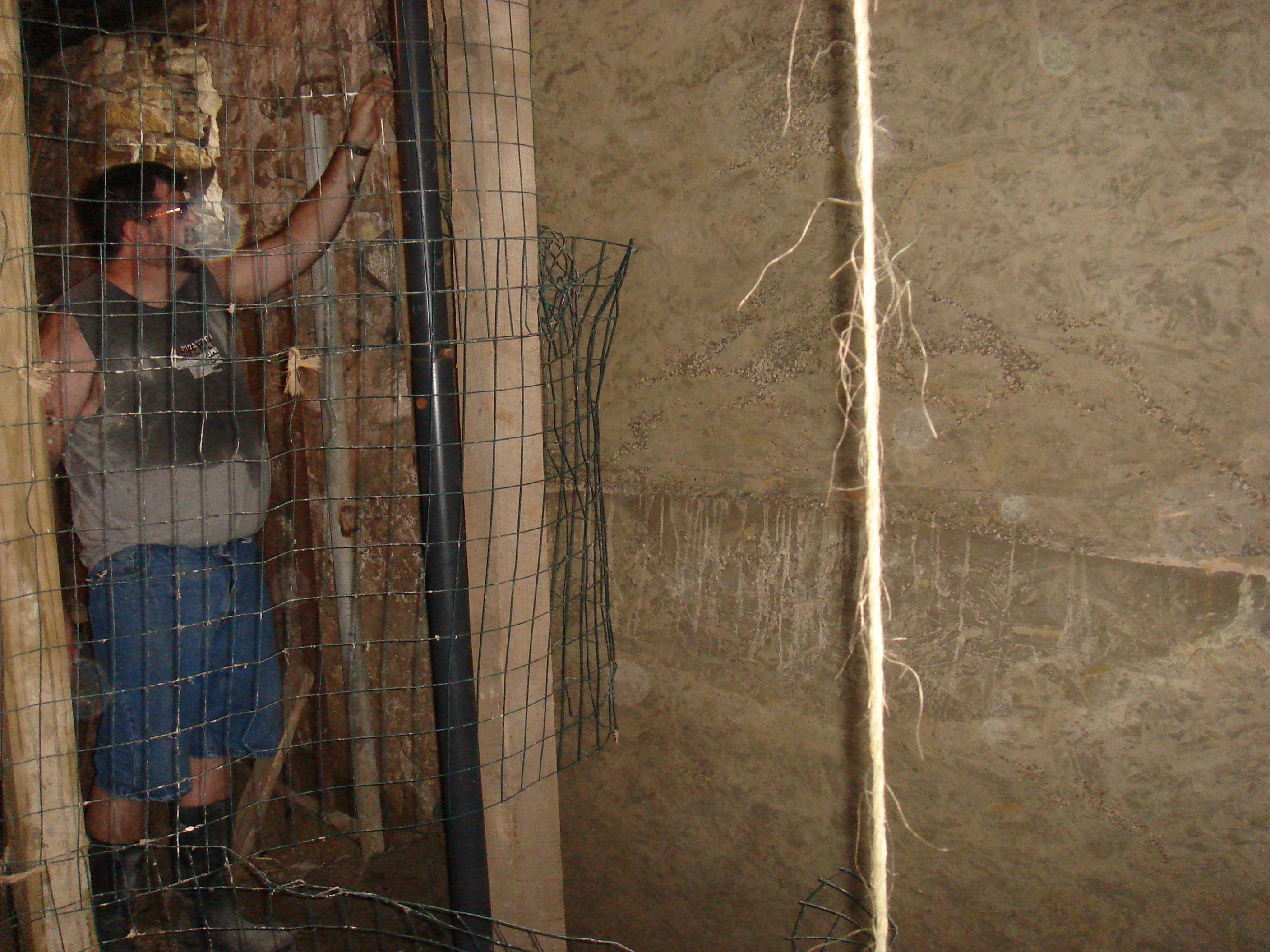

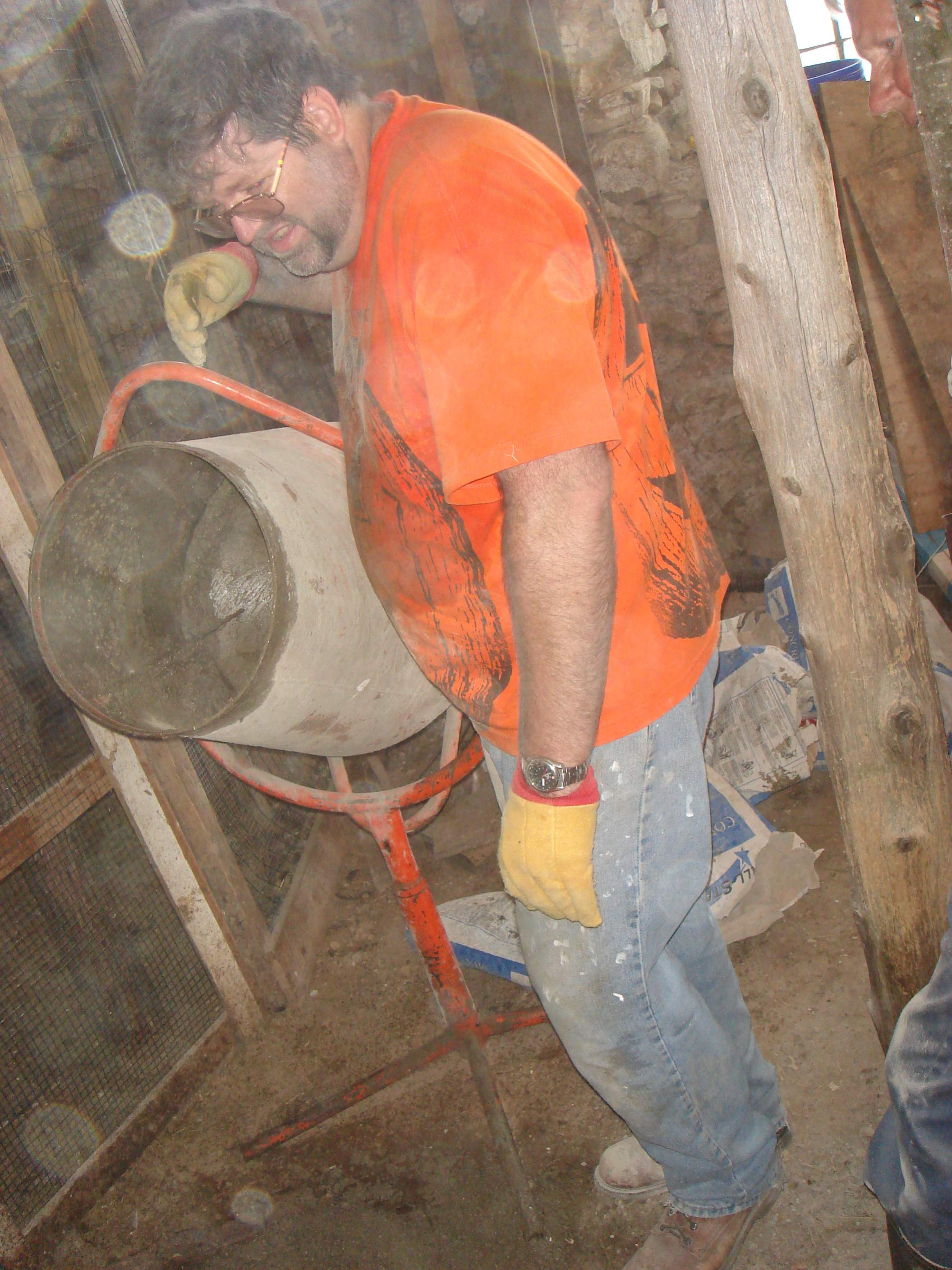

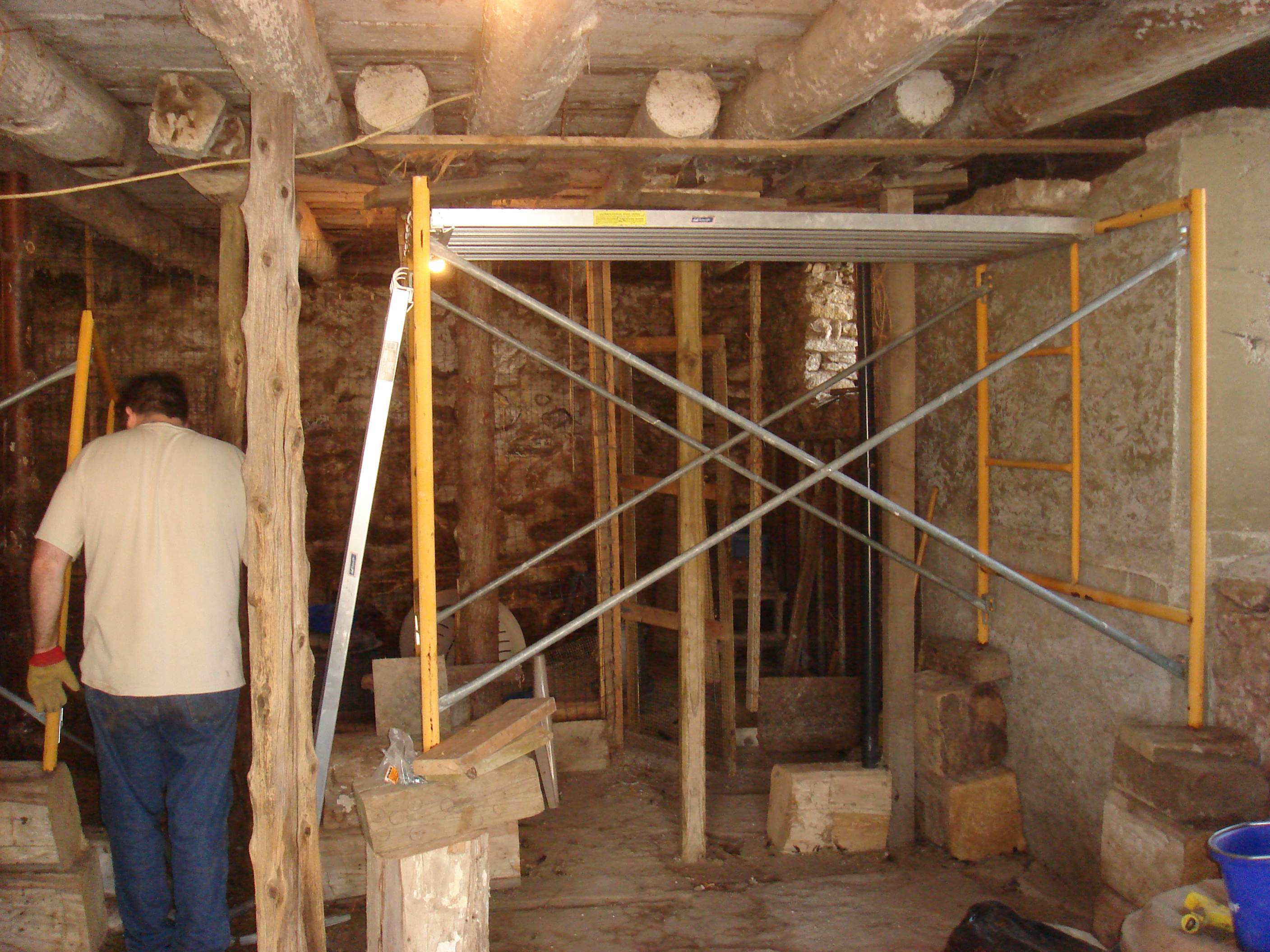

Here are just a few pics of the steel and concrete reinforcement.
The beams are used W10 x 68 x 30' - 2,000# each & substantial. Used to relocate houses.
Had to remove the old wood girder and replace with a structural steel girder. Cut a hole in the wall to shove the new beam in.
Made a new reinforced concrete pillaster at the wall (last pic), and new reinforced concrete piers and footings inside.
Used treated utility poles made the columns.
Pretty economical and stronger than ever. No charge for the engineering or labor.

Thanks for the pics. That was quite a job! Sounds like you made a good 'save' of the building. Those Toolcats look like something with lots of uses too.

What mfg plow do you have on the Bobcat? Does it float +/- a few degrees in up/down left right diretions or is it hard fixed?
