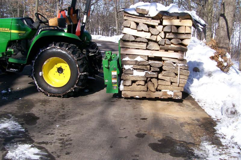

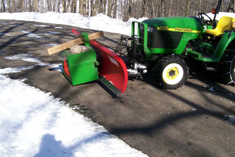

I've the 4300, and I think you are making a good choice...reasonable for the moment, and won't lose value in your future upgrades. :)
As to the lift on the 3 ph, here is a double stack of ash firewood, that I had to counter weight the snowblade on the front to keep the front end down. I think you will be happy with it. And the HST is great.
