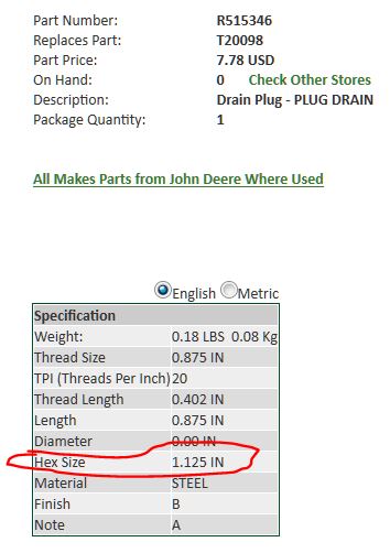

i have a 1966? jd 1020. it has a oil pan drain plug like i have not seen before. it looks like a 8 sided allen wrench around 9/16. it looks original. has anybody seen this.

I doubt it is original but you should be able to buy a socket to fit easy enough. Somewhere in the last 48 years somebody lost the plug and put this one in.
/ oil pan drain plug #4
Actually, the plug is probably original. It is eight sided because it is a double square. Try your 1/2" ratchet or breaker bar. I am betting it will work.
/ oil pan drain plug #5
Here's the oil pan plug spec's. Note the part outlined in red.
