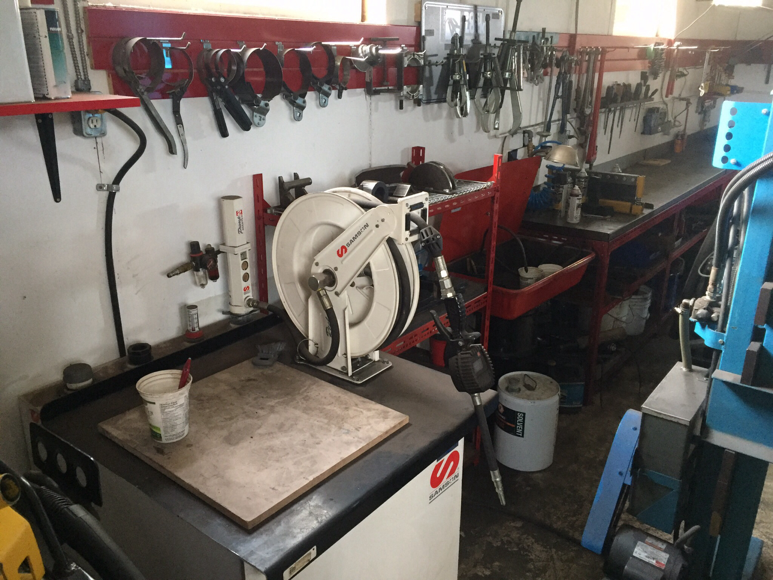

I've tried everything known to man I have them hanging everywhere and here is what I find works best for my needs. There are some things you can't get them on but it will do 90% of the cars, mowers etc. I have owned.
Those are identical to the HF pliers at likely 1/3 the price of Gemplers

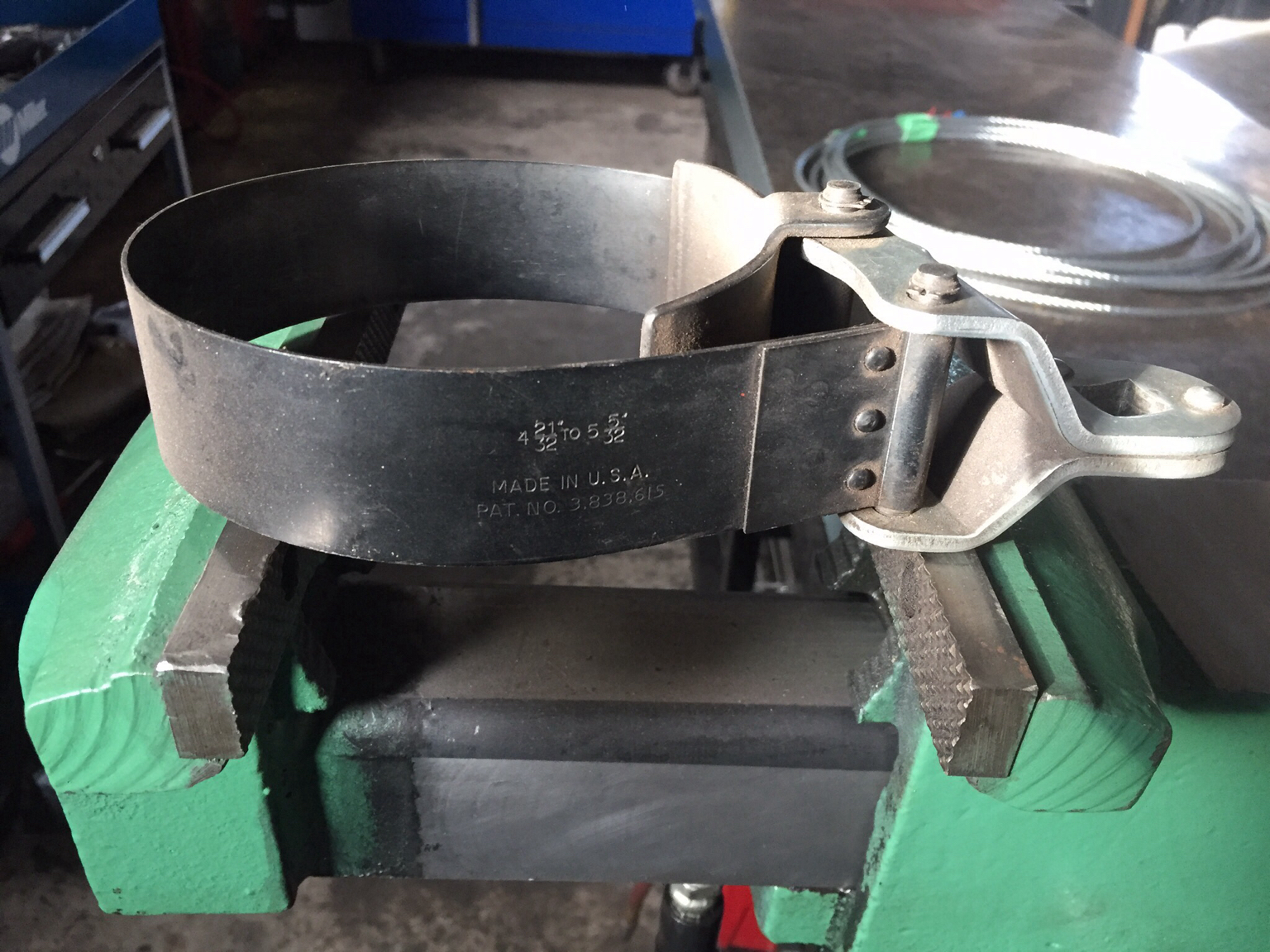

I didn't notice anyone mention this style. My apologies if they have...
They utilize a square drive ratchet with an extension if needed. I have five size/ranges which covers most of the filters I use.
