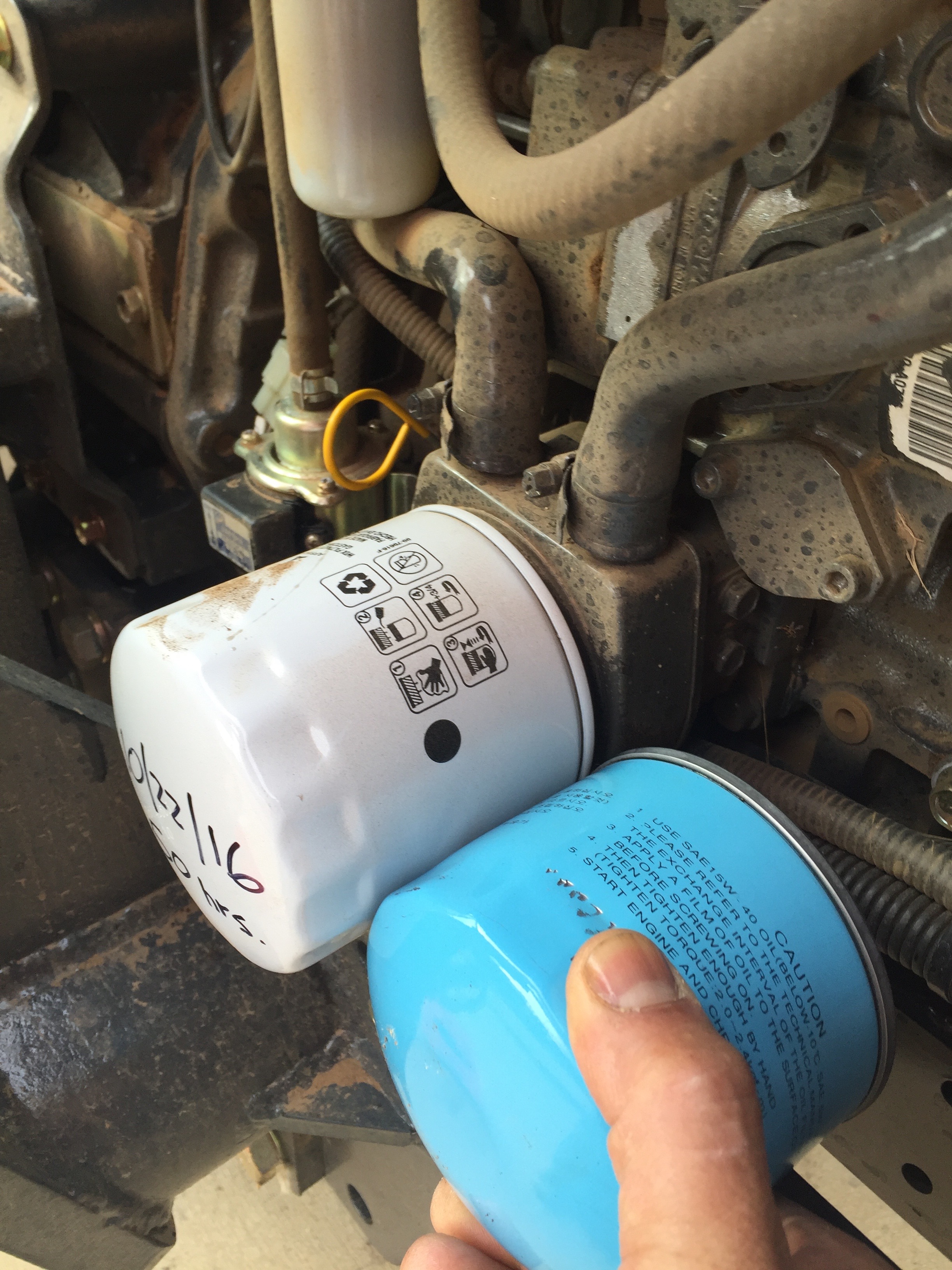

As promised (a fairly long time ago) here is a photo of the stock oil filter for my Branson 3520H on the left and a replacement filter (Wix 51626) on the right. I installed the replacement in a pinch until I got the stock replacement filter.
Besides the replacement filter being larger I didn't see any appreciable difference in their construction.

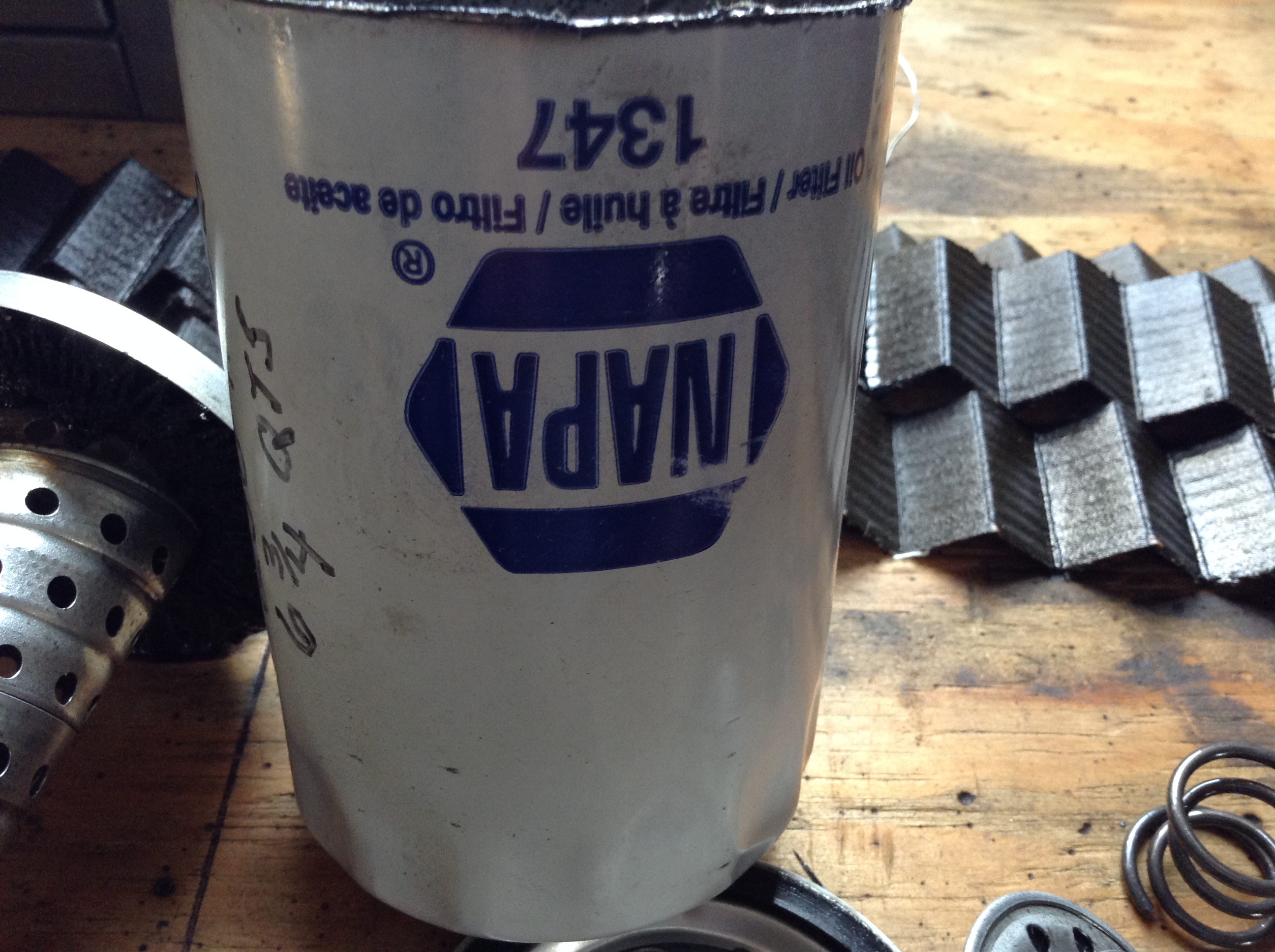

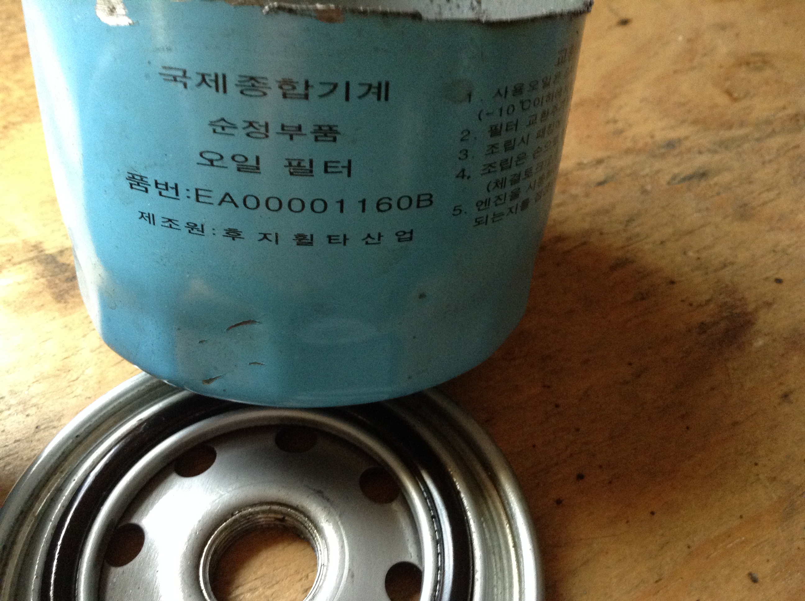

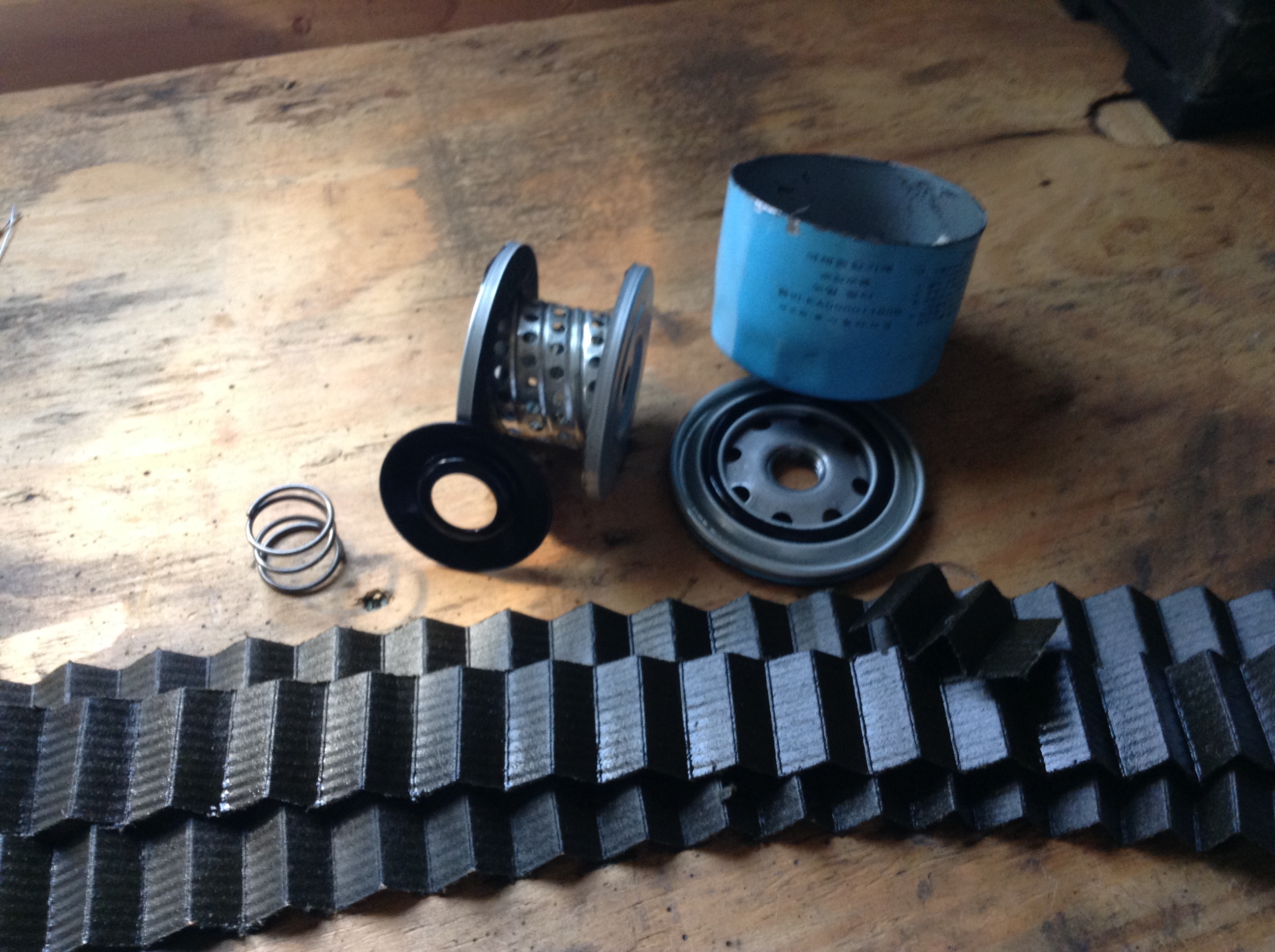

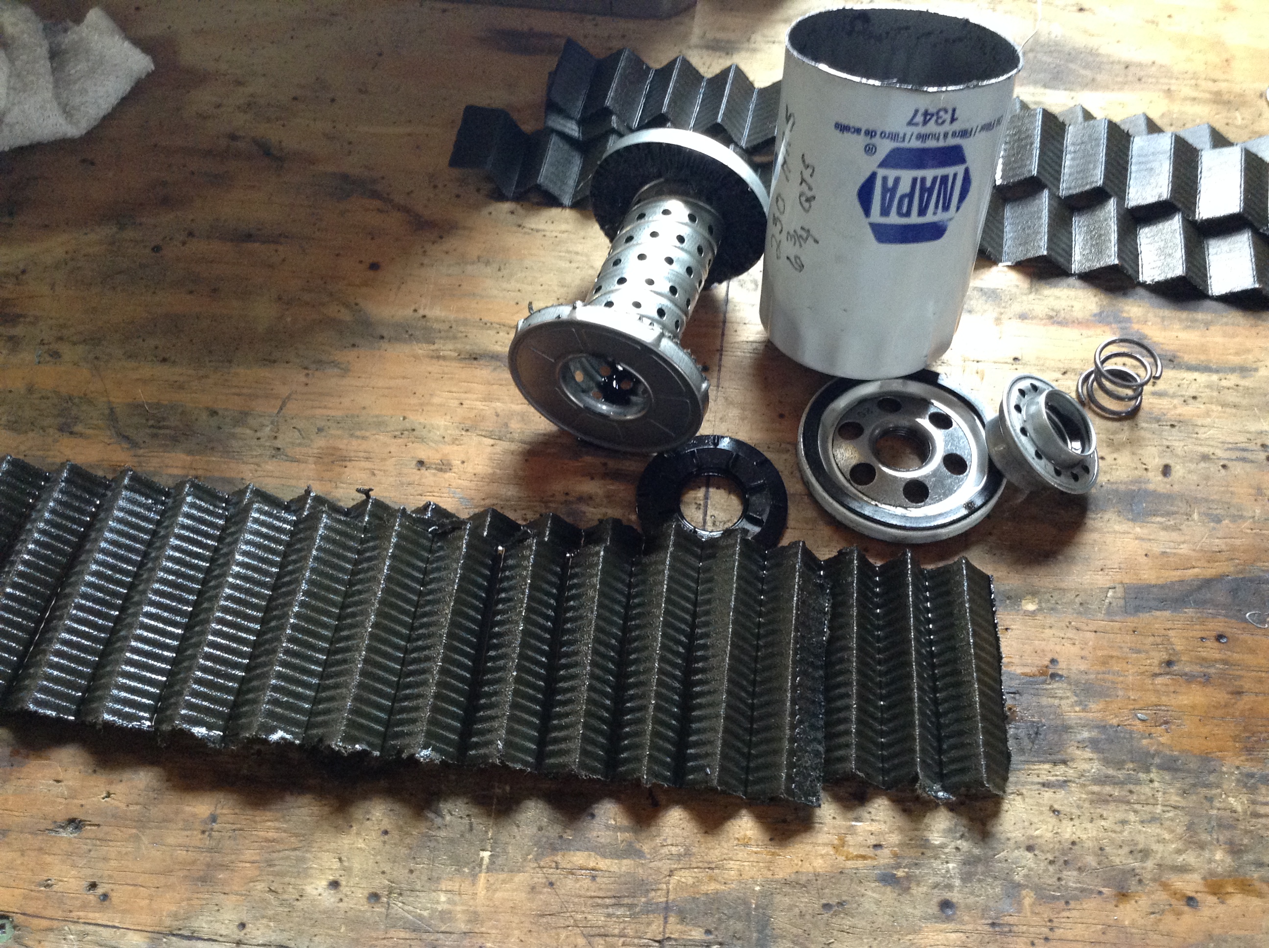

Here is a maybe little helpful info on a filter some Branson owners use. A Branson EA00001160B vs a NAPA 1347.
Filter media for Branson was 2" X 97" = 194 sq inches
Filter media for Napa was 3.75" X 61" = 228 3/4 sq inches
Now I'm not a filter expert nor do I really know anything about the, other than they filter oil but here is my observation on what I seen and you can judge by the pictures below as much as you can tell by them.
The media seemed pretty much the same maybe just a little thicker in the Napa filter. The spring in both seem to take about the same amount of force to compress. Both canisters along with the ends were very close to the same thickness and quality. As far as the rubber valve I guessing is part of the bypass the Napa one was what seem to me as a better constructed. The only other thing is the Napa had another round thing with a spring and rubber ring as seen in the picture and I have no idea what it is. Maybe some one with better knowledge can shed light on it.
