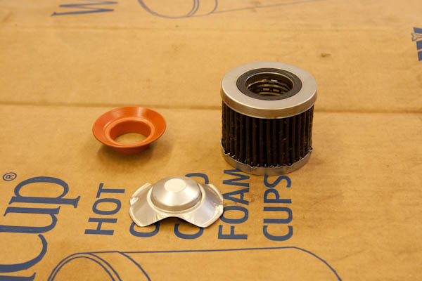

What I've heard happens is companies like Fram cheap out. They just rely on the engines own bypass valve to work when needed and will use a filter that doesn't have the correct bypass valve. If you look at this picture from mike.
The sheet metal spring in that picture is the pressure relief valve. That filter's bypass is only designed to work in one direction. Oil must flow into the center of the filter.

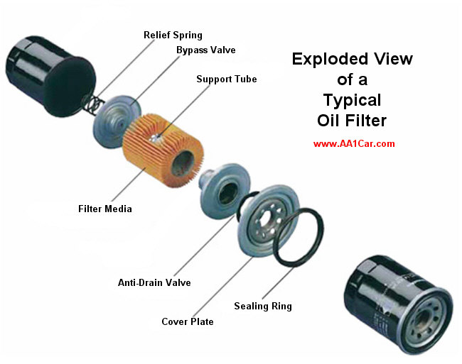

In the second picture is a bypass valve that will work with oil flowing in both directions.
Lots of ifs here but if your engine had an internal oil bypass valve and Fram cheaped out and spec'd a filter that didn't have the 2 way bypass valve then your engine was doomed once the internal valve failed. If your Fram filter did have a back up two way bypass valve and both failed, that's bad luck. If your engine didn't have an internal bypass valve then clearly the Fram filter failed you.
The sheet metal spring is just for assembly, to hold against the bottom. The bypass is in the bottom. I think that the sheet metal spring over time will collapse and allow the filter to bypass. I have taken them off and heard them rattle. I think it is a poor design.

To reduce the price Fram just combined the bypass valve and spring into one plate so they didn't need the coil spring.
