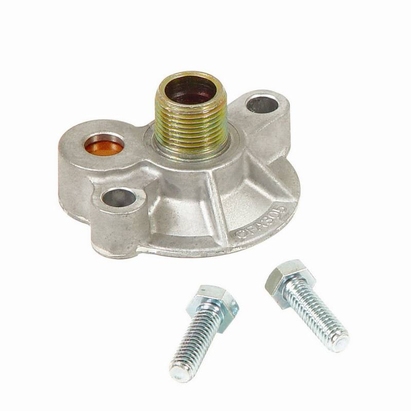

The Kubota guy needs a little more information before he should put out videos. First it is completely misunderstood that the oil goes through the filter each time it cycles. There is no way that 50 or 60 psi oil pressure is going to make it through that filter in enough quantity to lube the engine and it's not designed that way. In the image that I attached you can see a round plug. The filter bypass spring is under that plug. All are not in the filter housing but there is one somewhere. They are normally set to 3 to 5 psi. All the rest of the oil bypasses the filter by design. It takes many cycles of the oil for it all to pass through the filter. The spring inside the filter is mostly there in case the filter comes completely plugged. Next is the micron rating. I notice there is no talk about nominal or absolute. When I bought my new RAM Cummins pickup I thought the fuel filter from the dealer was a bit much. They are at a very low micron rating. I emailed every company I could find thst made fuel filters for it and asked if their micron rating was nominal or absolute. Most did not bother to even answer. Some answered nominal and only Baldwin and another (can't remember) was absolute. Allow me to exaggerate like crazy so that everybody understands what nominal means. Let's say that you took chicken wire and filtered oil through it. Then with magnification you could see that some 50 micron particles collected on the wire. You could then say that your filter is 50 micron. Of course that's a gross exaggeration. Absolute on the other had means what it says. It is a question that many filter companies don't want to answer. The Cummins filter I talked about is very fine 4 or 5 micron. Baldwin said outright that their filter was no finer than the factor spec. It did have more holding capacity to catch crap.

100% of the oil that passes through the relief valve of a full flow oil system returns directly to the sump. 100% of the oil circulated through the engine components of a full flow system has passed through the filter.
Filters with an internal bypass are a different story, not all engine oil filters have bypass valves. Those valves allow oil to pass through the filter but not the filter media. In filter bypass valves typically open only when the oil is very cold and viscous or the media is plugged.
