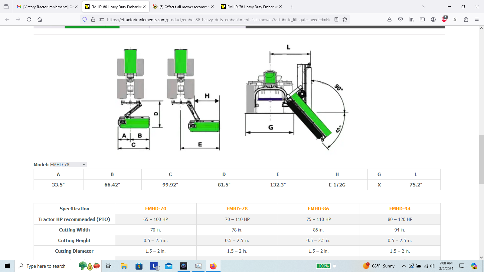

I have a 78" ditch bank flail it is the maximum for my Branson 8050 that tips the scales at over 11,000 pounds, that mower can give a person some pretty good pucker moments.

I wouldn't even recommend anything more then a 56" for a 4000 pound tractor and that may still be to much for your size tractor.

Lou - as I look at the pic you posted - the full 78 inches of the flail is offset - correct??
Just looking at that pic makes me pucker.

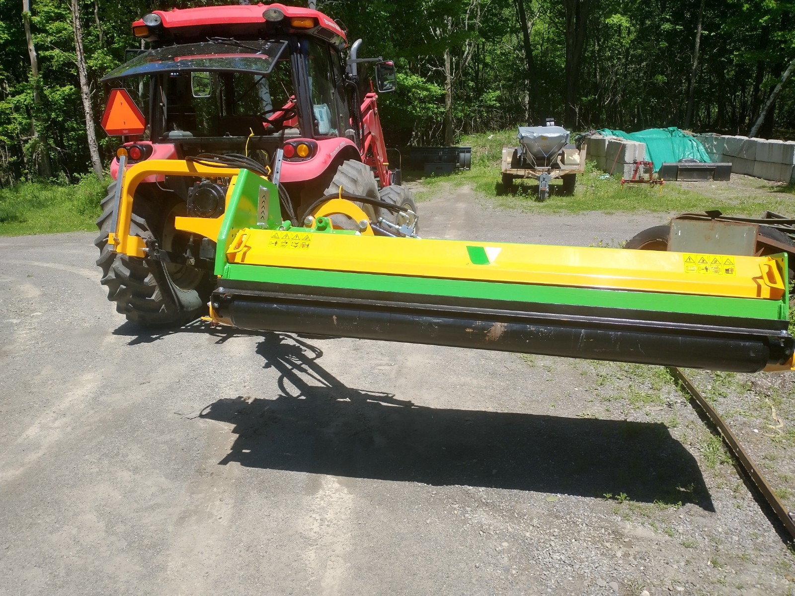

Yes, it can be, it will swing in behind the tractor and then out just a bit past the outside of the tires.
I can actually mow the full width of the mower outside the tires track. That has most of the mowers 1900 pounds off to the side of the tractor which will make her sway and bounce at times. when the mower is on flat fields and the rear roller is touching and supporting the mower it's not bad at all, but when holding the entire mower in the air when swung out over a bank it is a bit touchy.
To the original poster, the mower you listed the Nova BCRM 175 is lighter then my unit but your tractor is less then half the weight of mine with the mower at almost a 1000 pounds that is a lot of weight hanging off the side when it is in the air. I would say that the 155 with it's cutting width of 61"would be a better fit then the 68" of the 175 model but you don't have to extend the mower all the way out when working it.

I have this one on a 4000lb machine. Like Lou mentioned it rocks the tractor pretty good if extended in the air but is very manageable if one is aware.

The standard duty is likely a better choice for the lighter tractors with yours being 800 pounds compared to over 1900 for the heavy duty one like mine.

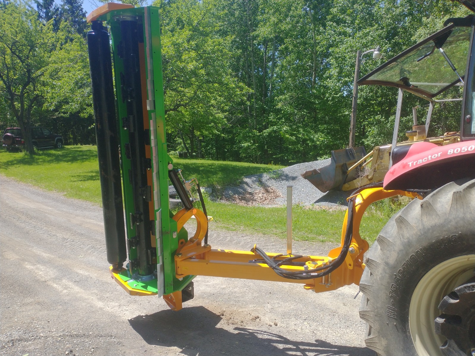

I have mowed with mine in the upright position. It does work a bit on the finer light stuff but heavier brush seems to bend over then spring past without getting clipped. At 45 degrees elevated for clipping the banks it does well;
this is about a 45 elevated mowing, ........................... this is about 45 down mowing the opposite bank

with it all the way up the geometry has the leading edge to far out from the hammers and much of what I'd like to be clipping doesn't get cut.
