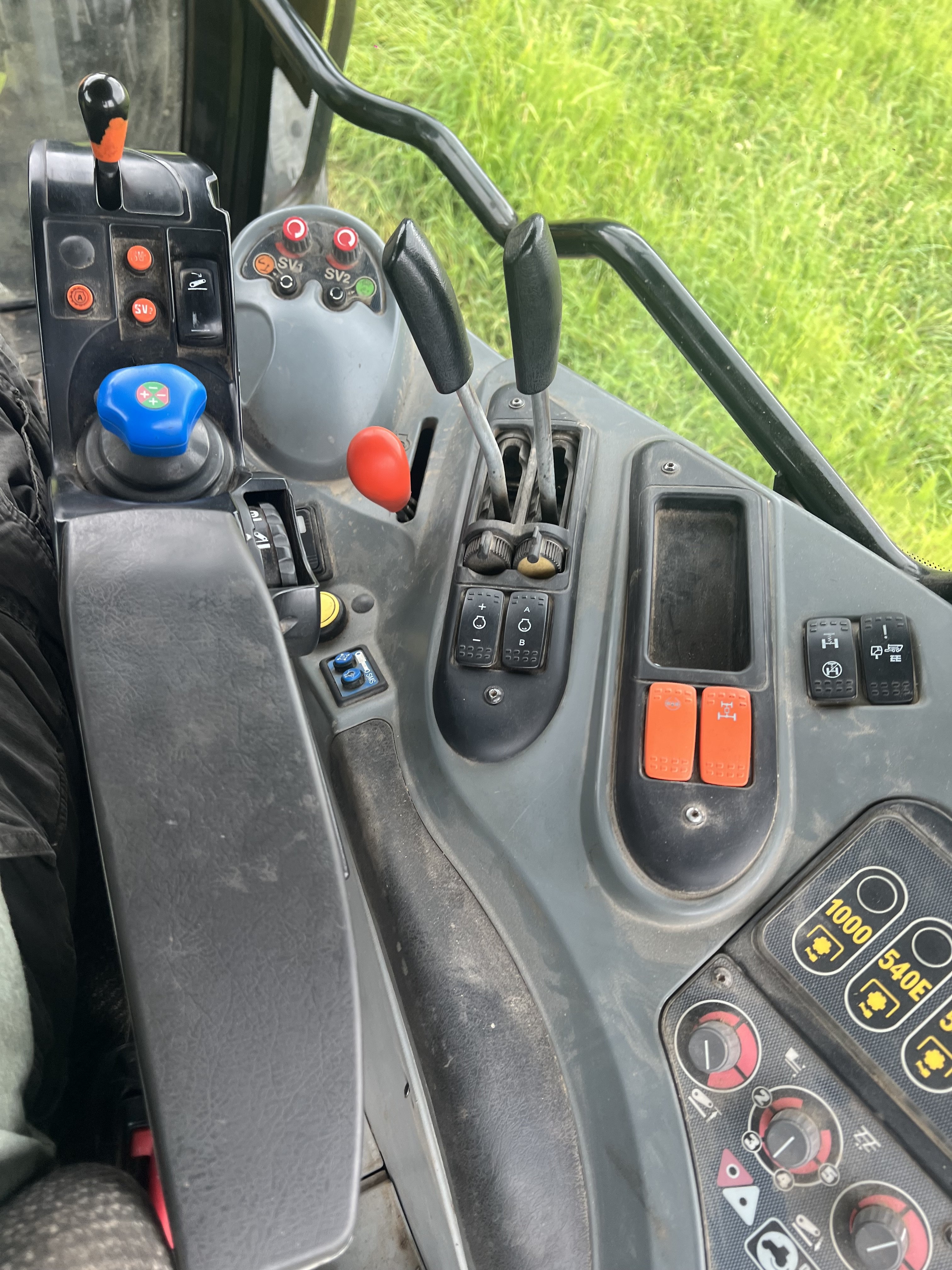

Here is the blue electronic joystick built into the armrest of my 13 year old AGCO Challenger. You can barely see the small black buttons that operate the 3rd & 4th functions on the loader on the sides of the blue joystick.
You can turn off the loader with the rear small blue button. This allows you to switch the joystick over to operating 2 of the remotes in the back of the tractor. The other 2 black levers operate the additional 3rd & 4th remotes in the back of the tractor.

I think some of you may be thinking of this incorrectly, or looking for a problem where a problem doesn’t exist.
From the cab of a Fendt/Massey/Challenger/AGCO equipped with a a factory joystick and loader and 4 remotes you can simply push a small button to “toggle” back and forth between the loader and the 2 remotes the loader it tied into. Also, the factory loader joystick is a double splitter (if you opt for it) joystick that enable to use 2 or 3 loader functions at once.
Then you are also given 2 straight up remotes with nothing tied to them you can use while using your loader.
So where’s the problem? 🤷‍♂️

Dude, relax. You can still do that. On your flex wing mower complaint: 2 of the remotes are available independently for the “wings”. For raising/lowering mower deck, you simply push a button in the cab to use the joystick to raise the more up/down.

You can run all loader functions without a diverter valve! SHM.
The reason for the diverter valve is to switch from the loader valves to the REAR remotes, not the loader functions. It makes the loader joystick into a set of rear remotes.
I run my loader with 3rd function grapple or hydraulic quick attach without switching anything.
Its not a “real head scratcher” its actually very logical.
Also, since you have (4) sets of remotes and 2 of them are not part of the armrest joystick, you have 2 sets of traditional remotes available at all times.
