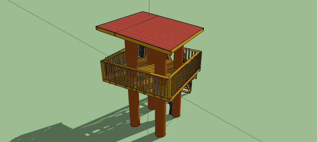

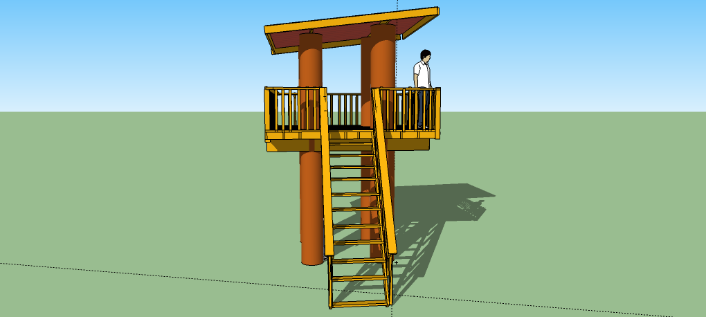

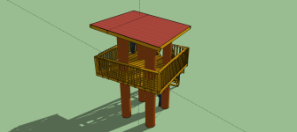

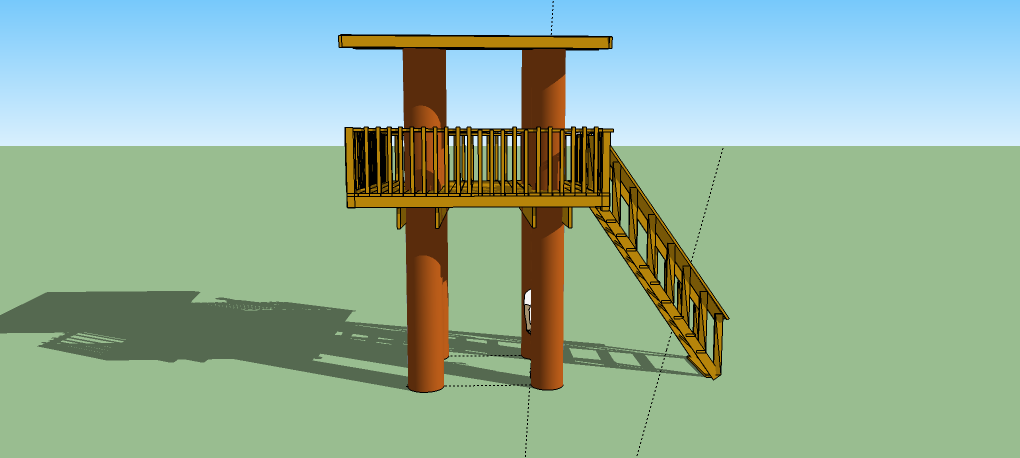

I'm building an observation deck for my motocross track and I wanted to run my ideas past everyone.
Here are the details. The deck will be about 8' off the ground and 12'x12' was going to be outside dimensions. For the legs I am using telephone poles (approx 11" in diameter) that are 20' long. They are buried 3' in the ground.
The holes for the poles are dug, but not set yet. The holes were dug with post hole diggers, so they aren't perfect. I was going to use cement to fill the voids. I know that some people don't like cementing in posts, should I just fill with dirt and compact?
For the beams I was going to use 2x12s sandwiched on each side of the telephone poles and then use 2x6s for the floor joists and decking.
I've attached a couple of images that I drew up in Google SketchUp. What do you think? Do I need to build anything stronger?

from experience I don't think 3' is near deep enough if the live load is 8" off the ground and there is any considerable dead load above that ...!
just gravel (with some fines) will work best to plum the poles...

That was a concern that I had as well. I was going to see how stable the platform is and add 2x6 x-bracing to the legs if it seems like it moves much.

Yup, I think so. The only thing keeping your design from folding worse than a house of cards is the lateral resistance of the part of the poles in the ground.
Imagine a force pushing sideways on the floor or any of the poles. What opposes it? Nothing but the resistance of the poles in the ground. The mechanical advantage (disadvantage?) given the length of the lever arm (part of the poles out of the ground) versus the little bit in the ground does not inspire confidence.
You need some triangularization (think gussets) to keep the first stiff wind after a soaking rain from folding it up.

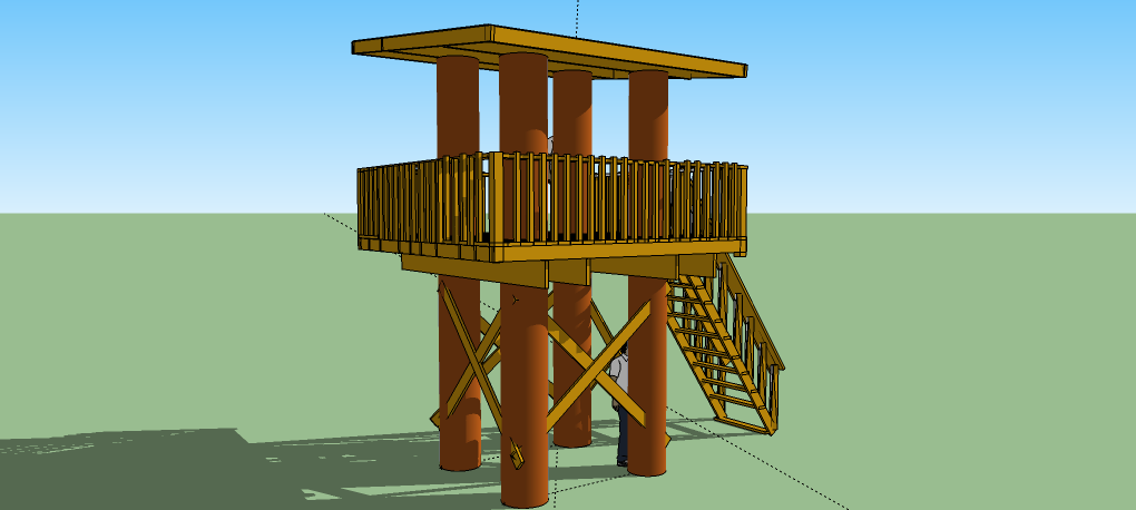

Does this look better?

Your telephone poles are plenty stout; but you need to get them deeper in the ground. The cross bracing will stiffen up the structure significantly. I assume you're going to through-bolt the floor joist to the poles. I'd sink the poles deeper, then switch to conventional framing techniques from the deck level on up.

Diagnal bracing is always a good idea. Just guessing, 2x6's should be good. Nothing smaller.

Your stairs will be attaching to a cantelevered joists. This will cause some problems down the line with usage and I would add posts to the stairs at the top and middle of stringers. In essense, the stairs will be supported by the posts and just held in location to the floor joists without any real load being applied to the joists. Concrete for your first step to keep the stringers off the ground is also a very good idea and an excellent way to anchor your stairs.
What is code for commercial stairs? 3ft is wide enough for two way traffic and the smallest I would consider.

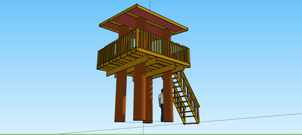

I may as well use put the joists at 12", very little extra cost.
I think that I will use 6x6s for corners, that will be easier and much better looking. If the edge of the deck needs any more support, then I can always run an angle down to the telephone pole.
I think that a single center post should be good, which will leave me just a 6' span between posts.
I found galvanized bolts for a good price, so I'm just going to use bolts. I will notch the telephone poles so the beams sit flush.
I am deciding between 2x6s or 2x8s for the decking, maybe alternating to give some visual interest to the design.
I plan on using decking screws and galvanized bolts for everything. Nails never hold up on outside structures.
For the roof I was just going to do a simple frame and cheap corrugated tin. I just need something to keep the sun off.
