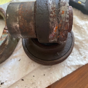

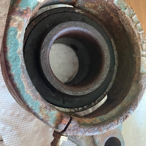

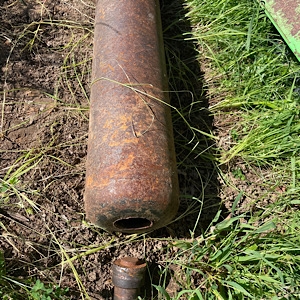

Well, not sure about bearing brand. I lost the roller on my Nova flail and just ordered some replacement 2 flange bearings. You can see that the bearing seized and broke the cast holder and yanked the stub out of the roller. Hopefully, lesson learned and I’ll remember to lift and spin the roller before use.
UCFL207 Cast Iron Oval Flange Bore Size 35mm

I grease the snot out of those bearings on my flail mower, pretty much every 4 hours.

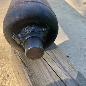

Grease before use, yep. Losing the bearing was a oh poo, losing the stub shaft is an O ****, Hard part is gonna be welding it back in straight. Luckily, I know a guy with a big enough lathe.

Added bonus, I was contacted by Nova tractor asking if I needed any parts support to get my mower repaired. Turns out I purchased this mower in 2018. 5 years of use on a bearing isn’t too shabby especially since its been on the front of my skidsteer and behind the tractor.
   / Nova Tractor vs Betstco Flail #28
Got the roller pieces welded back together today. Nova tractor suggested adding some diagonal bracing so we did.
