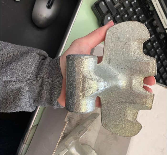

I have a Novatractor Flail. MFZ-155. We call it the park maker. The 3 pound hammers look a bit like metal bear claws and they wreck stuff :) I don't mow lawn, I mow weeds and brush, sticks, pine cones. It turns rough overgrown areas into mulched up useable areas like magic. The main unit is built in China, but it uses Comer transmission and SKF bearings, so the main moving parts are quality.
The hammers. This is why I picked Novatractor over anything else.
