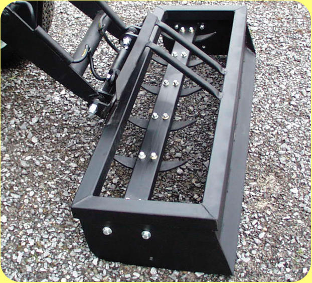

I am looking for a land leveler to set / reset the camber on some dirt roads, and I came across a land leveler from Notch Manufacturing. These aren't gravel roads, so I am less interested in ripper teeth.
Anyone here have any experience with it? It seems like a useful design to be able to easily do change of camber angles.
I am open to other solutions; hitch mount, 3-pt, skid steer.
Thanks in advance.

I happen to win a Power-Trac tractor, which I find very useful, but it doesn't have a three point hitch. Their box blade (shown below) has no way to adjust the camber, hence my search.
My guess is that my tractor is going to be limited in how much I can pull/accumulate at one time since there is no low range, but this is a once a decade "need". I am weighing renting a small dozer and just getting it done as an alternative.

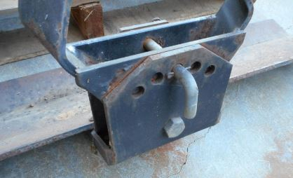

A manual pivot like what is on a 3 point rear blade could be inserted between their quick attach plate and the box blade.
This type of a pivot installed vertically:

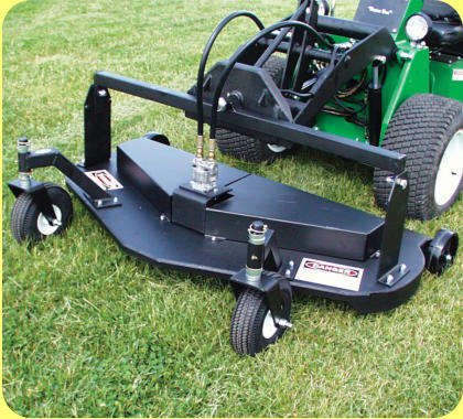

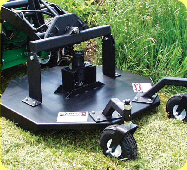

The pivot they use on their mowers would work to let a box blade tilt:

I have the mower with that pivot, and while it functions well for a pushed wheeled mower, I am not sure that it does have the strength to be pulled on with a leveler. It is basically a 1"(+/-) flat head counter sunk bolt, with just the lip of the screw against a pull.
