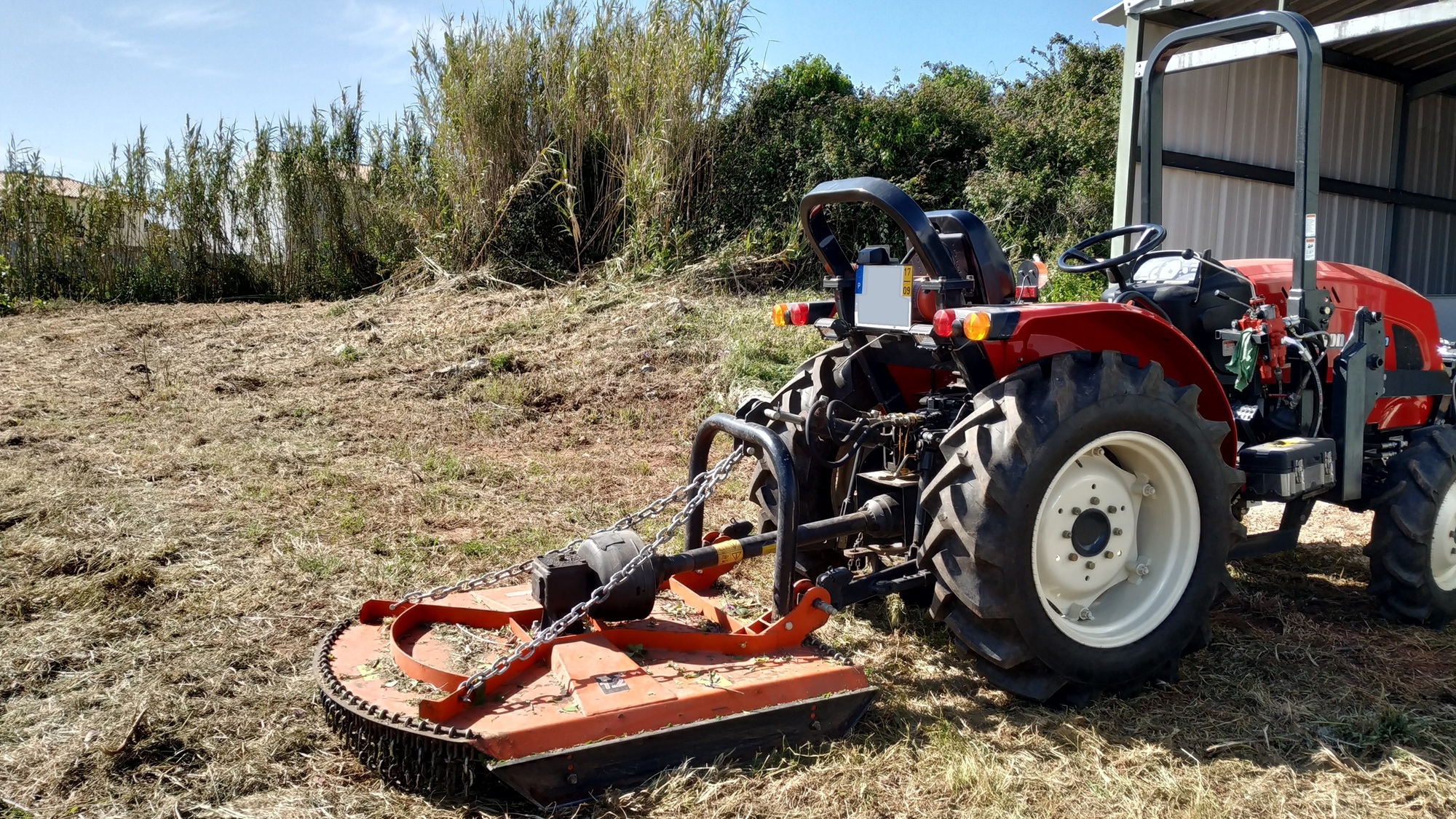

I can hook up the brush cutter in 1 to 2 minutes, just like any other attachment.
All it takes is to back up to the implement till the hooks slide under the balls on the lower pins, lift the 3 pt and it's latched. Then I hook up the PTO shaft and finally the top link.
Features that really helps the process:
- Euro hooks/lower link hooks for sure
- Telescopic stabilizers
- Ability to put the PTO in Neutral so the shaft can be spun by hand easily
- Hydraulic top link.

1-2 minutes seems very fast have you ever actually tried timing it start to finish ?
Noticed your cutter has no rear wheel I suppose that could help to make it slightly easier to hook up.
I also have euro hooks and hydraulic top link, very rarely have any trouble hooking up the PTO , mine is the push button type which at least for me is much easier than the sliding collar type on my snowblower.

Yes I have indeed timed it and wasn't even rushing it. I actually thought it was more like 3 to 4 minutes.
Mine is a collar, I don't mind either style.
Rear wheels on brush cutters is a big no over here. The brush cutters are built with skids and meant to just drag on the ground. A rear wheel would be destroyed in no time.
