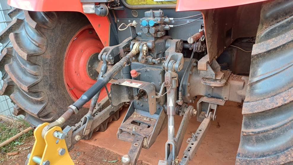

Most 3-point hitches have two settings for the links to the lower arms, one of which allows you to lift each one independently, maybe 4 inches higher than the other. Very useful for that scenario.
Of course, all you need is for one of the links to be readily adjustable, in order to get the differential height you're after. But yes, both links are adjustable.

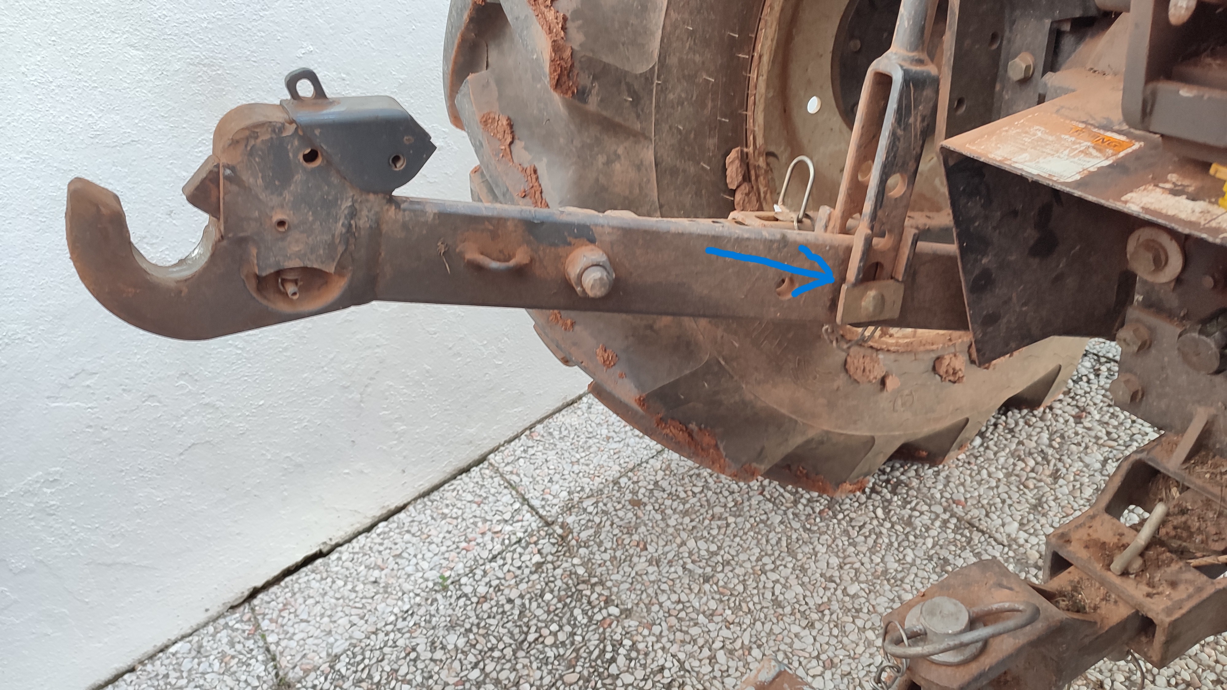

On mine, besides have the adjustable side link with the hand crank, also has 2 holes and a slot on each side link. The holes are self explanatory.
On the slot, since the pin has a rectangular plate welded to it, it can provide two functions. With the rectangular plate in the horizontal position, it functions as a regular pin. With the rectangular plate on the vertical position, it lets the pin slide on the slot, providing maybe 2 or 3" of free play that lets the implement tilt and follow uneven ground much better.

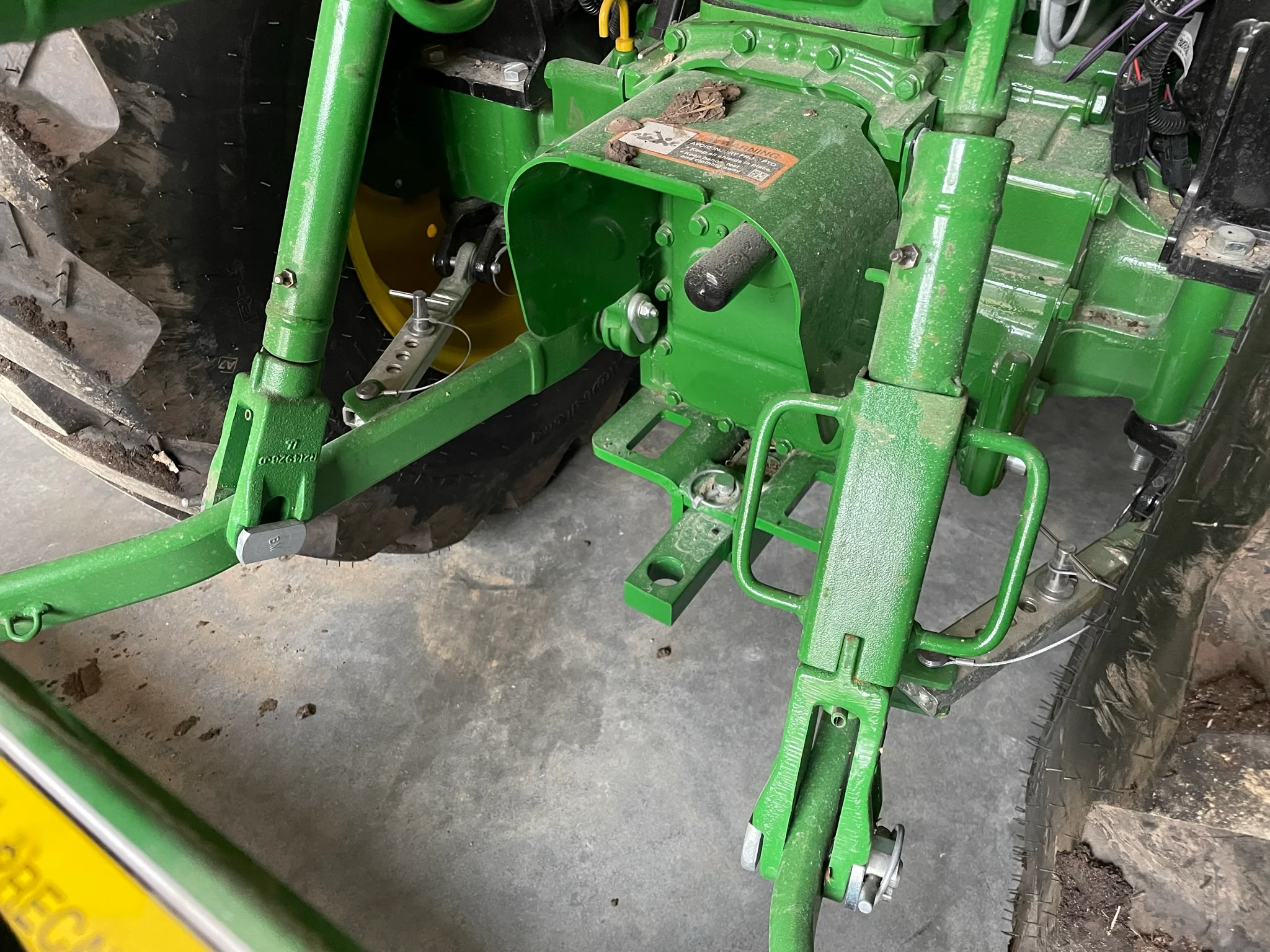

What brands of tractors have the two different settings for the links for the lower arms that allows to lift each one independently ? I have been around 3 point hook up tractors most of my life and don’t recall ever seeing one built like you described.
I've owned 3 Deere's (3033r, 855, 750), and all had two different positions for the pins on the connectors between the rockshaft arms and lower link arms, one of which allowed the lower links to float or lift independently.
On the 3033r, you just turn the lower link pins a quarter turn.
Floating:
Fixed:
Note the keyway slot type pin head is turned from vertical to horizontal. It's right there in the manual of every tractor I've ever owned, although the exact hardware used is slightly different on each.
Is this something only Deere does? I can't imagine having a tractor without this simple feature.
