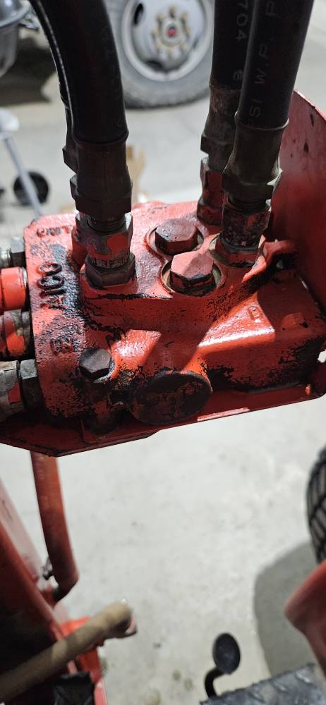

Ok, thanks! So, that bolt that is between A1 and B1 on the boom lever, what will that do if I take it out? Will that access anything that could be sticking?
/ Not stuck 165D hydraulic issues #6
No idea, as I don't know anything about your valve. Picture, name, model??

A few photos of your valve will help folks who know give you better advice. The old "a picture is worth a thousand words"... If you can find numbers, that is a help, as well, but start with some good photos please.

Hard for me to recall but isn't your Hyd. pump is on the crank Shaft? If it's lifting then you have pressure. I have the same Control Valve. Pretty simple!. watch and make sure you see Hyd. Valves actually moving with the Handle. In and out with the handle movement. You can see the return lines back to the tank. I would be looking hard at those lines being plugged. Fwiw my Valve is made by Wagner. And look how big my return line is to the Réservoir. Dirty screen or clogged line. I had a pinched line inside the Hyd. hose. Swelled at a bend and pretty much had pinched close. Lucky and If I didn't look inside the line I never would have known or seen it.

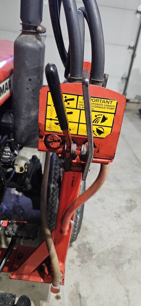

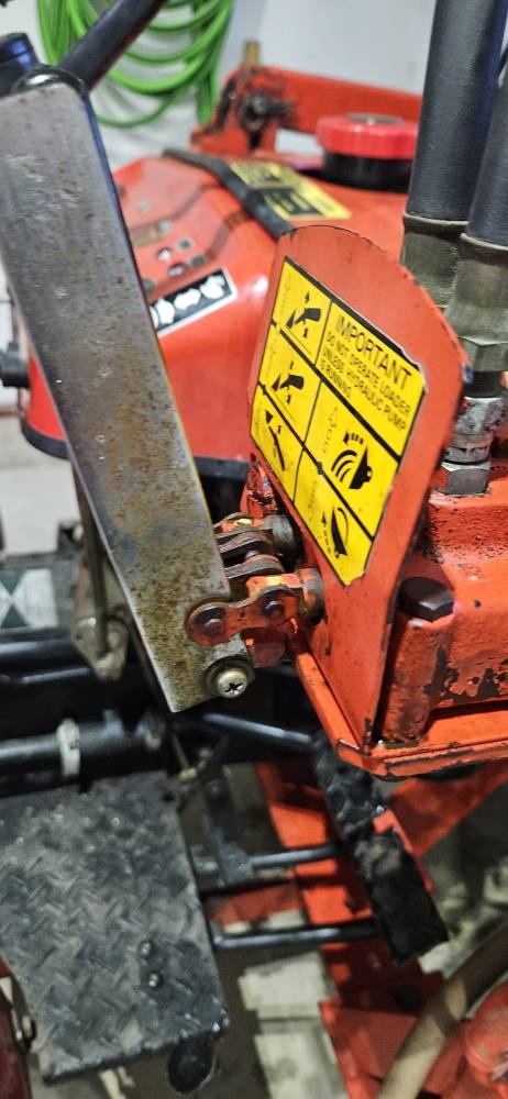

Looking at your pictograph it looks like as you push your boom lever ahead you should get into a power lower which would lift the tires as it powers the boom down,
if you push it further ahead you should go into a "detented" float position which would allow gravity and ground to float your boom up or down with no hydraulic force.

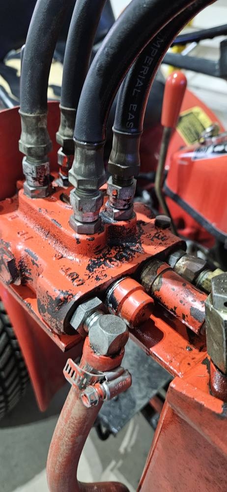

The detent control is usually located in a cylinder style enclosure on the far end of the valve spool. Those can be removed and cleaned, as they can accumulate dirt and rust and other garbage.
Just be aware that most of them contain springs ( for self centering) and balls to snap into a groove with springs for the detents.

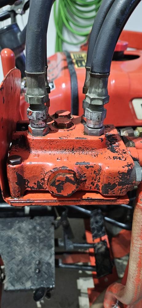

So, would that be the long orange cylinder on the backside of the boom valve?
/ Not stuck 165D hydraulic issues #16
I would expect so, that's were all the ones I've had to take apart were.

It really isn't a fix, as there is still an issue. But, when I lower the bucket and it sticks and I let it go all the way down until it stops or lifts the front end, I have to tap on the lever with a hammer to get it unstuck. However, if I lower bucket and if I pull back on lever rapidly, it will not stick, but I can feel where it catches. If this all makes sense
