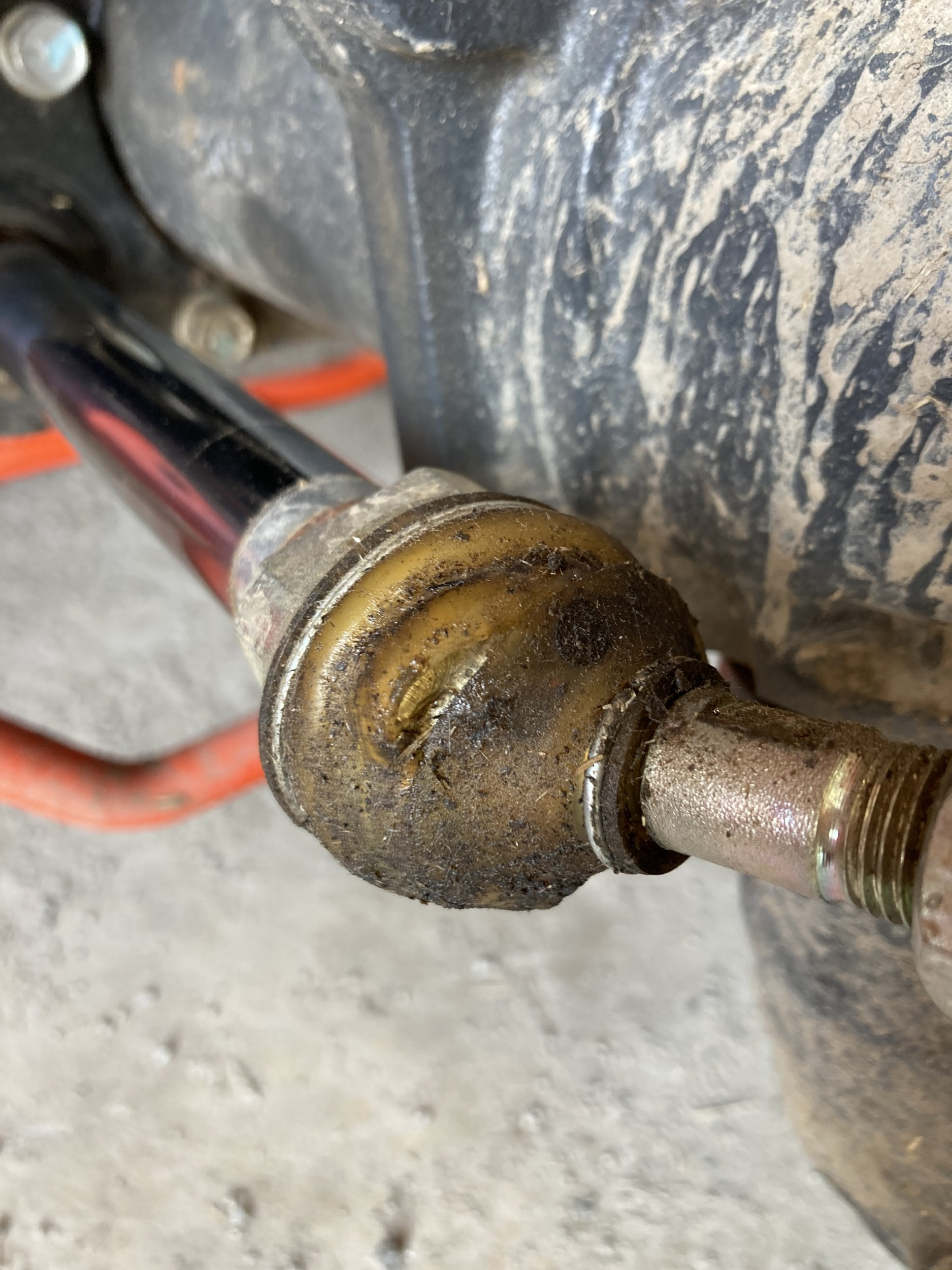

I have a boot cracked wide open on one of the inner ball joints on my BX2380. I can find the part in Kubota's diagrams but guess what? Instead of being able to replace a $10 boot, the best that can be done is a complete ball joint replacement. Other than that it's replace the entire tie rod.
Not a very practical solution in my opinion but there's really no other choice. Either buy the $34 part now or just use the tractor until the joint goes bad from dirt, water, etc. intrusion and then replace it. Kind of leaning toward that. The tractor doesn't get any severe duty use.

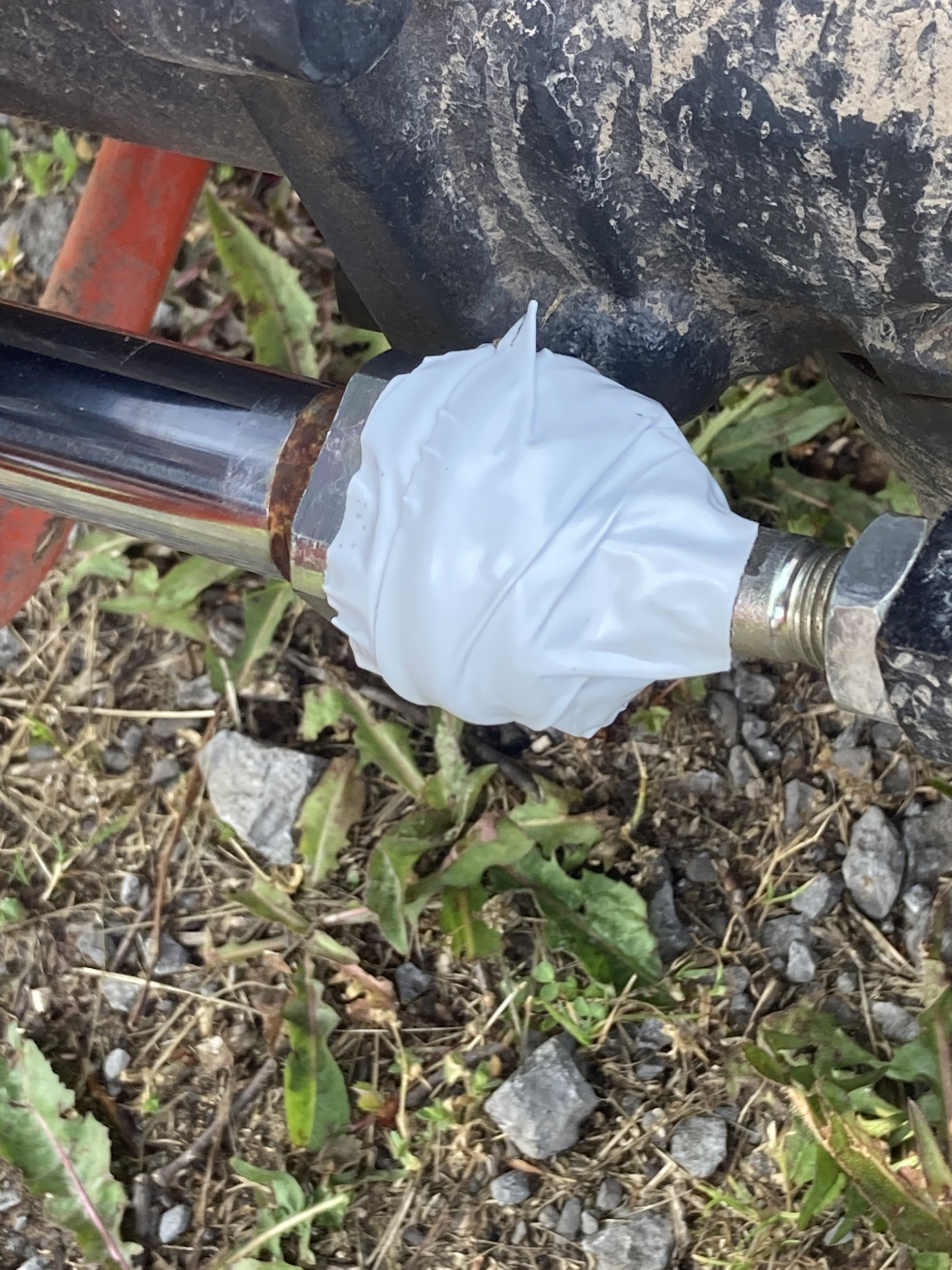

I wrapped mine with black stretch tape and then over wrapped it with electrical tape. It’s been holding for almost two years now. Did have to re-wrap once but otherwise it’s been a good inexpensive fix for me.

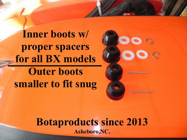

I recommend replacing both sides. Other side probably isn't far behind. I think the oem boots on my 1870 were cracked within the first year or so. I replaced them with the Bota Products boots. They are holding up well. I'll have to look tomorrow and make sure dealer didn't mess with them last week....
Since the kit I bought has two boots, I may do just as you suggest.
