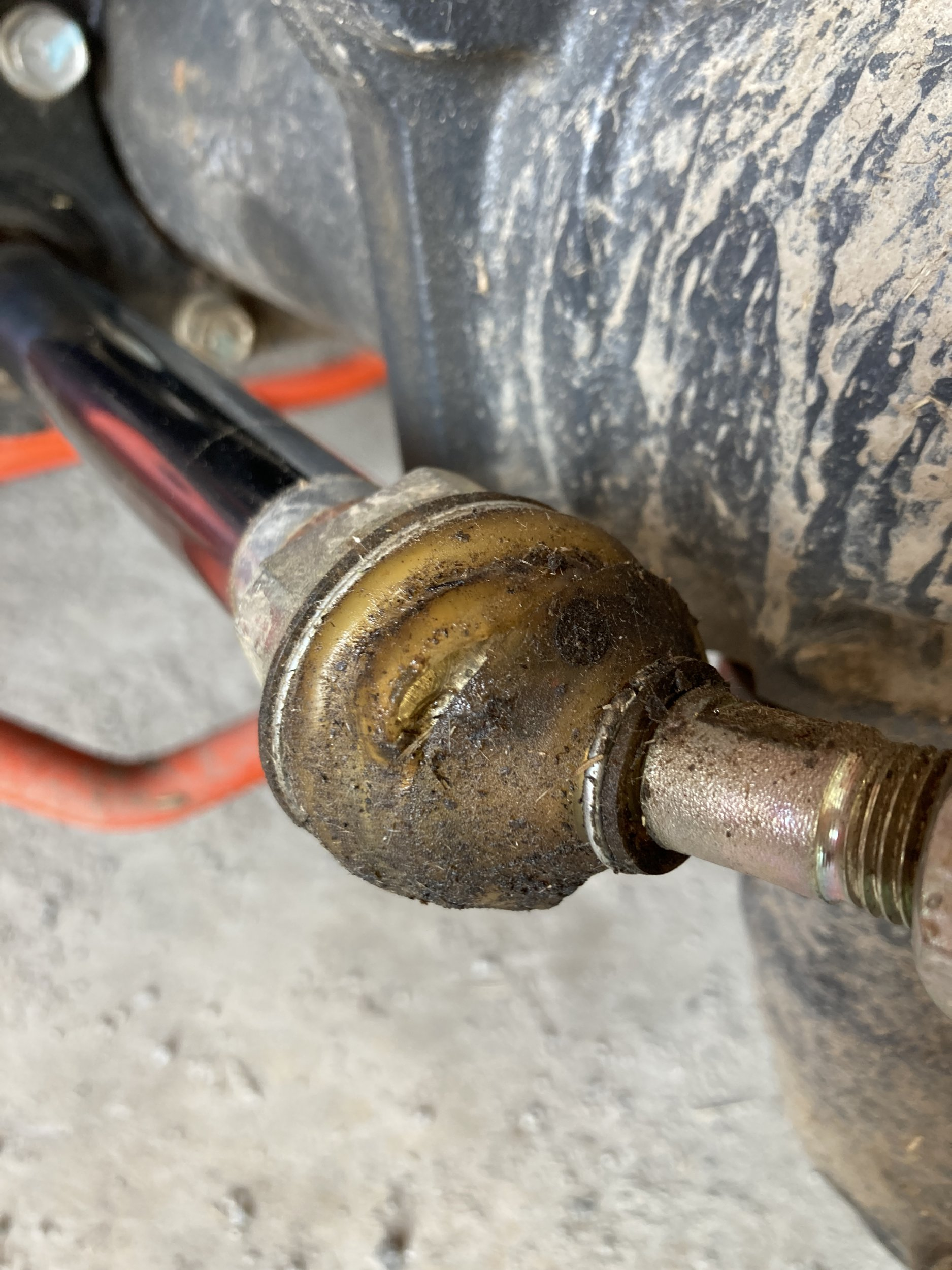

I have a boot cracked wide open on one of the inner ball joints on my BX2380. I can find the part in Kubota's diagrams but guess what? Instead of being able to replace a $10 boot, the best that can be done is a complete ball joint replacement. Other than that it's replace the entire tie rod.
Not a very practical solution in my opinion but there's really no other choice. Either buy the $34 part now or just use the tractor until the joint goes bad from dirt, water, etc. intrusion and then replace it. Kind of leaning toward that. The tractor doesn't get any severe duty use.

Yes, it's in the diagram but the part number shown corresponds with the whole tie rod, which is $50 plus. Messick's parts man came up with the inner ball joint suggestion to save a few bucks.
The list he sent me showed several dealers that had the part in stock. Closest one is about 65 miles away. I haven't used Google in a few years. I switched to DuckDuckGo. But that's another conversation.

I ran into the same problem with my John Deere tie rod boots, but at higher costs. I spent some time looking for boots from 3rd party suppliers and didn't find anything. Also ran into a problem getting the nuts off the tie rods. Bottom line, I ended up cutting up a bicycle inner tube and wrapping that around the rod and holding it in place with zip ties.

I've got a feeling that this will turn into a long term fix. It sounds like a boot by itself will never be available. At least from Kubota. Maybe the aftermarket will address it some day. I'm not really losing sleep over it. The tractor has mainly residential yard work duty on my 2 acres and doesn't see any extreme service. I mow one acre with it. My wife knows how to operate it and she moves her own mulch when I buy it in bulk with the dump trailer.
Maybe some type of butyl tape like the kind sealing the hatch on my enclosed trailers would work too. Lot of options to check out before replacing a perfectly good ball joint with only 70 some hours on it.

Wrapped with seam tape that I use over the nailing flanges when installing windows or doors. We'll see how long it holds.

Go to Ebay, and in the search box, punch in Kubota BX inner tie rod boots. They're far better than the garbage that Kubota puts on as OEM. I just changed mine on my BX25D. The Ebay boots are way tougher and thicker, and easy to install. Good Luck.

eBay does indeed show several options. Some look exactly like those in the link provided previously by Panik. Thanks to everyone for the suggestions.
I don't know how long this link will last, but here's what I went with:
