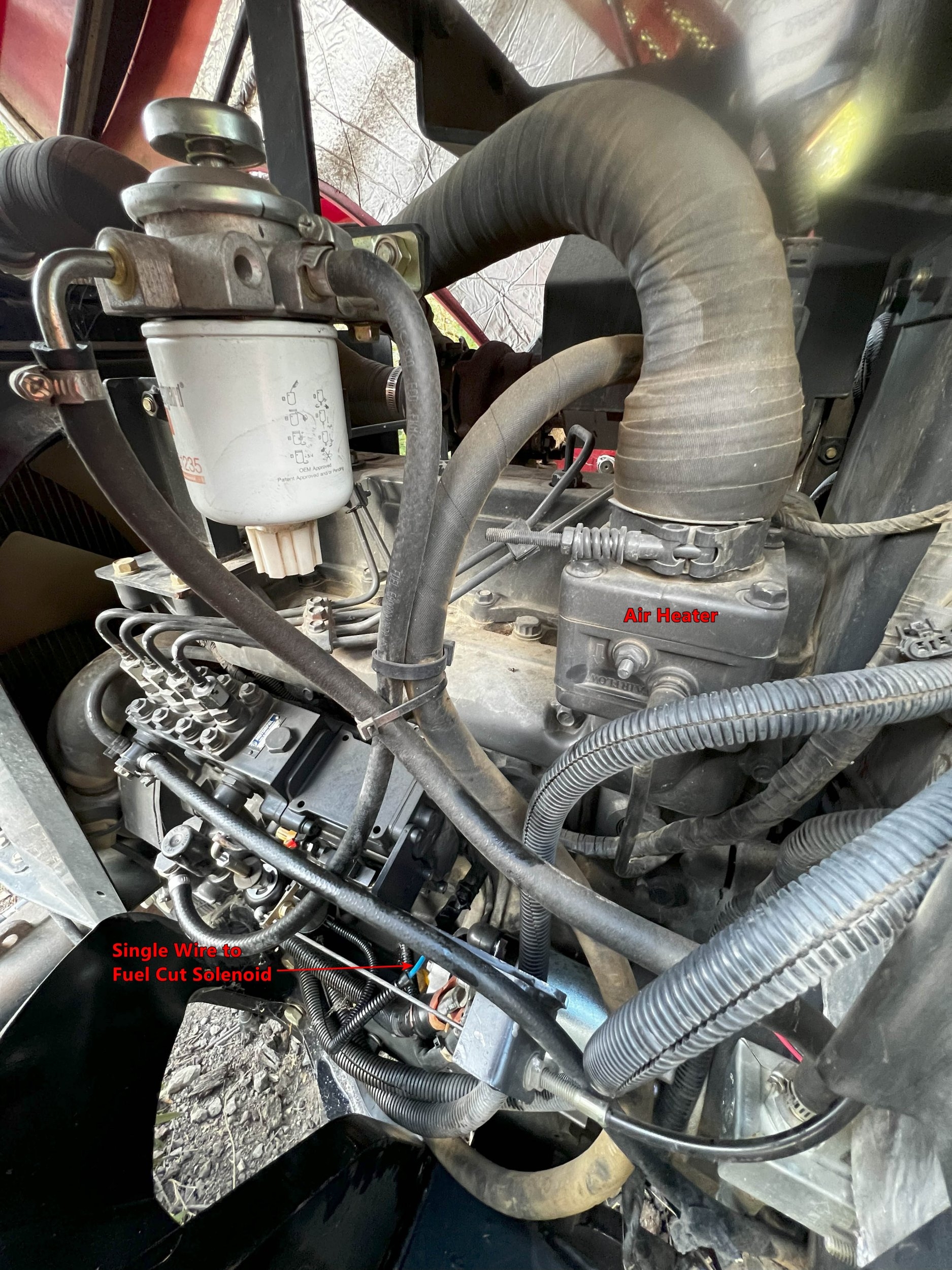

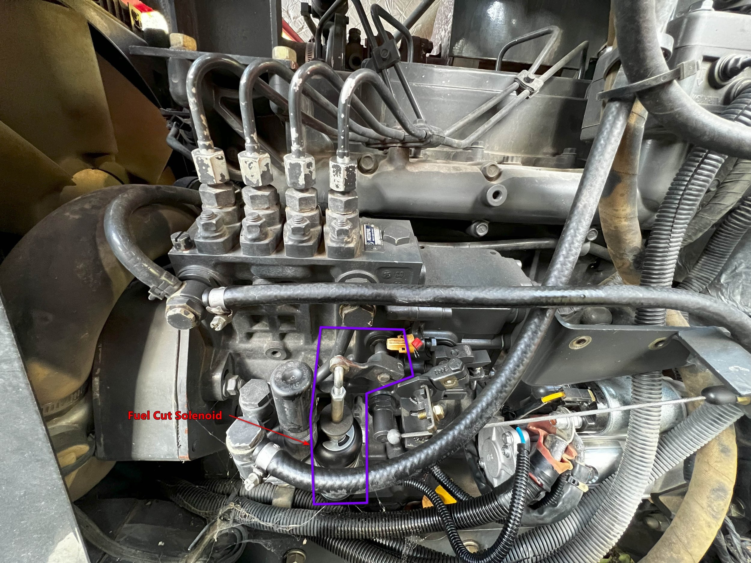

K5lwq: Thank you! Here's the next installment of my saga:
The fuel cut solenoid is just hot and ground. The connector is taped up like someone's been in there before--I got this tractor used. I tried pushing it with the key on to see if it went full travel and yes, it seem to pull all the way to a stop. (I do know what you mean about two-coil solenoids.)

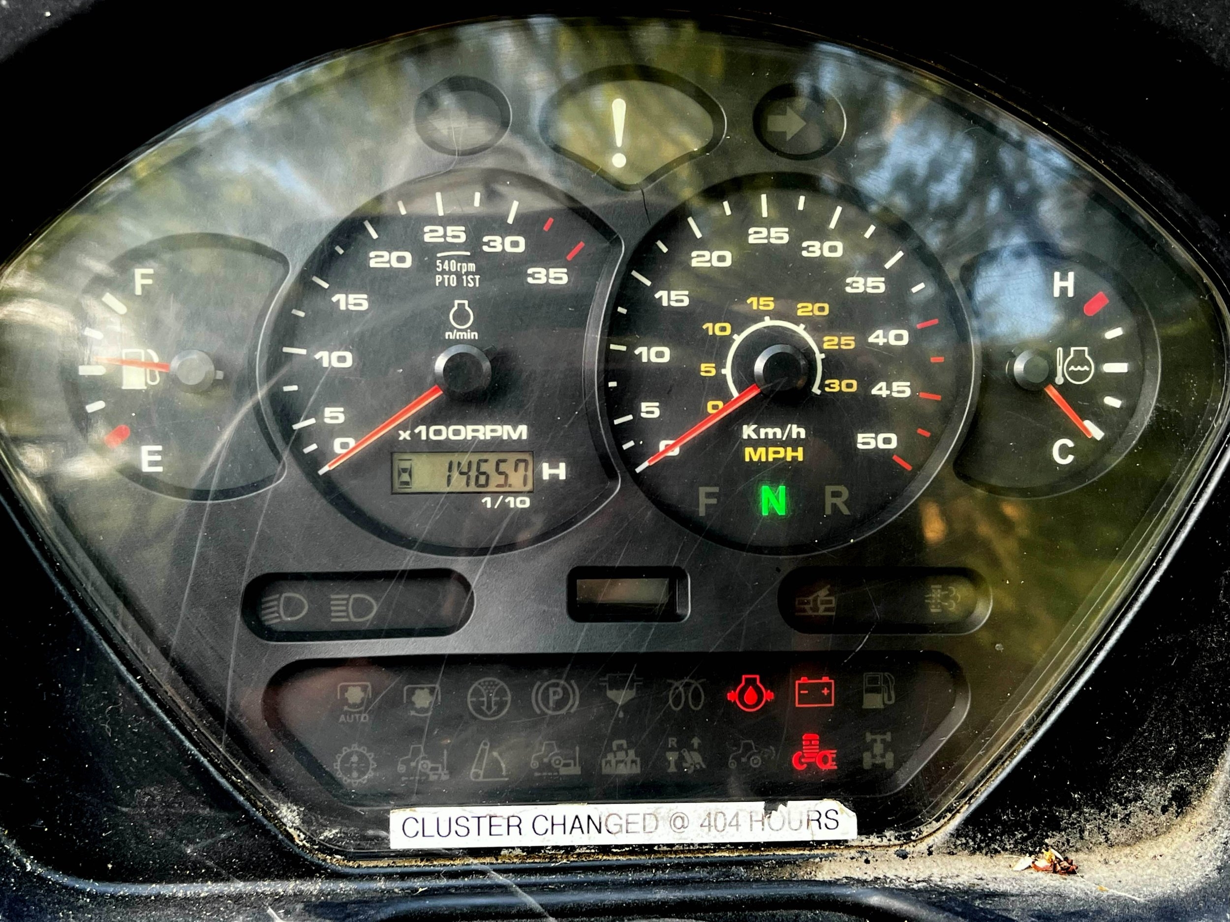

After researching the glow plugs I've come to find out that this engine has an air heater and no glow plugs. But the function is the same, and the glow plug lamp does turn on for a couple seconds. But no joy. Also, it's above 70ºF here so I wouldn't expect it to need an assist. It always started instantly--unless it wouldn't start at all. I've attached a photo of the instrument panel.
There's no smoke in the exhaust during cranking, so I'm thinking that it's not getting fuel. And the throttle position makes no difference. Maybe something stuck in the injection pump?

I would get those injector lines nuts loosened at the injection pump (for ease of diagnostic, ideally would be on the injector end) and then try to crank the engine and see if the injection pump is actually pumping any fuel. While it won't give us a lead if it's the solenoid or the pump, it will tell us if it's not starting because of lack of fuel and not something else.
/ No start -- 7845R #6
Or disconnect the solenoid operator from the fuel lever, then operate the lever by hand and try starting with it in both positions.

I disconnected two high pressure fuel lines and confirmed that it's not delivering fuel. Here's a video showing what it does:

Well, I don't quite understand it, but here's the story: I took off the rubber hose at the injection pump, ran the electric pump, and lots of fuel, as expected. I took the linkage off the fuel cut solenoid, compared the stroke to the lever, all appeared good. I tried to start with the linkage off, no start, as expected. Not knowing what else to do, I cranked with full throttle. I had tried this briefly before. But this time, to my surprise, fuel spilled from the two disconnected high pressure lines. I did it again and it fired up on the two remaining cylinders. I put it back together and no further trouble.
It seems like it got a big gulp of air, somehow, even though the tank was half full and the tractor was on level ground. Is it sucking air from somewhere?
