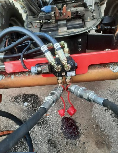

I bought the third function/diverter valve kit from Rural King for my RK37HC thinking that all hoses and so forth were included and cut to the correct length. My neighbor who does a lot of mechanical work on tractors installed the valve for me today but there's no pressure to the grapple. The FEL functions normally as far as raising, curling, dumping and so forth. The light on the solenoid comes on when the button on the joystick is pressed and you can hear the valve clicking but no fluid to the grapple. The only thing changed was that the valve came with Pioneer fittings but the grapple came with flat faced so we changed those on the valve to flat faced. We cracked open the fittings slightly on the valve and to see if there was pressure but the fluid just dripped. The hoses to the grapple will be repositioned once we figure this out but are like this for ease of access. Also, my neighbor said all the 3rd function valves he's installed had two button for the joystick but this one in the kit only has one. Is that correct? Any ideas other than the valve being bad?
/ No pressure to grapple #2
With that diverter valve, you have to hold the button while moving the joystick to actuate the grapple. Typically left/right on the joystick as the valve is usually connected using the curl/dump circuit.
/ No pressure to grapple #3
Did you plumb it to the bucket curl lines?
If so and the bucket curls good, when you activate the switch use your curl function to provide flow.

Did your neighbor mechanic tell you whether he set it up to divert the lift/lower or the curl/dump circuit??
A diverter NEVER needs a two button joystick. Because a diverter has only ONE solenoid. SO at this point I have lost all confidence in "your neighbor mechanic"
OH, and also.....it looks like its plumbed wrong......but hard to tell from the pics because I cannot see what the ports are labeled. A closeup would be nice. But guessing about 75% sure this is the issue....incorrect plumbing

I haven't had a chance yet to try it but I think that the moving of the joystick will work. Last night after seeing the replies I recall the RK person telling me that you have to use the curl/dump function when I bought the kit months and months ago but I forgot about it. I guess they don't expect anyone to buy the kit and install it themselves because it comes with no instructions other than a photo of the plumbing of the new hoses. Nothing about the operation of the valve.

Thanks to those that responded about using the button and the curl/dump function in conjunction. This afternoon I walked over to my neighbors and we gave it a shot. Perfect......... He said yestertday that it has to be something very simply. The third function joystick was added as standard equipment on later models of the RK tractors so there's no mention in the manual as to how the button functions. Even the new online manuals haven't been updated to mention the button. As I mentioned in my second reply, I remembered during the night that the RK guy told me you have to use the curl/dump function but that was close to a year ago and I had forgotten.

Since the lines feeding the valve have to originate from either the curl/dump OR the lift and lower hoses....and NOT from a main pressure line.....that is the reason it's called a diverter. And the reason the joystick still needs actuated WHILE pushing button.
Since you mentioned it as a diverter.....and since it ties into one of the joystick functions.....I assumed either you or the neighbor understood how it was supposed to work.
When I asked the question "weren't you trying that".....was because I was kinda surprised you weren't. And initial look at the pics.....my thought was wrong plumbing. Because MOST diverters have the top ports as the ones going to the grapple. And the side ports are supply....and normal function out. But I say "most" because not all are that way.
In any case.....I'm glad you got it working and it's water over/under the bridge now.
But I gotta ask.... which functions of the joystick are diverted that now operate the grapple?
Also.....if open/close are backwards from what you prefer for operation.....just swap the two hoses going to the grapple

LD1, the dump/curl function is what's diverted to the grapple. I had no idea this was a diverter valve until after I purchased it and saw the valve labeled as a diverter. The TYM label on the box definitely says third function kit. Even knowing it wasn't a true third function I most likely would have bought it anyway since it contained all the fitting and hoses cut to correct lengths.
