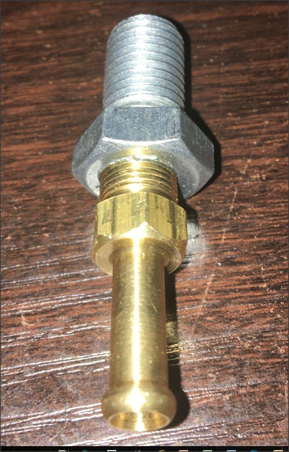

No dipstick or level checking plug either, but instead it's filled through the drain plug opening on the bottom!
I have done it couple of times myself and it's not really a big deal, but you need to be "a handyman" with some tools and will need the instructions for your car & proper manual oil pump with adapter.
The design certainly discourages DIY service...
My adapter:

My adapter:

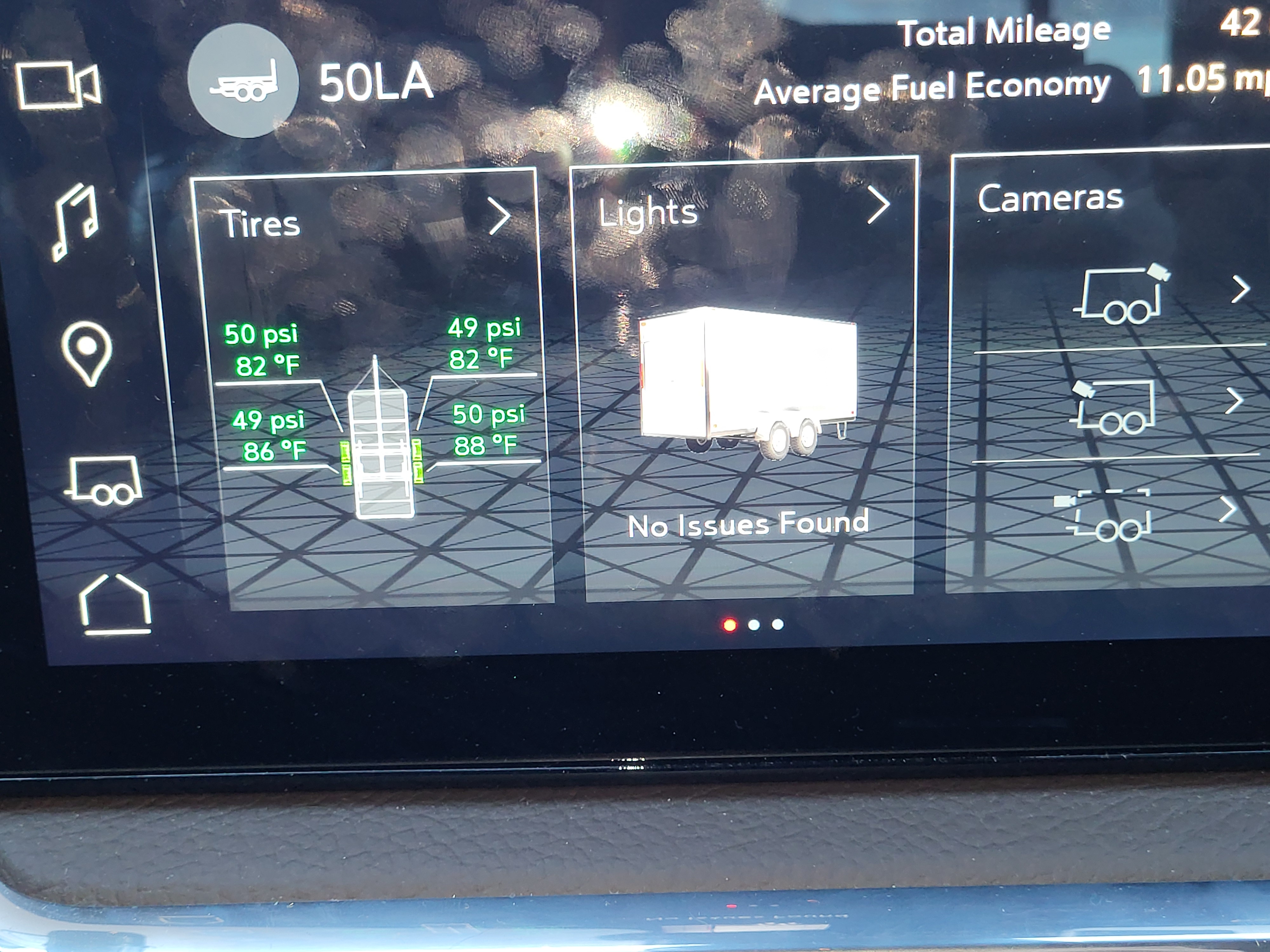

What about checking to ensure you haven't cooked it? One thing that they finally started adding is a transmission temperature gauge. Aside from being able to monitor, it made me realize how important a cooler is. My Colorado with cooler runs about 95 pulling a 3000 lb trailer. The GMs my company bought didn't have coolers, and ran around 190° in everyday driving. They also overheated quicker when working them, on more than one occasion I had to stop to let the fluid cool when pushing through snow.
Displays have come a long way. I also like the transmission temp display. I have the dash display configured on my GMCs to show it constantly. Along with the trailer brake controller output when towing. The TPMS display is great as well, for both vehicle and the trailer tires.
