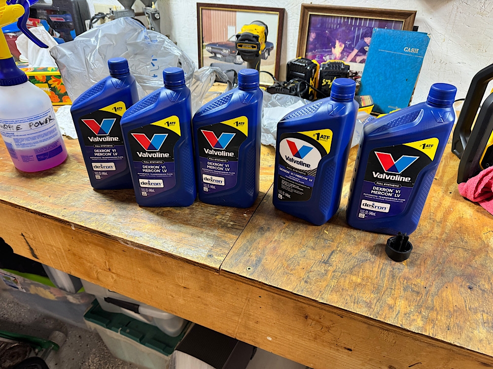

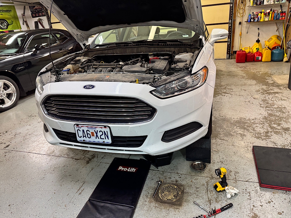

What is it with no dipsticks these days? Do they not trust people to look at them? I changed the transmission fluid in my daughter’s car and there is a fill plug on top that access to is tough. It’s a 2016 Ford Fusion, 150,000 miles. Then there is a plug on the side you remove and fill it until it runs out. Then drive it to warm it up and remove the plug and check it again. A dipstick would be much easier.

No transmission filter either, apparently just a large screen. When I changed the fluid I only got about a third of it out. I’ll have to change it again soon to get it a little better. I’m not sure what I spent for the oil change and transmission fluid, maybe $50 to $60. I wonder what a dealership would have charged her?

The fill plug on the Fusion transmission is on top but the access is terrible, buried under the air intake hose, wiring and an AC hard line almost on top of it. It took a couple of minutes to get it out but 10 minutes to get it back in.

at least you have it figured out. I'd be skeptical of a Quik Lube place to change the fluid on that model

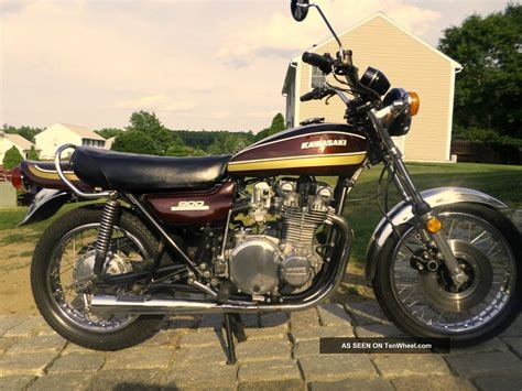

Newer? My 1976 Kawasaki KZ900 used a sight glass. No dipstick. I don't know that they were the first but all the 900's and KZ1000's used a sight glass. The Z1 was the first of the 900's. Sight glass is right above the brake pedal on this Z1b.
