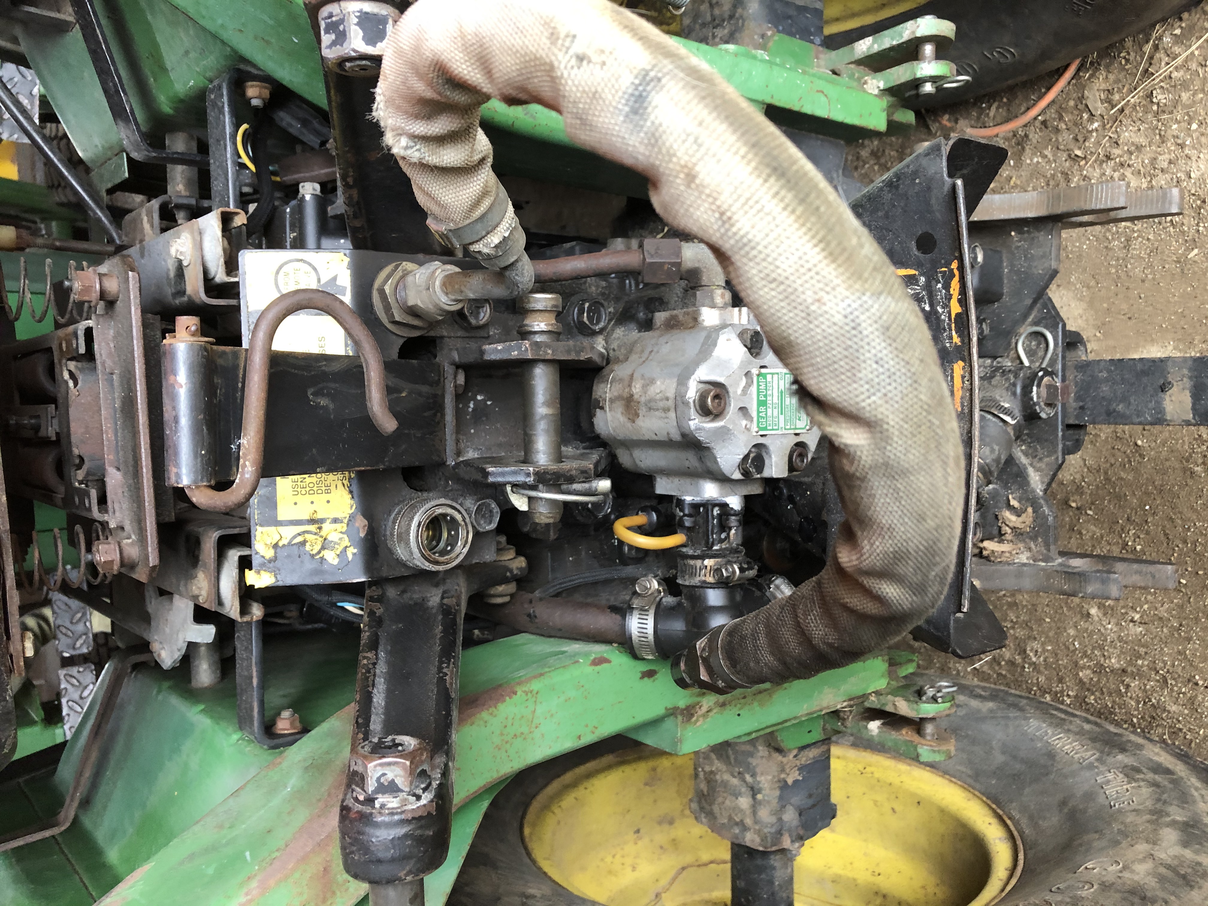

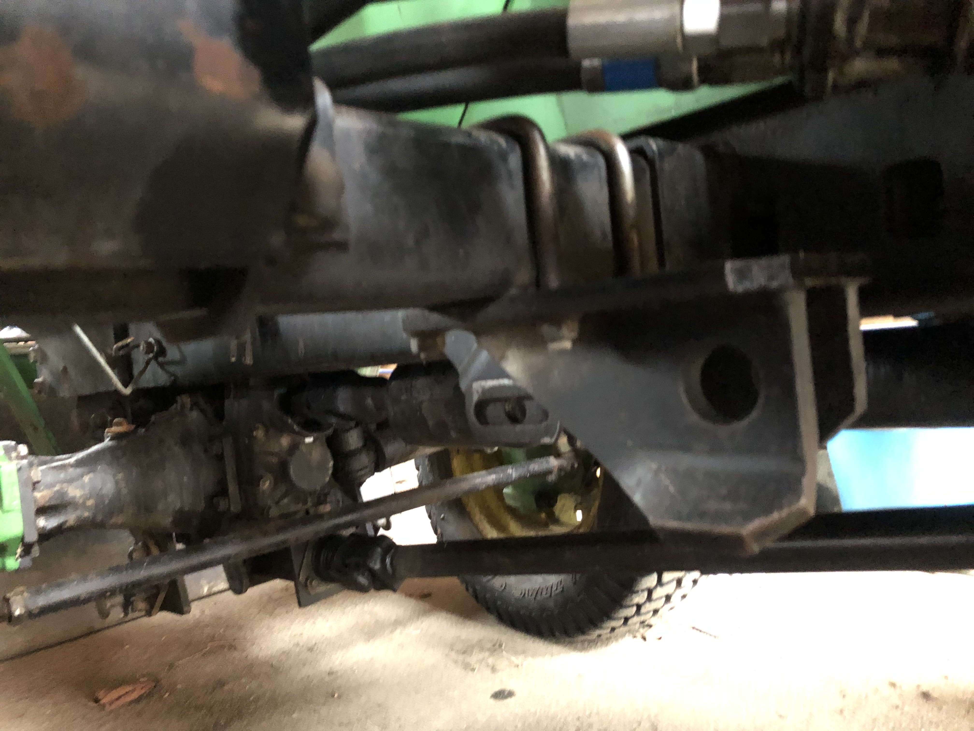

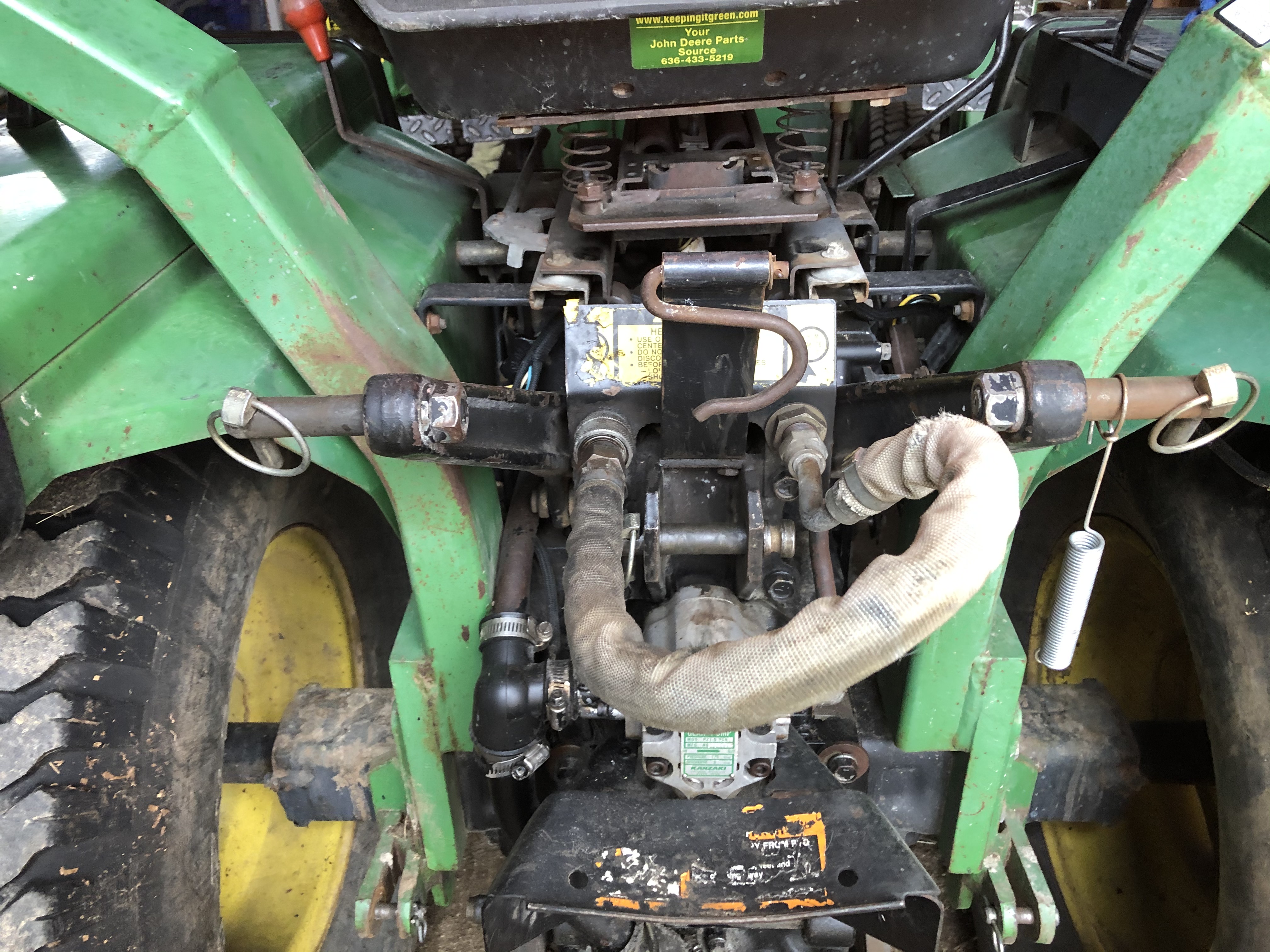

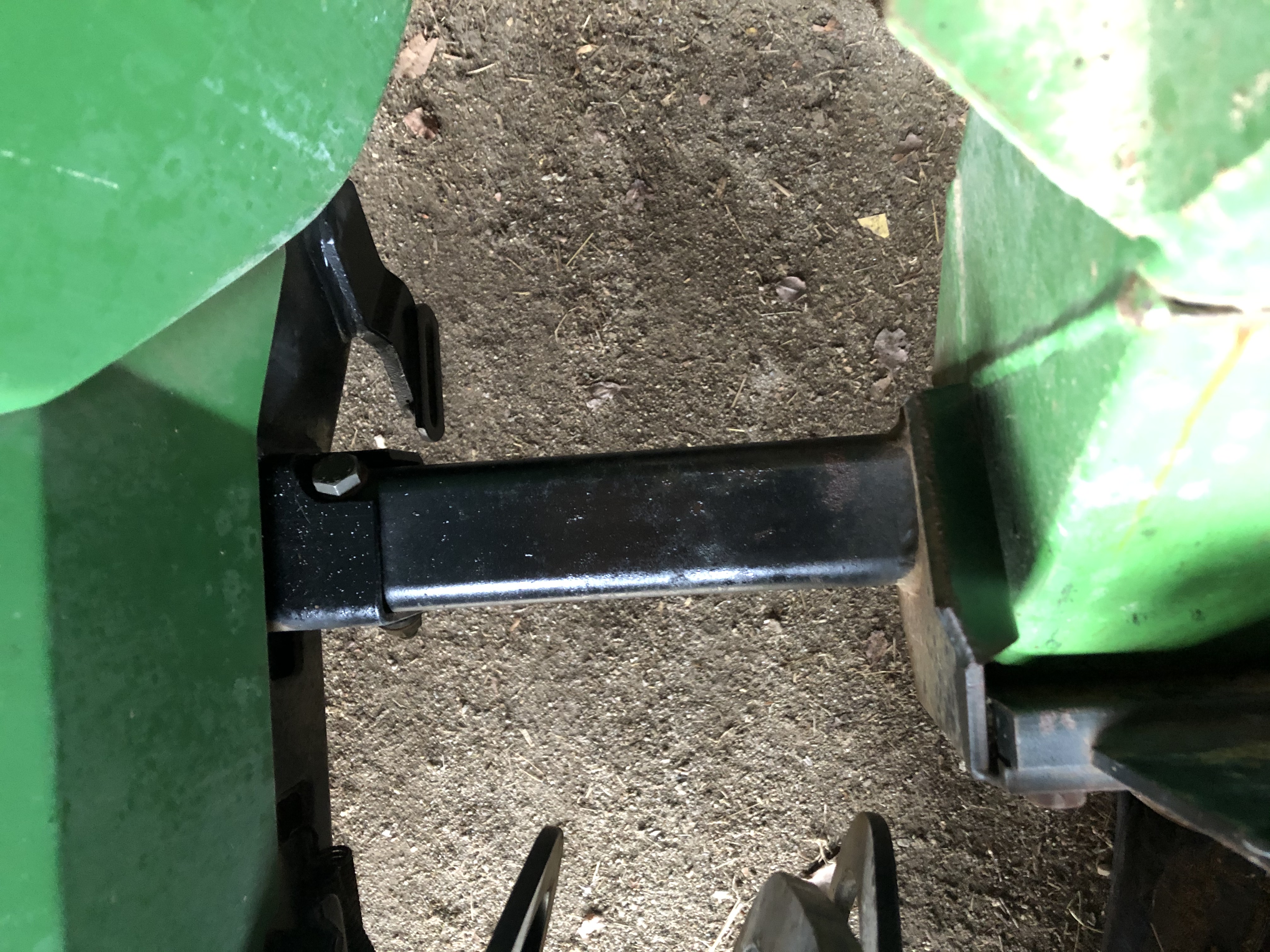

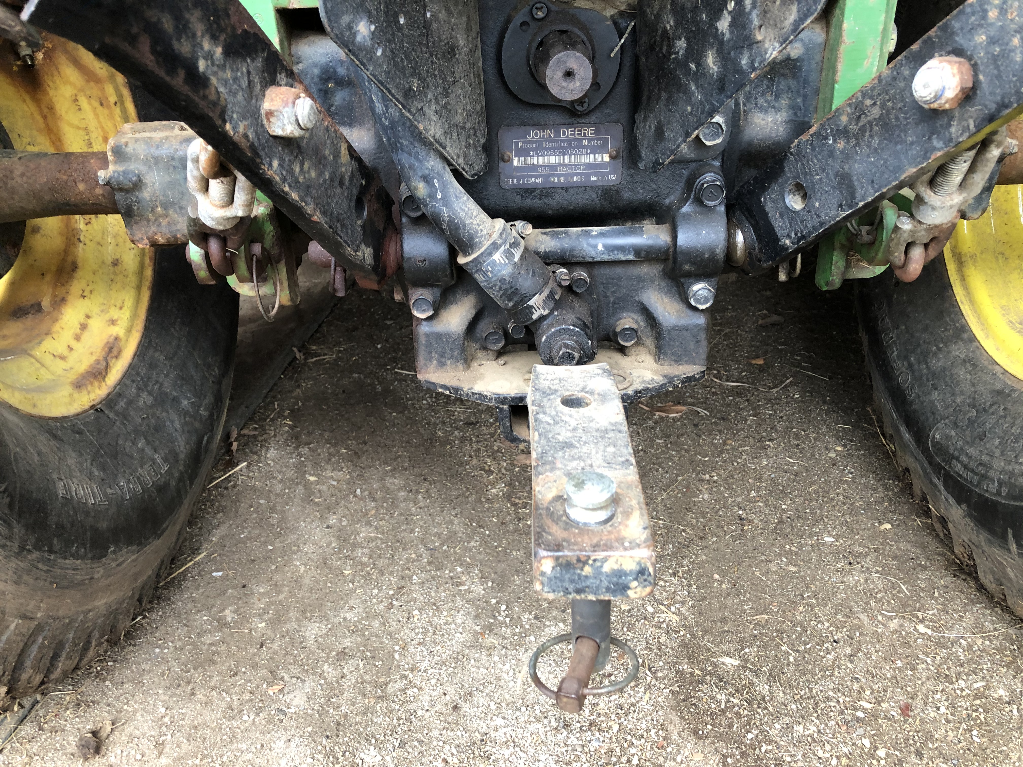

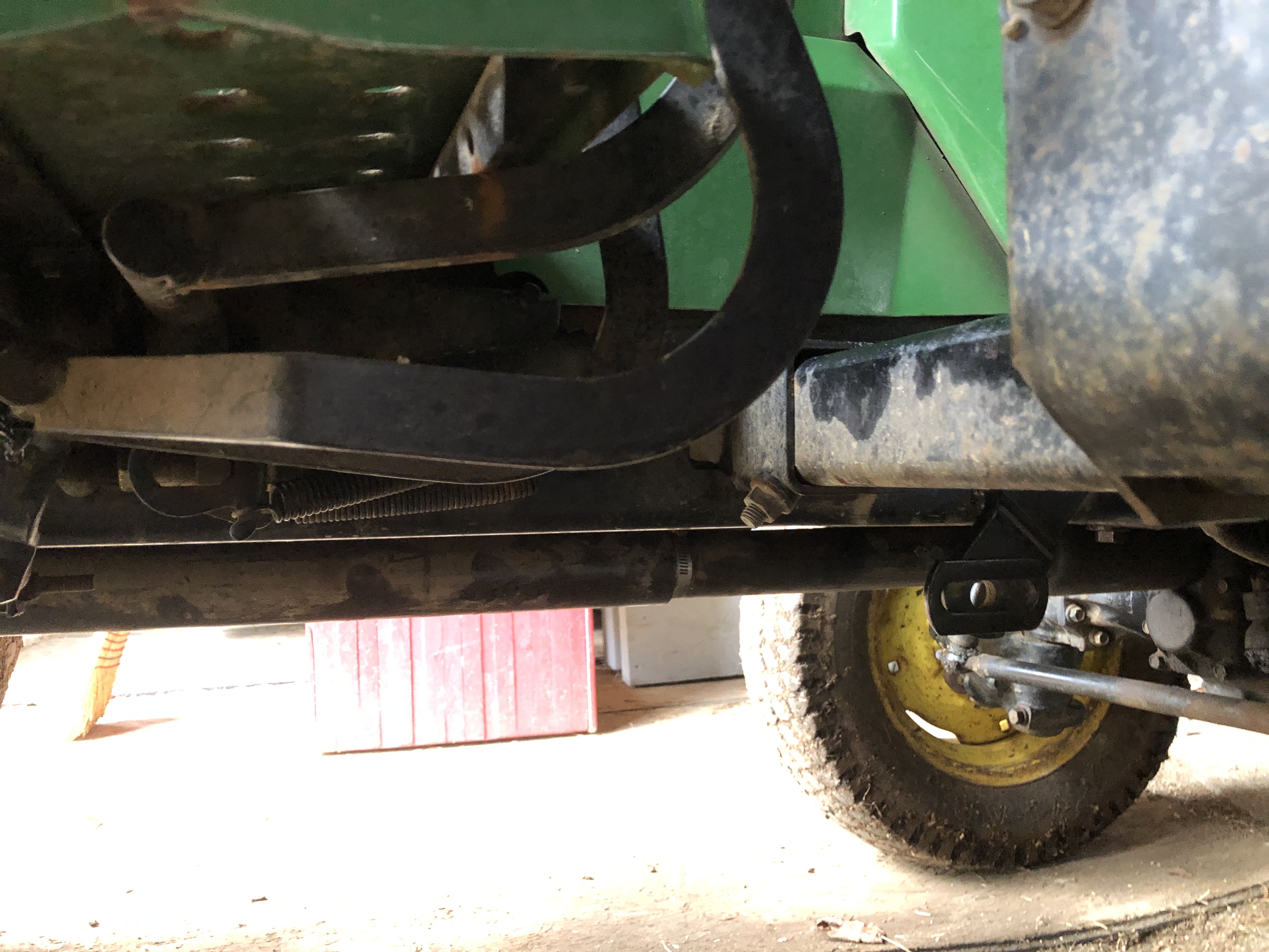

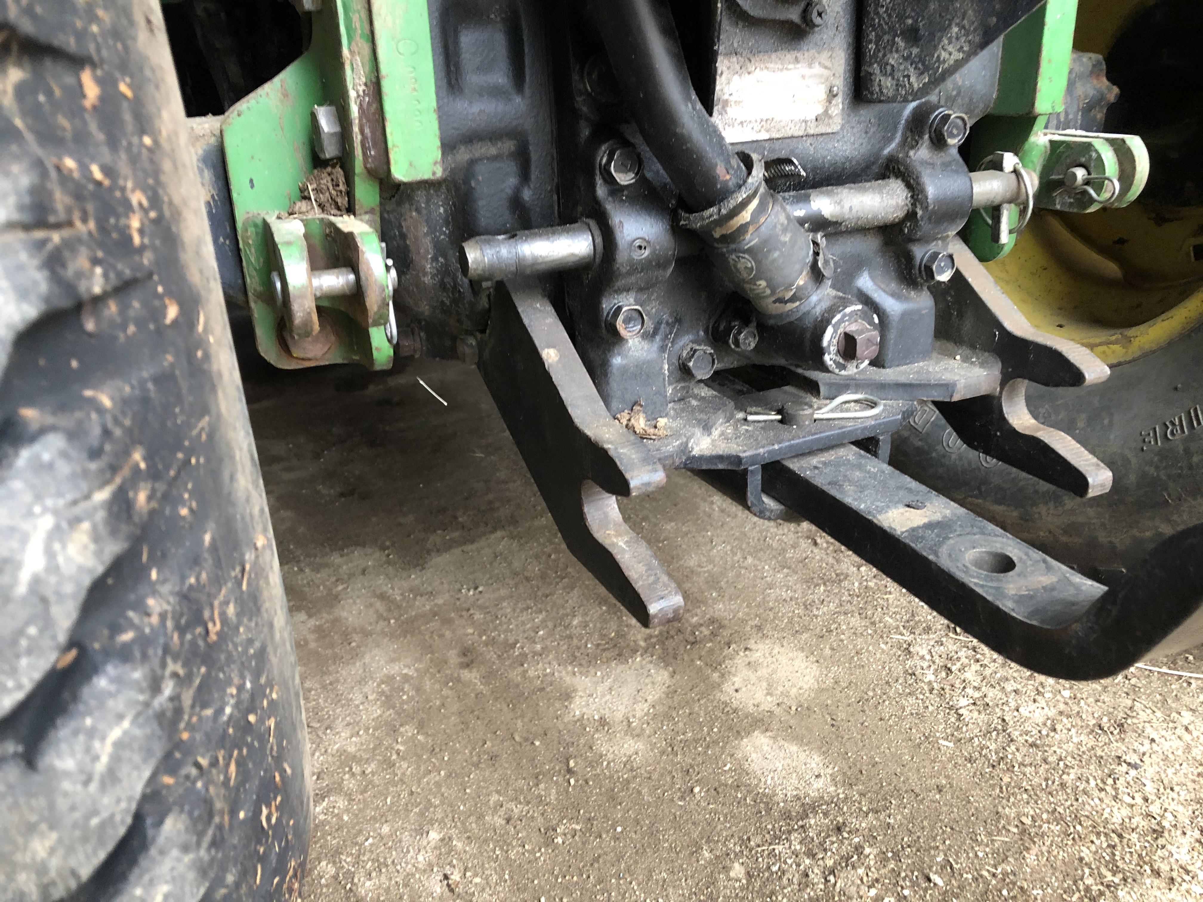

Hi GBB, You are in luck, as I just bought another 955 without the backhoe, so I can directly compare the two. There is a front and rear mounting bracket and tapered pins (2) that hold the forward frame of the backhoe. You will need the power beyond kit that attaches to the hydraulics of your tractor under the seat. I removed the backhoe seat as I find it is just easier to twist around and run the controls from the main seat. Not terribly comfortable, but you will find when trenching that you need to move so often that it's much easier to skip the climbing from the main seat to the backhoe seat and back every 5-10 minutes. Deere should have come up with a swivel main seat there. I will take some pictures of both so you can see the differences. Lastly unless you have some real projects in mind(I have ran 275 feet of electrical power trench and two foundations, plus stump removals and burying two horses with the backhoe) but as an attachment it will sit more than dig, so save yourself the $ and rent whenever you feel the urge to dig. The parts you need will total over $1500; some may be difficult to even obtain. Front Left backhoe mount.JPGPower Beyond hose coupled.JPGPower beyond with hose uncoupled.JPGRear backhoe mount.JPGTop view front right backhoe mount bracket.JPG

Here's the "new" 955 without the mounts or power beyond.IMG_6600.JPGIMG_6588.JPGIMG_6591.JPG

Bear in mind that the 850 single rear mount is a different part number(PT 10466) than the 955 two parts ( AM 104207, 208).
