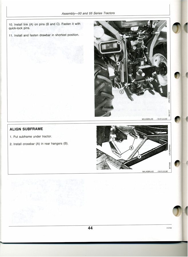

I'm looking for pictures of a JD No.7 backhoe with the subframe for a 955. I'd like to see some picutures of how the backhoe and subframe attach to the tractor. They can be actual pictures or even images from manuals. If you have any, please post them up. Thanks.
/ No. 7 backhoe on a 955 #2
These are some pictures from the No. 7 Backhoe operator manual. Not sure if they provide much of what you are looking for, but would be a start.

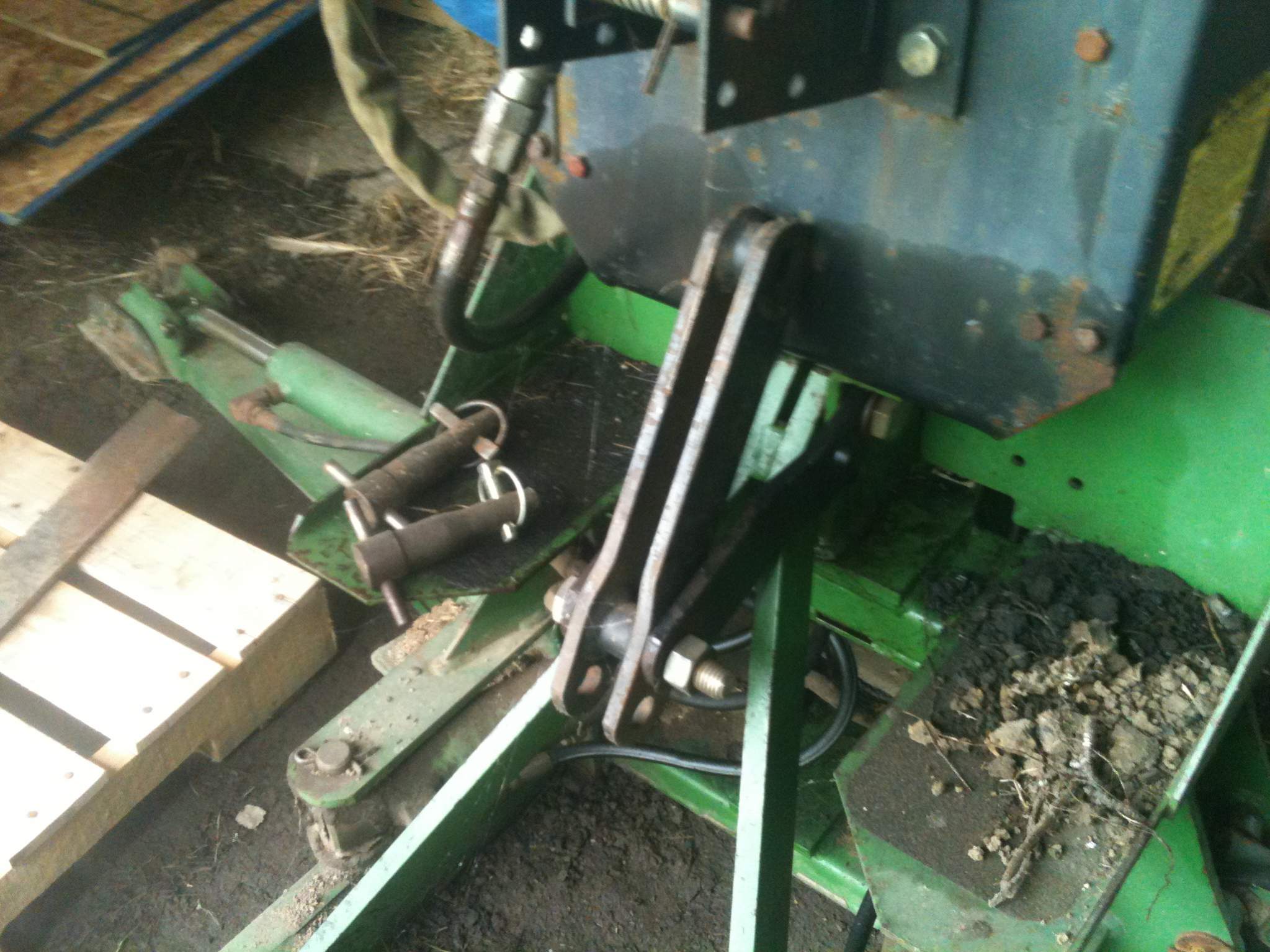

Hi,
I have a 955 with a #7 backhoe if you would like actual pictures. I would not recommend operating the backhoe without the top link connected. Good luck aligning the two midmount tapered pins...it takes some fine adjusting to align them for looseness!
Yes. I would love to see actual pictures.
/ No. 7 backhoe on a 955 #8

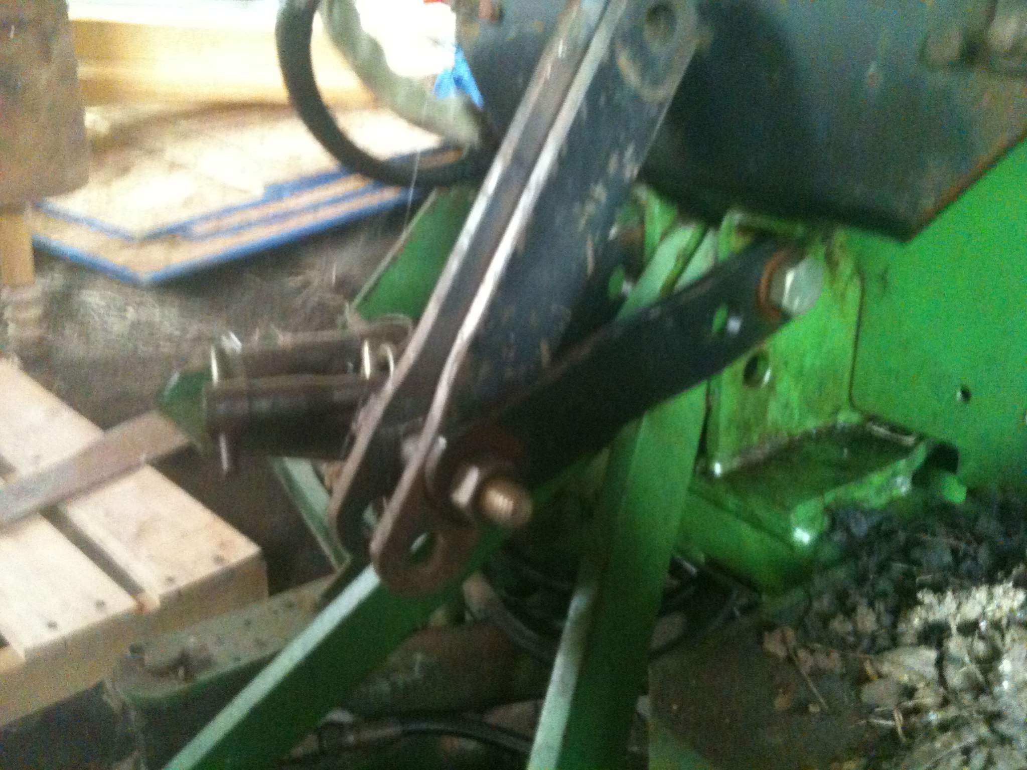

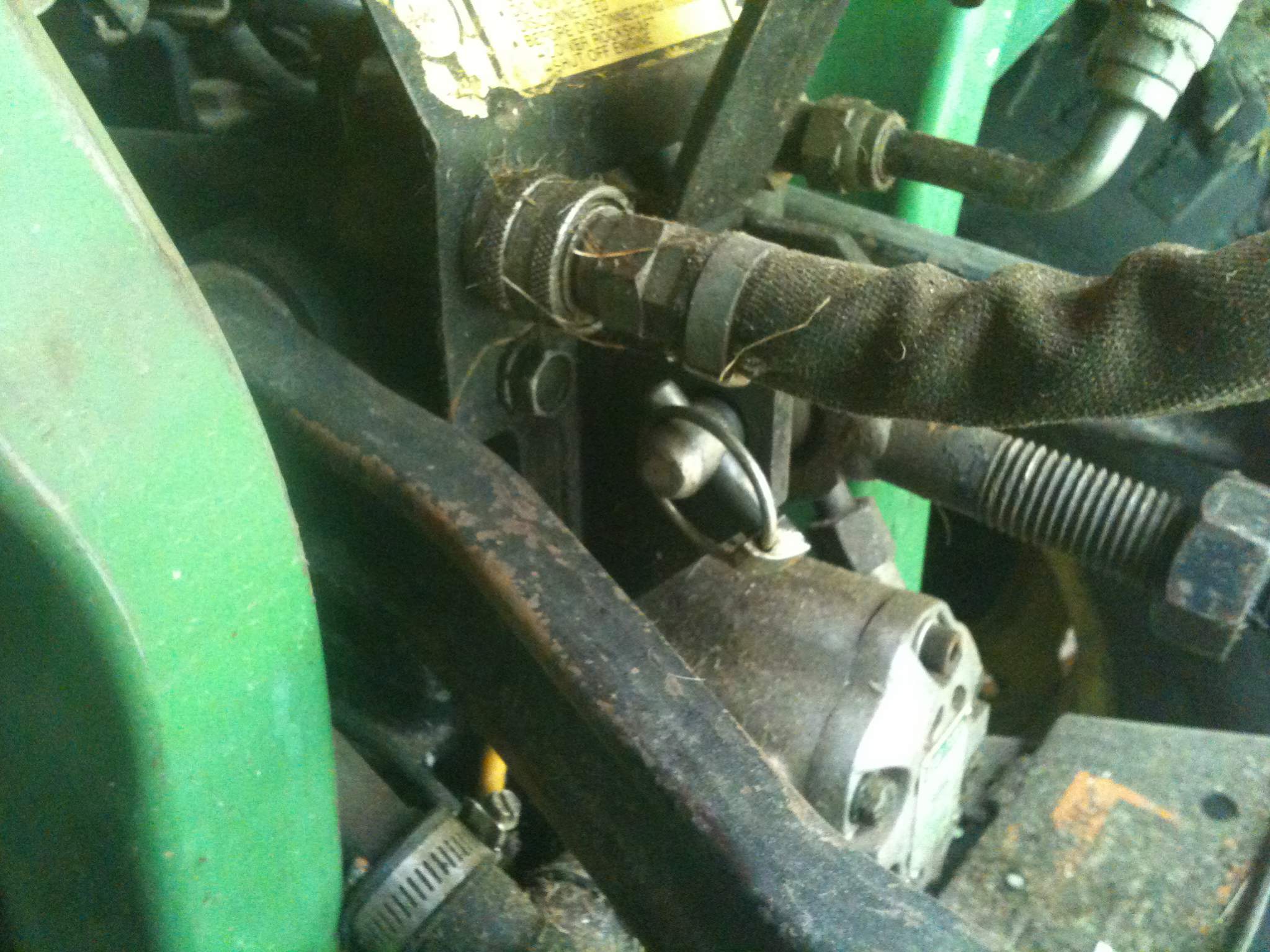

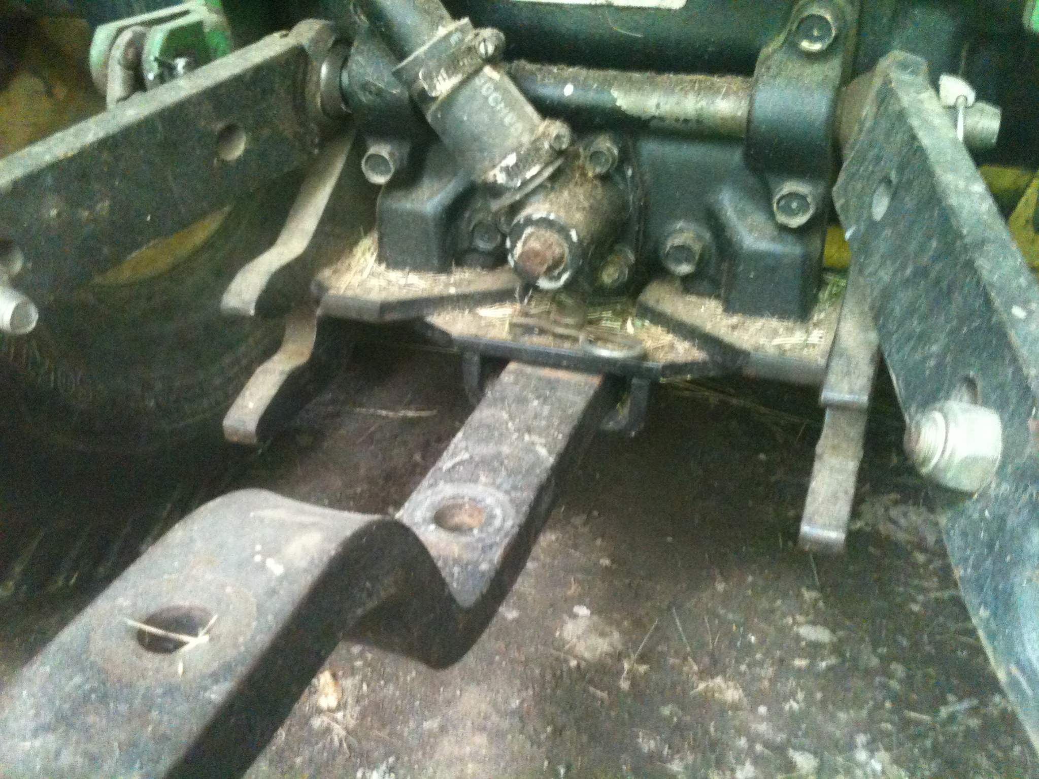

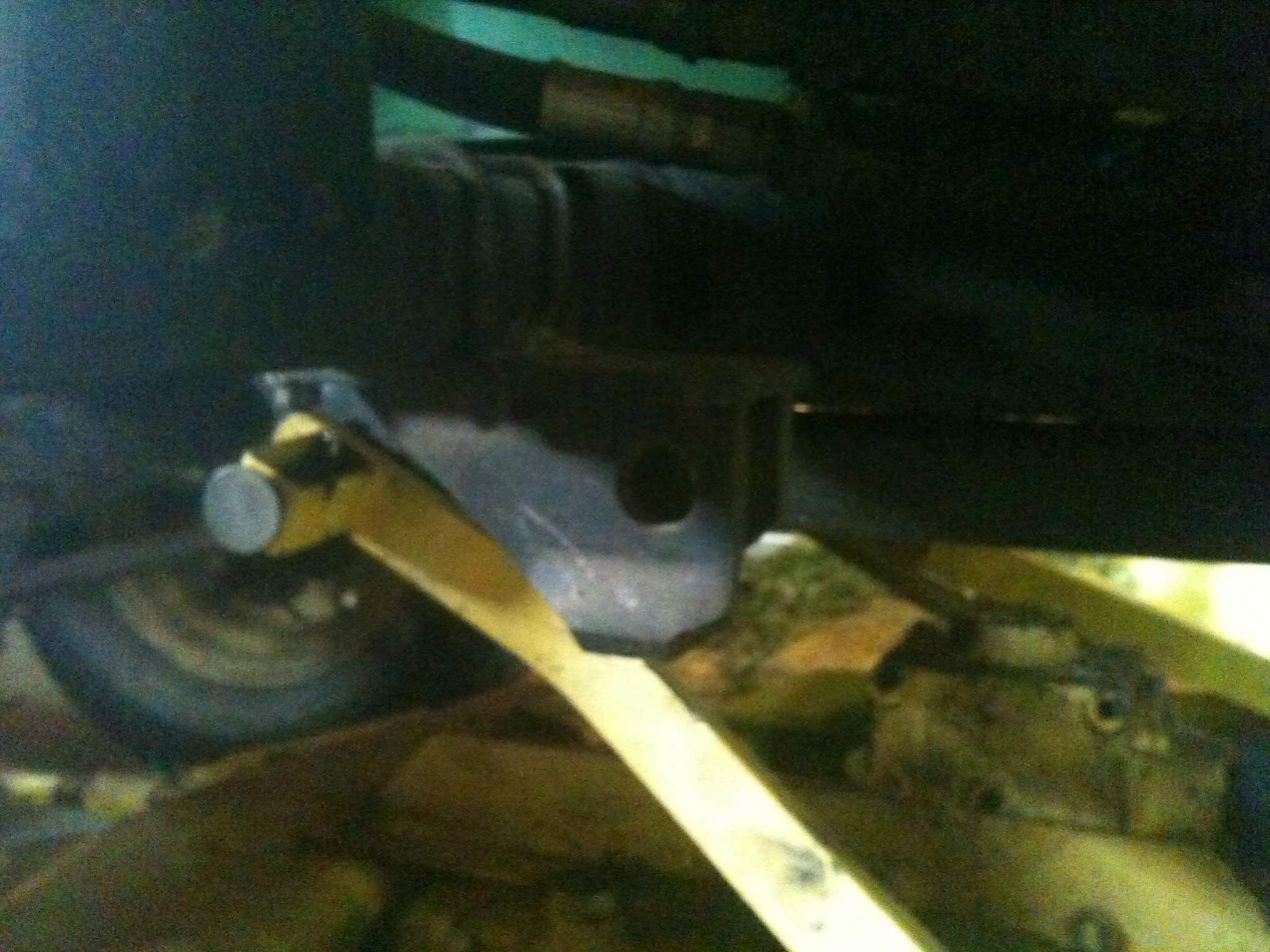

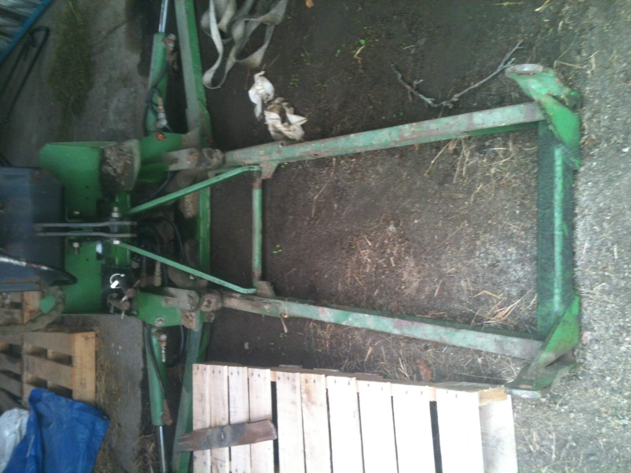

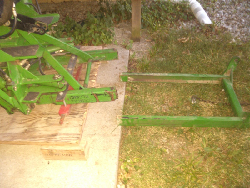

Here's some I just took; as you can see it's currently not attached.
Basically I back up near and square to the backhoe, attach the hoses and lift the backhoe up to align with the rear mount bar. I then reverse snugly into the bar, and fiddle with the bucket height/backhoe feet height until the forward arms of the #7 align with the tapered pin holes. Insert the pins, attach the upper link bar and you are good to go.
402: looking at rear of 955, shows the two open ends where the backhoe bar slots in.
403 dark under shot showing hole where one tapered pin goes.
404 shows where top link connects, same place as the adjustable three point hitch arm.
405 Attachment area of backhoe. Top link folded up.
406 Long rear shot showing forward attachment arms.
407 Top link folded up, also: tapered pins in far footstep.
After this you should close in on specifics as to mount questions.

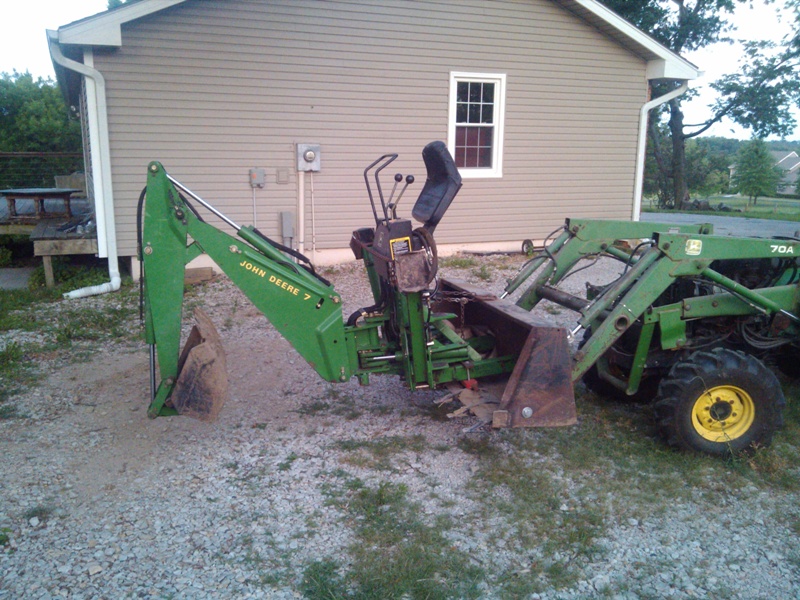

No. 7 fronthoe???
I went to look at a No. 7 I saw advertised on CraigsList tonight. Thanks to all the pics posted here, I was able to identify the subframe and tractor mounts as those for a x55 series tractor... which is what I needed for my 955. I had only planned on looking at it tonight and seeing if I could deal with the seller and if so, come back another day with a trailer to pick it up. Well, it turns out that I was able to work a much better deal than I thought so I figured I'd better get it in case he changed his mind. I ended up leaving there with the hoe in the back of my pickup.
The whole way home I kept wondering just how I was going to get it out of my pickup. Turns out I was able to lift it out of the bed of my truck with the 955 & 70A loader... hence the title of this post.
The fact that this guy had cut the subframe in half in order to convert it to work as a 3pt hoe on his AC tractor and that he was missing the two front hangers allowed me to cut a deal I couldn't pass up.
I got the hoe, both halves of the subframe, the rear hangers and the tapered pins for the front hangers... but the front hangers themselves were MIA. After we got it loaded into my truck and I handed over the cash, he told me that up until today he was certain that Jesse James was dead. LOL. It's definately a buyers market out there right now.
