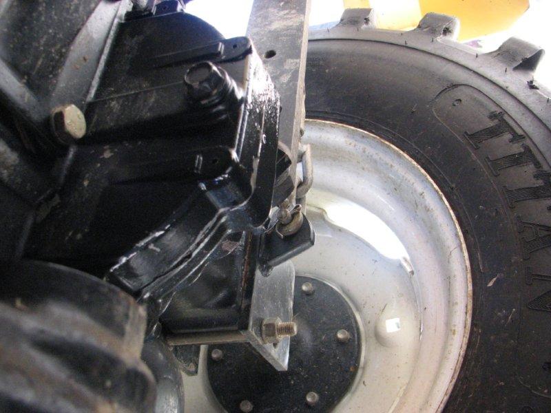

Thanks for your reply's. I gave the NH a closer look today and really liked the Hydro. Only saw one potential issue that has me thinking. There was a little fluid by each of the differential seals / gaskets (two in the back and one up front). Do you think this an issue (big/small) with the number of hours on this tractor or is this common? I am attaching a picture of the back, one side. Other than that it looks and drives well. Any thoughts would be appreciated.

I don't know much about the 790. I bought brand new (still have) a TC24DA in 2004 and have close to 900 (hard) hours on it with a few issues (nothing major in my opinion).
I dont have much time tonight to go into great detail about my experiences with this NH (gotta get some shut-eye, I'm Mr. Mom tommorrow) but if you do a SEARCH FOR POSTS STARTED by me "JSUnlimited" you should get a good idea of the projects, modifications, and repairs involving my NH. I pretty much know this tractor inside and out by now and would I but it again, absolutely!
If I get a chance tommorrow, I'll get back on here and go into detail. I'm sure you need to make a move soon, so I'll try and get back here in the morning. BTW, I would not worry about the oil you see.
