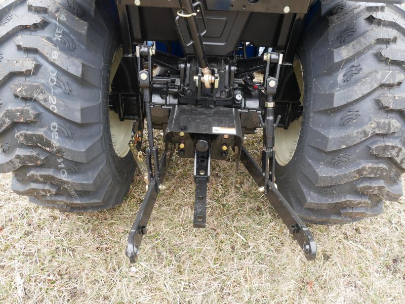

Well, not quite a newby, but not very knowledgeable about welding..... My question is about altering / changing the ends of a hydraulic cylinder for a side link setup. I can find the correct size cylinder as far as bore and stroke, but I cannot find them with the correct ends. I would need to cut off the ends then weld a narrow (7/8"w x 5" long)clevis on the rod end and a cross tube on the cylinder end.

Here is a pic of the 3 point, if you look at the top of the side link, there is a weird swivel type link that the link fits around. The clevis of the link is
1 3/8" Wide, with a 5/8" pin. The cylinder I was looking at has a clevis that is 1 1/4" wide... no big deal, I could grind down the Link swivel, but the pin Hole on the cylinder is 1", so Reducer bushings would be needed on both sides of the cylinder clevis.
It would be difficult to re-make the swivel with a 5/8" pin at the top and a 1" ID tube for the pin on the bottom.
That's why I was just going to cut the top off of the left lift link and reweld it onto the cylinder. If you have any ideas after looking at the pic, please let me know... thanks

I thought about using just a pin through the lift arm, using a cylinder with a ball swivel, but that would put all the stresses on just one side of the arm. Also not knowing if I could even get enough swivel from a ball end on the cylinder. Thoughts?

Question, most adjustable links are on the right, are you putting the hydraulic link on the left so that both have adjustment?
Only situation where I could see it matter is with a plow. Maybe move the adjustable link to the left side and install the hydraulic link on the right side??

As you can see in the picture, the adjustable link is on the right, where the hydraulic will go. The stock left side (non-adjustable) will be sacrificed for the parts.....

Yes, sacrifice the left side for parts. Remove the right side and put it on the left side. That way you have plenty of adjustment to both sides if it is ever needed. My only suggestion to the process is that you could maybe set the cylinder in a tub of water to keep it cool rather than using wet rags, assuming you have an adequate tub depth.
