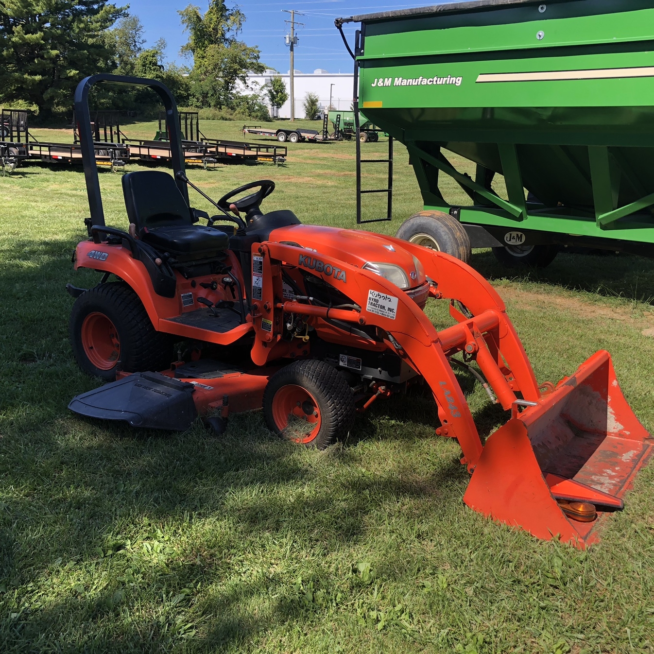

Here’s an example of an older Kubota BX currently for sale at Virginia Tractor in Warrenton, VA. Not sure what they’re asking for it but you could call and find out.
