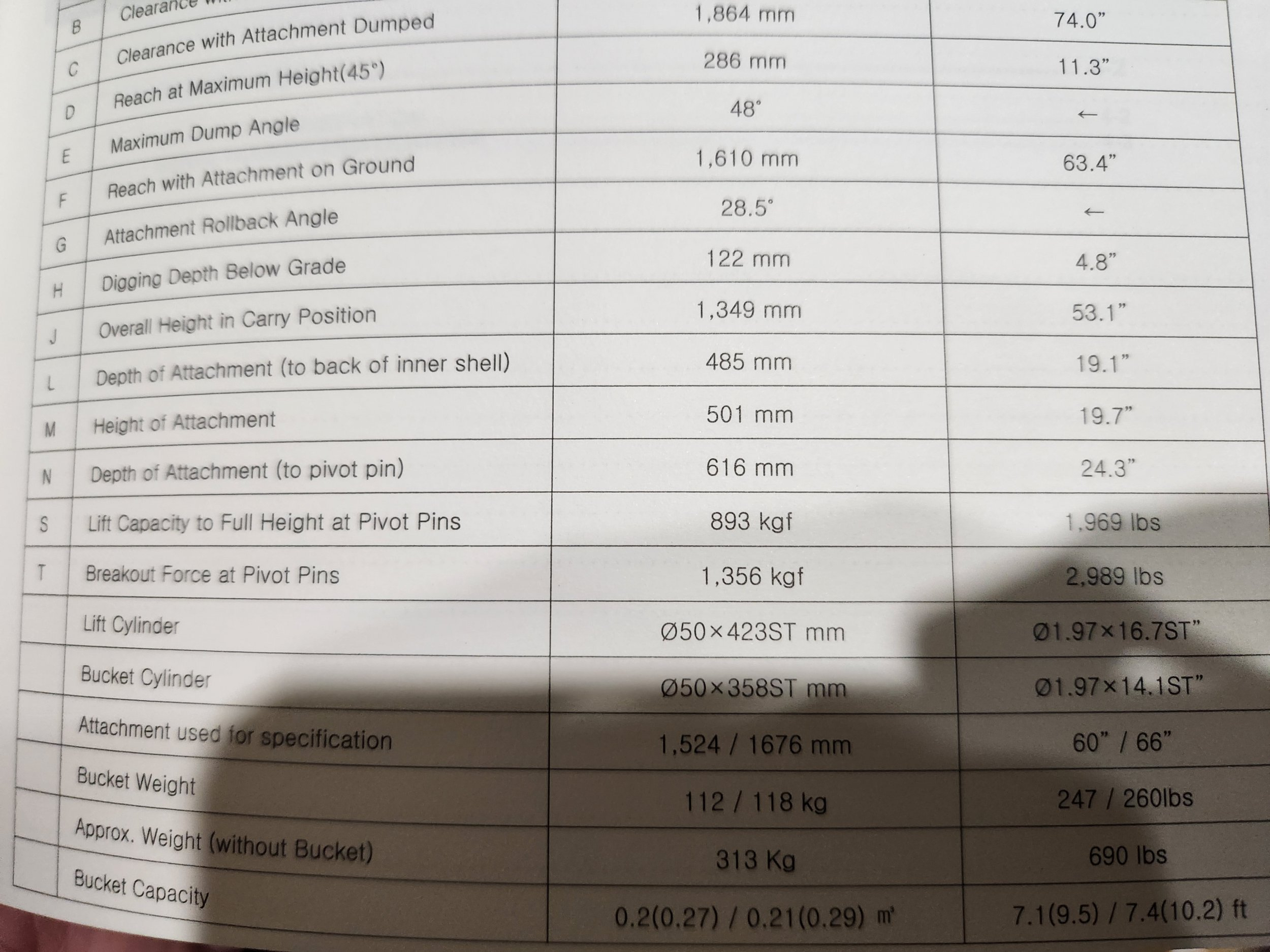

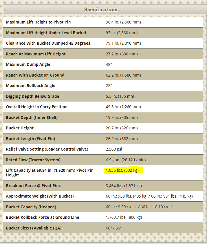

Check the lift specification a little closer. The Bobcat is measured at the lift point to the highest lift point, 1369 LBS @ 95". The KL2610 Kioti loader is 1252 LBS @98.2". Please understand that is at the lift point. When you put a pallet fork on the loader and lift at the middle of the fork it will pick up less, that is true with all loaders.
Are you still seeing KL2610's? I'm seeing the KL4030 and KL4030C on all the CK series these days.
I wouldn't bother with any of the other loader options, assuming they're still available. The KL3040 should have been on them from the start.
