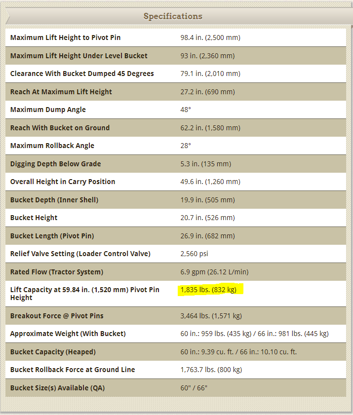

Can you tell me what the lift capacity is to the highest point? Kioti is a little tricky with the lift capacity on the KL4030? All other tractor MFG's give the capacity to the highest point, 98.4".
We not not comparing apples to apples.

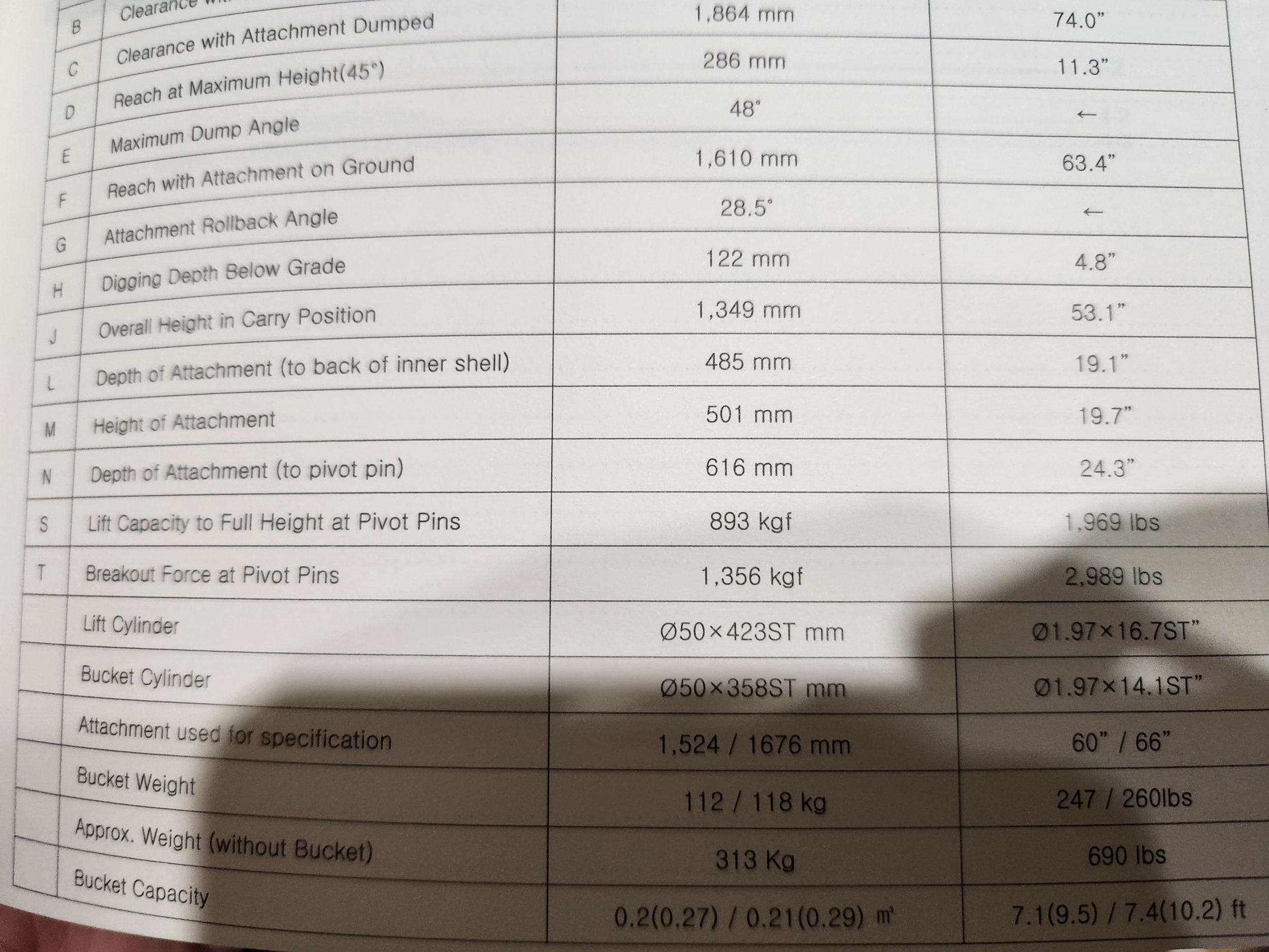

Here is one to flip your lid.
That's the KL4030C manual.
   / Newbie shopping 1st tractor #16
I wonder what the truth is? The geometry does not work that way.
Typically the weight drops as the height increases, so I'm pretty excited about my Kioti's ability to defy physics.
I've not lifted anything heavier than a half-pallet of shingles and my father-in-law, and I don't rightly know how much that was.
I do know that man doesn't weigh more than 200. 🤣
   / Newbie shopping 1st tractor #17
Thinking about it, I don't rightly know if I'd want to move almost 2k pounds at full height. Even well ballasted I can't help but feel that's asking for trouble.
