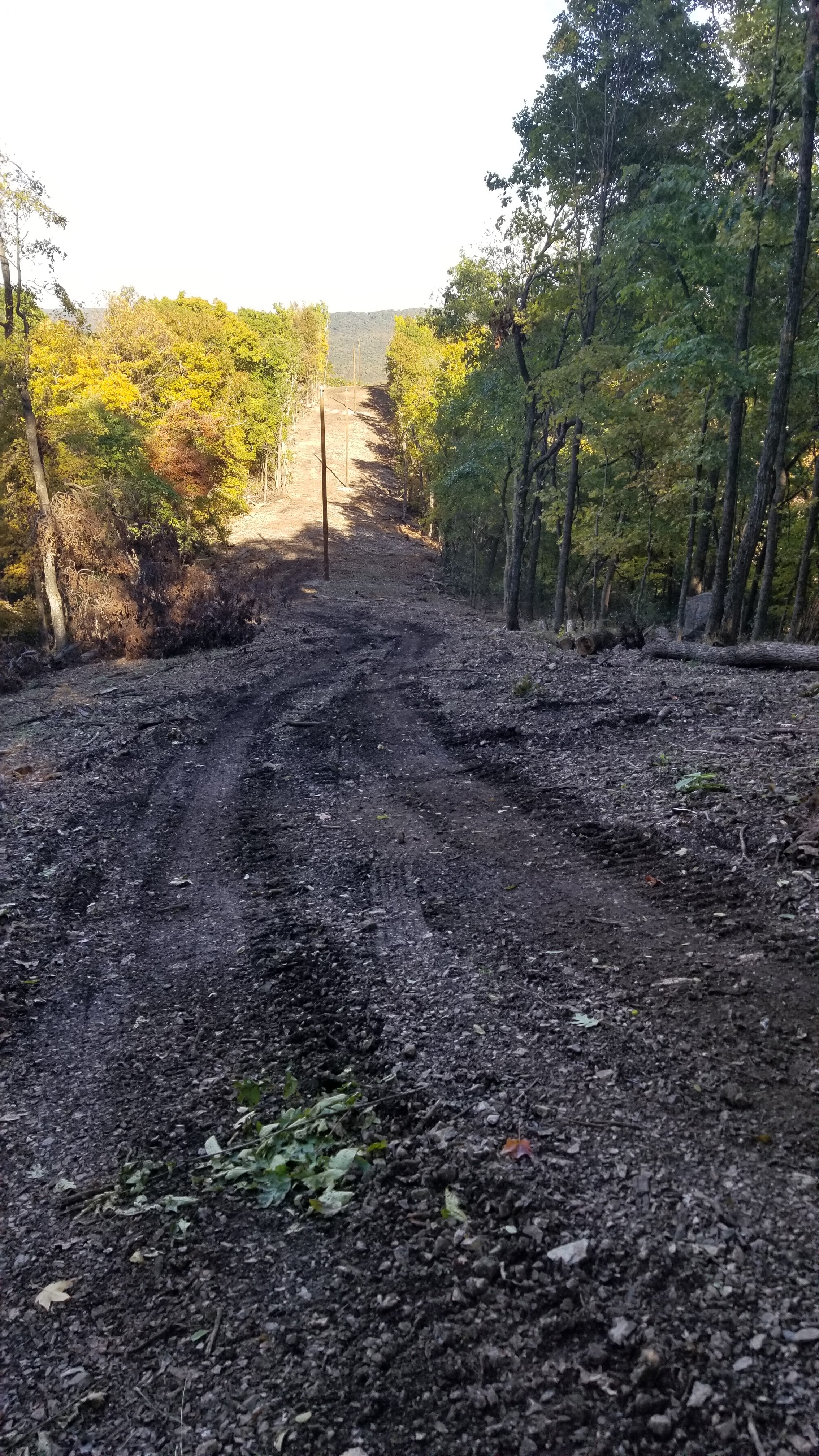

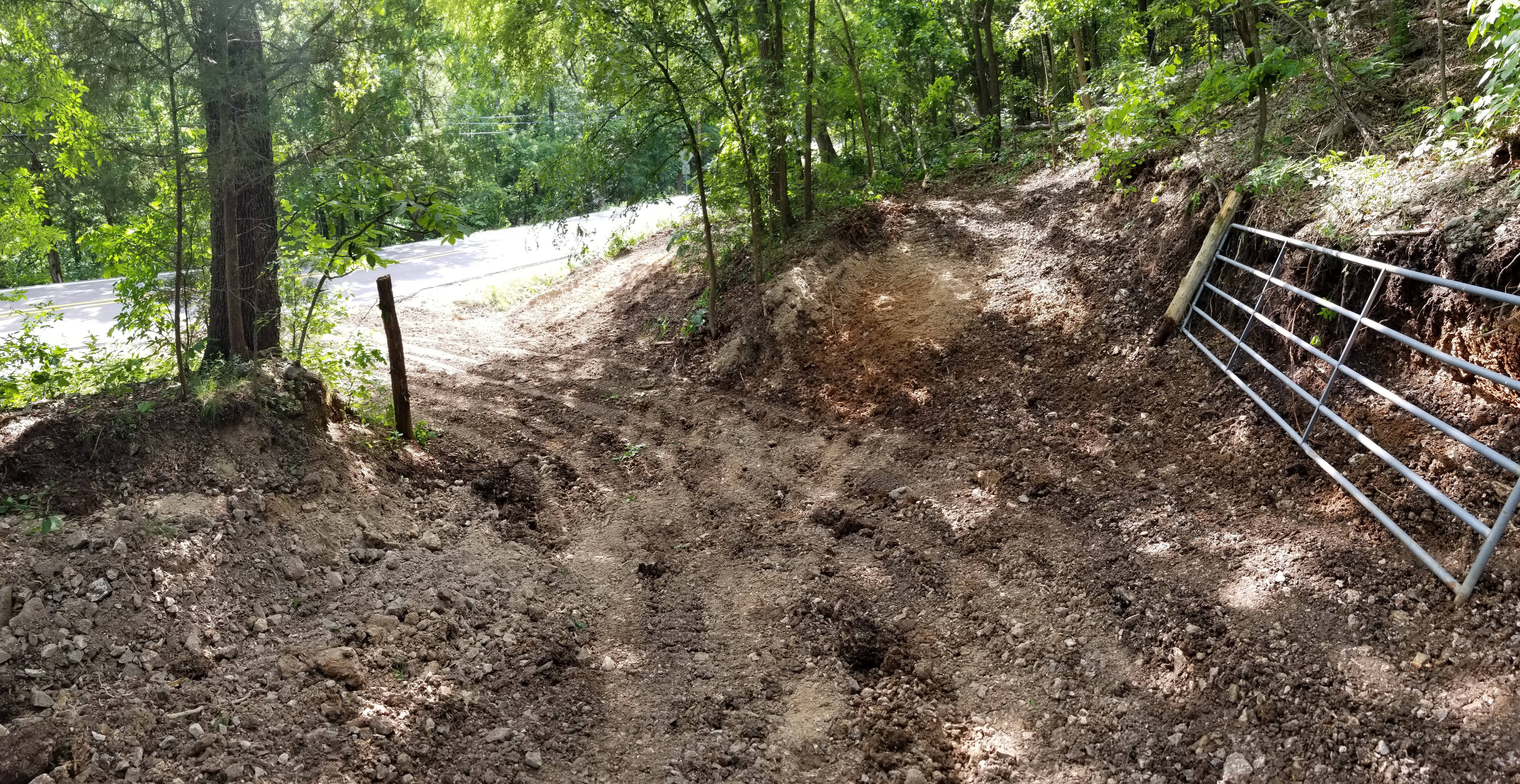

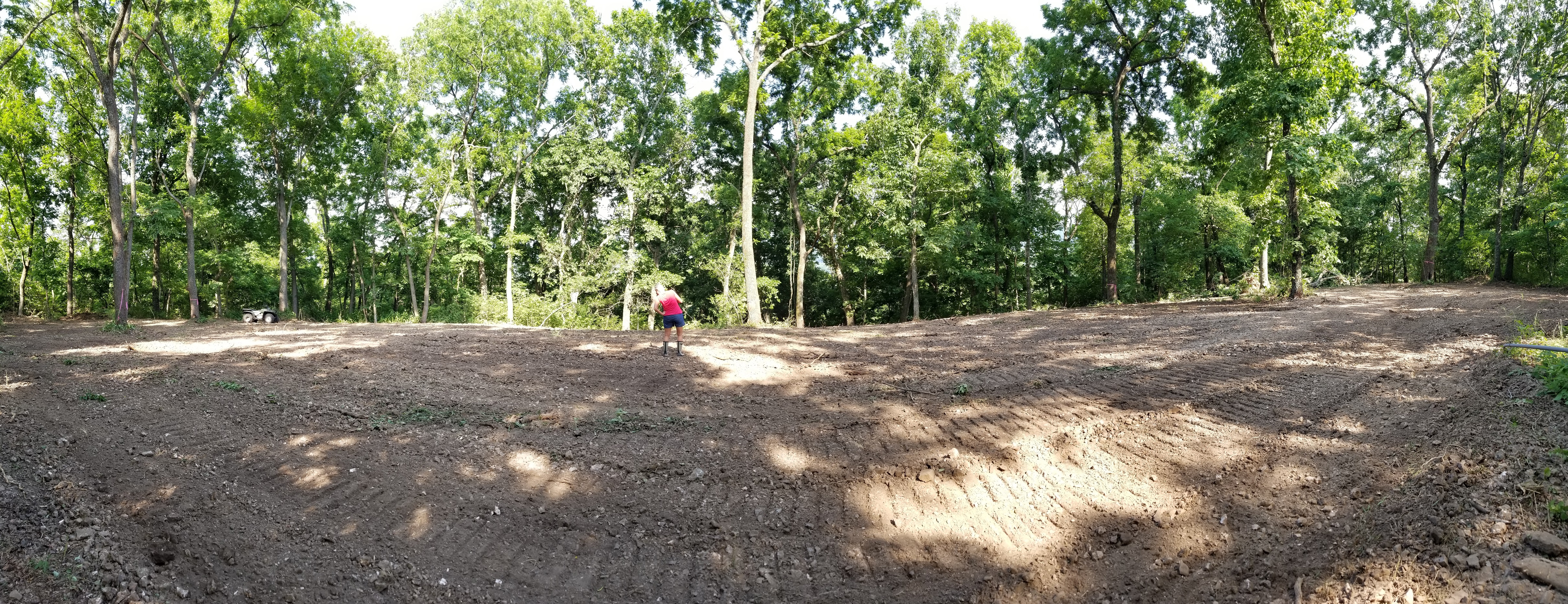

New to the site... First Post... So, Hello, I'm Paul. Building a house in Arkansas... see pics below. Glad to be on here and get your opinions.
I've read through tons of posts on here and other sites and have narrowed my choice down to a Kubota MX5800. With that, I plan on getting the R4 tires filled, 3rd Func for Grapple, 60" EA root Grapple, Land Pride BB35 Box Blade, RB37 Rear Blade and a Cat2 Quick Hitch. Might get a stump bucket... need advice on that too.

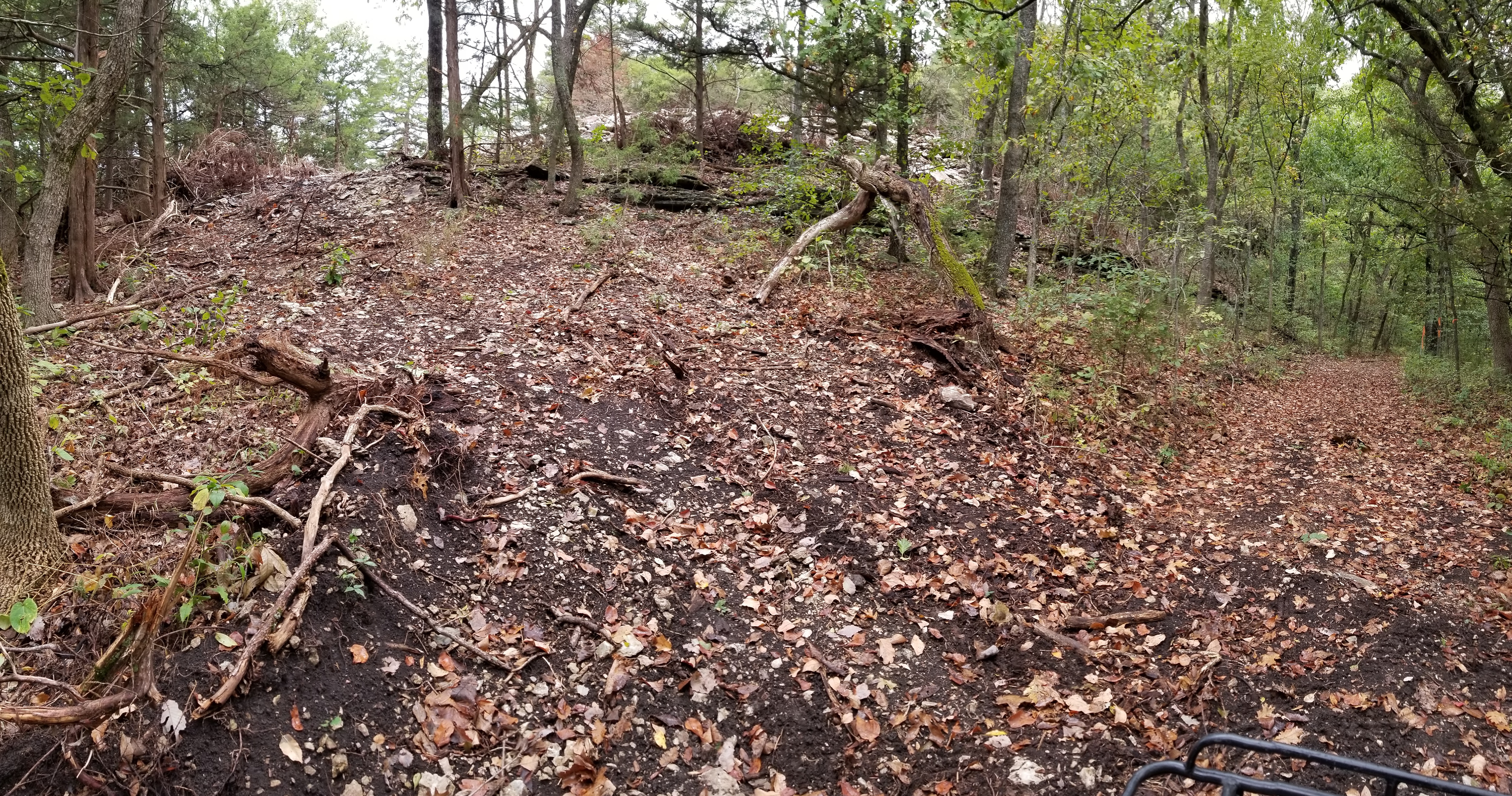

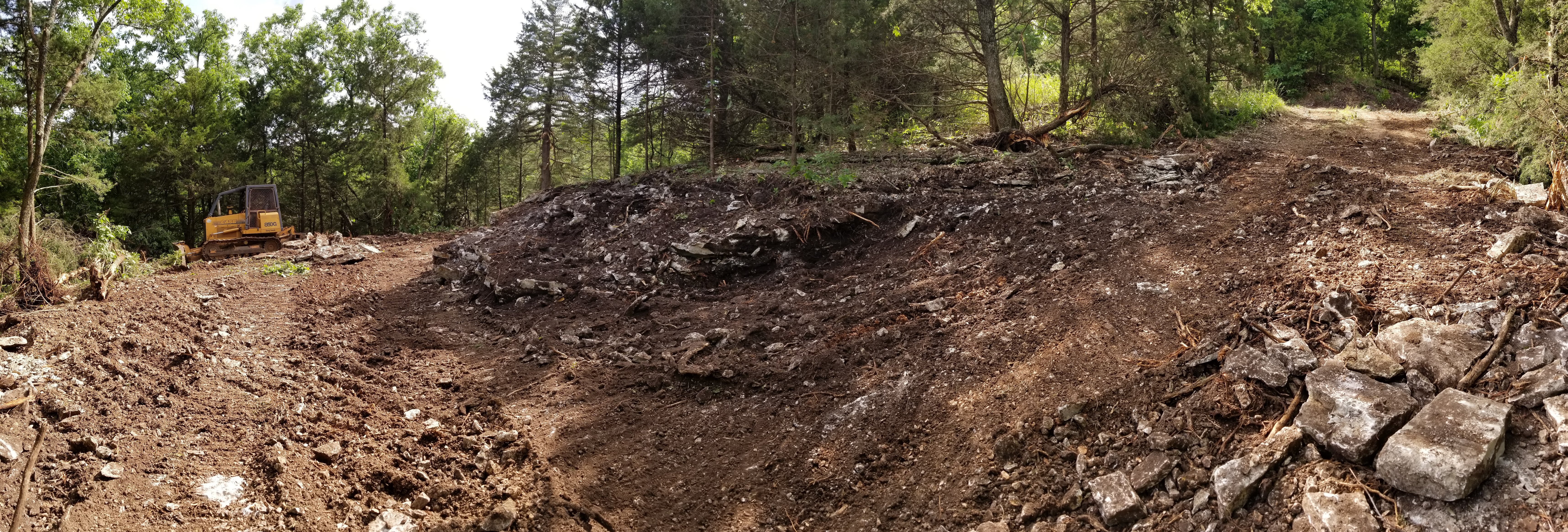

I'll attach some pics of the property... 24 acres, mostly wooded and sloped. My driveway is a 15 degree grade at 1000 feet long, it will be asphalt, but I have a lower road that's probably a couple thousand feet long that I want to whip into shape. Lot of stumps to deal with. Lot of Dirt that needs to be moved around. Very little grass or brush to cut. That lower road will need a trench for rain runoff, thus the need for the rear blade with some tilt. The terrain is very rocky. Thus why I'm going with the heavier duty cat2 items LP has to offer.
The 'connectingroad' pic... that's where I need to make a connecting road from the main driveway to the lower road you see to the right. Lots of hauling material and moving the trees to the left of that pic.
Truly value the opinions of this group. You can't hurt my feelings! Lol... have a good one guys!

Totally agree on the grapple... there are a lot of large flat rocks I want to pick up and move to the build site. The grapple is for that and dealing with trees. I plan on renting an excavator at some time to deal with some trees/stumps and leveling out some points of that unimproved lower road.
