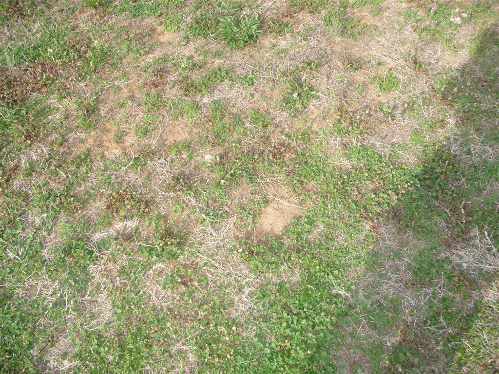

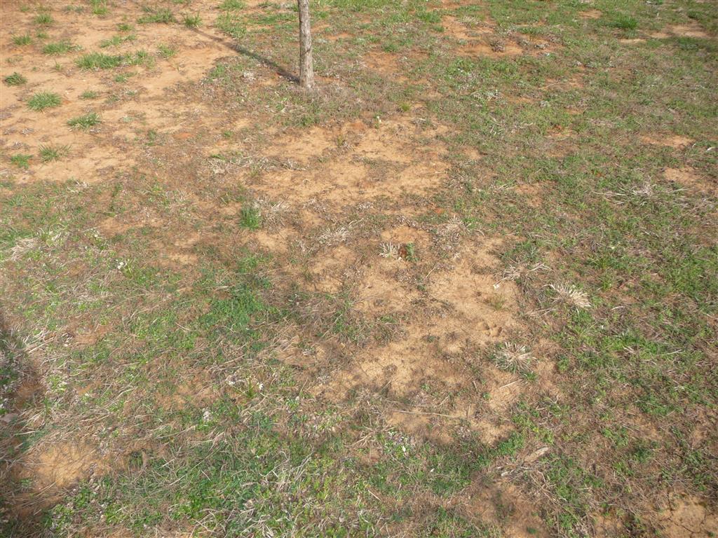

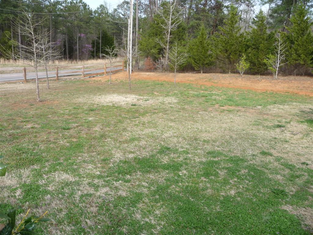

Hi Everyone
Well another year has gone by and my yard still looks like crap so its time to get serious about fixing this mess. Question is where to start.
Problem #1 is weed control of which I have 1) Hinbit 2) Clover 3) Broadleaf 4) Onion throughout most of the 2.5 AC yard area.
Problem # 2 is a 4000 sq ft problem area that pretty much nothing grows in except the hearty weeds. This area is hard Alabama Red Dirt of which I'm guessing has little to no top soil. See Pictures
Equipment I own
1) JD X495 Mower
2) JD 870 w/ FEL
3) 3pt 40 gal sprayer
4) 5' Disk
5) 5' Tiller
6) 5' Rock Rake
7) 5' Box Blade
Any ideas on how to start approaching this would be a great help. I'm OK with re-sodding the 4000 sq ft bad area but need it to grow and not just die off. I did a soil test in that area and everything was good except adding 1000 lbs of lime per acre.
Thanks Dennis

First thing I would do is determine the true makeup of your soil, an over abundance of magnesium can cause the compactness of your soil and you may be surprised at how little clay you actually have. To give you better advice you need to do a soil test to determine the ratios you have. Here's a link to a soil hydrometer test you can do at home.

Ye gads, you do have some clay!
First thing you should do is kill everything you have with roundup. The next step is to bring in enough mulch or topsoil to cover the area you want seeded. Mulch takes a while to work but topsoil gets you planting seed sooner. Your wallet and time will determine which way you go.
Some people recommend tilling the top couple of inches, it's been my experience that this brings up more dormant seed and causes a whole new crop of problems. The idea behind tilling is that your yard over time acts the same way as your jar test, silt and clay settles on the top, tamping off oxygen to the roots.
In your situation, mixing the top 3-4 inches of your predominately clay soil will aerate the soil for sure and allow grass to quickly grow. But the weed seed you expose will soon out-compete the grass and you will get the same tamping off as your soil compacts itself.
After roundup I would LIGHTLY rake to remove all trash. Apply topsoil, seed with a tall fescue or Bermuda grass, cover with straw and water generously. Both those types of seed do well in clay soil.
I would retest your soil in a couple of months after the grass was growing because the new topsoil you bring in will change the nutient requirements and fertilize accordingly.

I have similar soil and find that adding organic matter, lots of lime and fertilizer makes for a good lawn/garden. My soil has little to no organic matter so that is the main ingredient needed besides the lime and fertilizer. I would first kill every thing in the yard, then put out the recommended lime and till it in. Let is set for a rain or two then fertilize it as recommended and then spread out the rich in organic matter top soil and till it all in well. Then reseed and harrow it to get it good and level/smooth.
/ New Year Same Yard Problems. HELP!!! #10
You need to kill all you have, order 1350 cy of topsoil, spread, fertilize, lime, seed and WATER.
