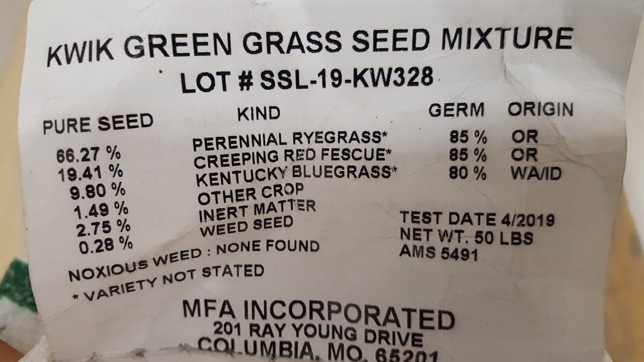

I seeded around an acre for my new house project last Fall. I used a mix called "Quick Green" that I got from a local supplier. I expect a lush yard next Summer. I paid $2 p/lb. I don't think I could pay $30 p/lb.
